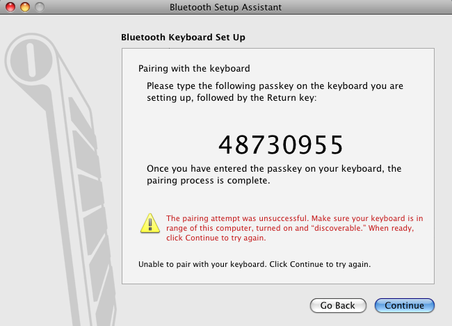

xtreme Posted October 14, 2008 Share Posted October 14, 2008 Hi guys. 2 days ago i bought new Aluminum Wireless Keyboard from Apple..... i has one apple macbook white, two hackintosh. [Hackintosh] One as media center the second one for business use. i try to pair that tiny device to my Media Center Hackintosh with no success then i read tons of threads and found here the thread about the Firmware 1.0 i pair the keyboard to my MacBook and did the update of keyboard. Try to connect to Hackintosh again with no success. But it works with any MacBook. Anyone can do it with hackintosh or not. I NEED HELP. Configuration : Bluetooth : MacAlly BT10 iDeneb Mac OS X 10.5.4 (Build 9E17) Motherboard : Gigabyte Technology Co., Ltd. P35-S3 x.x Processor Intel® Core2 Quad CPU Q6600 @ 2.40GHz Memory 4.00 GB HDD System : WDC WD740ADFD-00NLR1 (75GB Raptor) HDD : ST3500320NS, ST3500320NS, ST31000340AS, ST31000340AS (3TB) Video : NVinject 0.2.1 - 128 MB Please i need help. I really like these keyboards. Thanks. Link to comment Share on other sites More sharing options...
xtreme Posted October 16, 2008 Author Share Posted October 16, 2008 The problem solved. i just replace the mcally bt10 to other McAlly BT10 changed to SomeChineseNONAME BT100 and its work. I think problem is Bluetooth dongle must be 2.0 not 1.2 Link to comment Share on other sites More sharing options...
