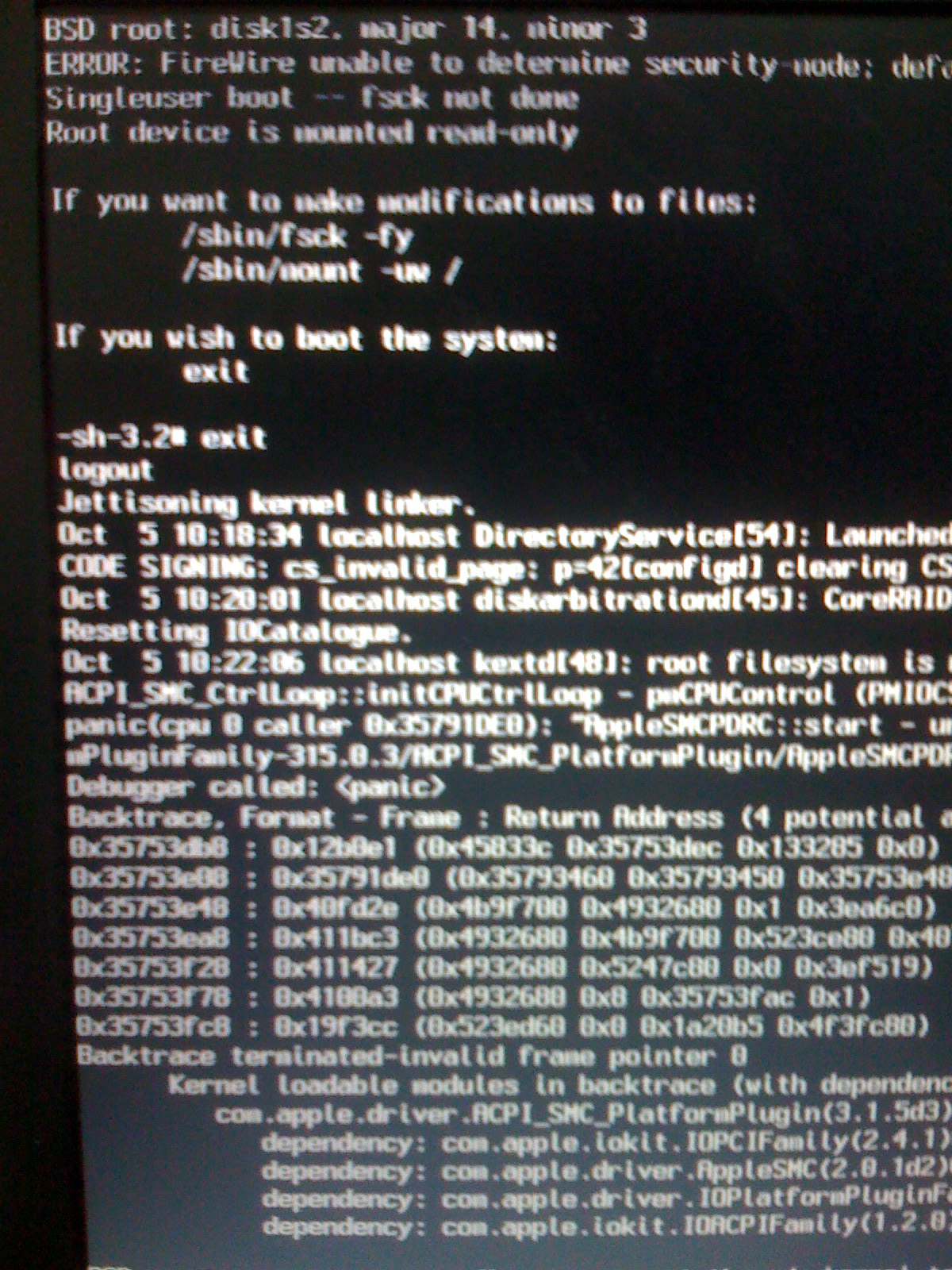

bedo Posted October 5, 2008 Share Posted October 5, 2008 i tried to install kalyway 10.5.2 on my toshiba tecra S3 laptop but the kernel paniced. Processor : Pentium M 2.0Ghz (supports SSE2) MB : Intel 915PM Graphics : Nvidia 6600 PCI-E 128MB RAM : 2GB HDD : Seagate 250GB SATA Here is the Screenshot Any ideas??? Link to comment https://www.insanelymac.com/forum/topic/129707-kalyway-1052-kernel-panic/ Share on other sites More sharing options...
WauloK Posted October 6, 2008 Share Posted October 6, 2008 Looks a bit similar to an issue I had. You could try turning ACPI off in the BIOS. Link to comment https://www.insanelymac.com/forum/topic/129707-kalyway-1052-kernel-panic/#findComment-919309 Share on other sites More sharing options...
bitninja Posted October 6, 2008 Share Posted October 6, 2008 I didn't try that, but what worked for me (FINALLY just now got the Kaly 10.5.2 DVD to boot) was mounting the ISO and doing this: sudo rm -fR /Volumes/Kalyway\ 10.5.2\ DVD\ Intel_Amd/System/Library/Extensions/IOPlatformPluginFamily.kext/Contents/PlugIns/ACPI_SMC_PlatformPlugin.kext/ sudo rm -fR /Volumes/Kalyway\ 10.5.2\ DVD\ Intel_Amd/System/Library/Extensions.mkext If you don't have another Mac, simply mount or edit the ISO in some program like UltraISO and remove the files System/Library/Extensions/IOPlatformPluginFamily.kext/Contents/PlugIns/ACPI_SMC_PlatformPlugin.kext/ System/Library/Extensions.mkext Reburn and boot with -v -f -x. That should work. Link to comment https://www.insanelymac.com/forum/topic/129707-kalyway-1052-kernel-panic/#findComment-919600 Share on other sites More sharing options...
bedo Posted October 10, 2008 Author Share Posted October 10, 2008 I didn't try that, but what worked for me (FINALLY just now got the Kaly 10.5.2 DVD to boot) was mounting the ISO and doing this: sudo rm -fR /Volumes/Kalyway\ 10.5.2\ DVD\ Intel_Amd/System/Library/Extensions/IOPlatformPluginFamily.kext/Contents/PlugIns/ACPI_SMC_PlatformPlugin.kext/ sudo rm -fR /Volumes/Kalyway\ 10.5.2\ DVD\ Intel_Amd/System/Library/Extensions.mkext If you don't have another Mac, simply mount or edit the ISO in some program like UltraISO and remove the files System/Library/Extensions/IOPlatformPluginFamily.kext/Contents/PlugIns/ACPI_SMC_PlatformPlugin.kext/ System/Library/Extensions.mkext Reburn and boot with -v -f -x. That should work. UltraISO and MagicISO can't burn or create/edit hybrid DVD's, After some searching I found Transmac worked like a charm. Burned and installed OS X without problem. Now having some trouble with MAC drivers for network devices, will solve it soon Thanks for the tip Link to comment https://www.insanelymac.com/forum/topic/129707-kalyway-1052-kernel-panic/#findComment-924929 Share on other sites More sharing options...
