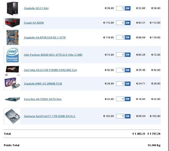

2/ No problem with a E5200 on a EP35-DS4 with Corsair XMS2 Kit 2x1GB PC6400 DDR2-800 CL4 (TWIN2X2048-6400C4) ? Probably working on Snow Leopard too (for the future) ?
CONFIG FOR SERVER (MAC OS SERVER), see all configuration in the attached file (PS : I already have an Hitachi HDD).
==> RAM is changed since the screenshot : Corsair now, Geil before.

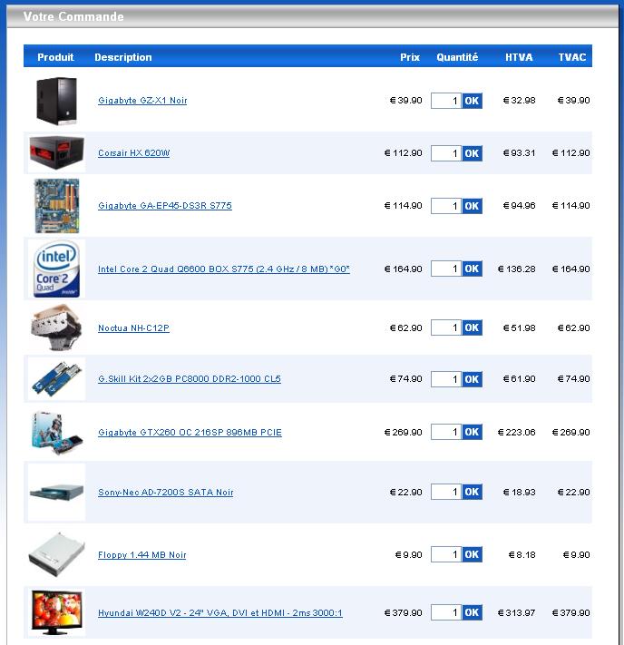

3/ No problem with a Q6600 on a EP45-DS3R with G.Skill Kit 2x2GB PC8000 DDR2-1000 CL5 (F2-8000CL5D-4GBPQ) ? Probably working on Snow Leopard too (for the future) ?
CONFIG FOR WORKSTATION (MAC OS), see all configuration in the attached file (PS : I already have an Hitachi HDD, the Samsung 1To HDD added is for extra storage only, GTX260 only VESA 3.0 1680x1050 until Snow Leopard probably supports this one).
