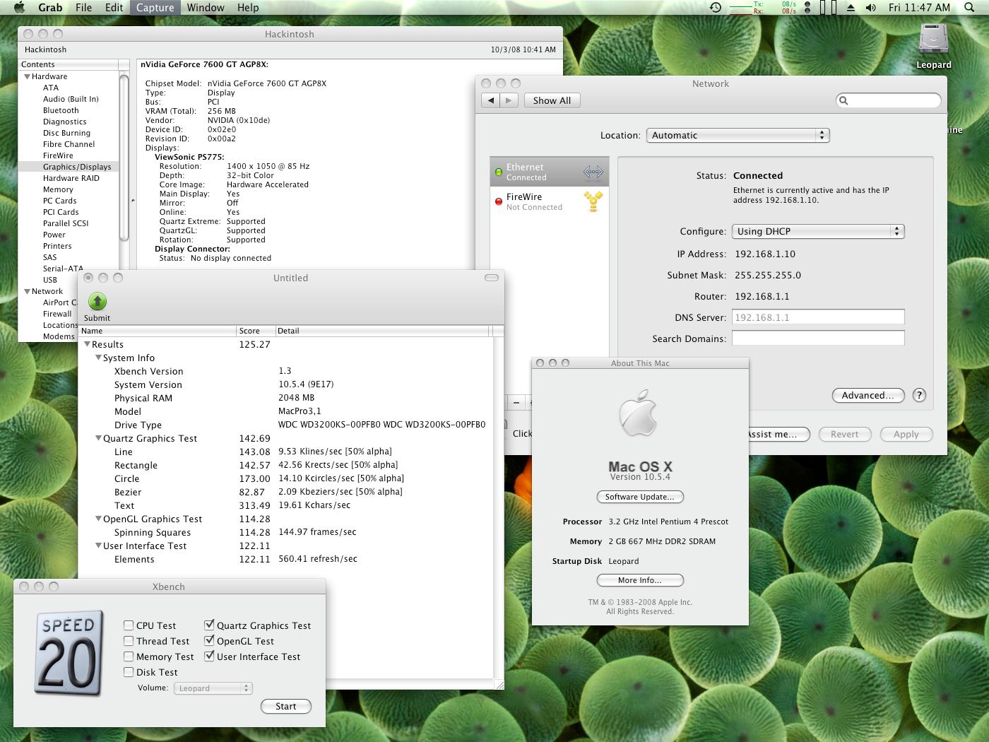

If you are like me, you may not want iDeneb logo in About This Mac, but to replace it with a photo of your dog/cat/iguana/whathaveu. You can prepare a TIF image file and replace the standard logo by using OSx86Tools. Use OSx86Tools to replace the CPU string with the proper name: Intel Pentium 4 Prescot.

I'm using Natit_edited.kext, attached zip. Please unzip and use OSx86Tools to install the Natit.kext.
Do not reboot.
Run the task "Set Extensions permissions" in OSx86Tools.
Open terminal (can be found in Finder>Application>Utilities), be root
$sudo su
Remove unwanted kext
#cd /System/Library/Extensions
#rm -r NVDANV10Hal.kext
#rm -r NVDANV20Hal.kext
#rm -r NVDANV30Hal.kext
#rm -r NVDANV50Hal.kext
Modify (nano)
Matching device (IOPCIMatch) set to only contain 0x02e010de (nVidia 7600GT AGP)
Press ^W (Control W) to use the search function, search for IOPCIMatch
Press ^O (Control O) to write/save, ^X to exit
#nano GeForce.kext/Contents/Info.plist
#nano NVDANV40Hal.kext/Contents/Info.plist
#nano NVDAResman.kext/Contents/Info.plist
You can skip the following step. As this is just for on-screen cosmetic, as I like to see proper video card name.
Modify (nano)
Add in device 0x02E0 string = nVidia 7600 GT AGP8X under 10de device
Use Search as the Natit.kext is very long.
#nano Natits.kext/Contents/Info.plist

Hopefully your new hackintosh booted with QE/QGL fully working.
