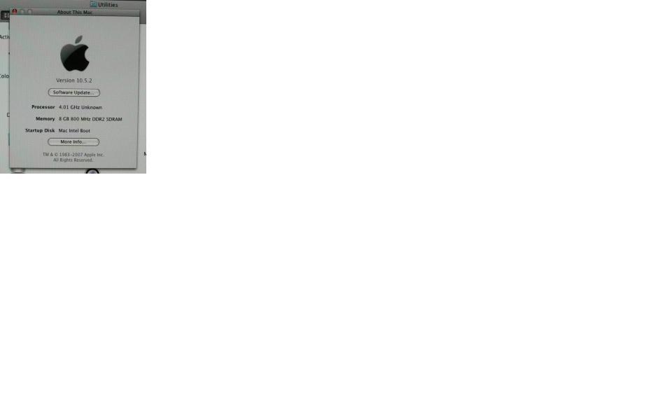

Joe 90 Posted September 19, 2008 Share Posted September 19, 2008 I just assembled a P5K-VM and E5200, with 4x2GB DDR800 Memory dimms. Kalyway 10.5.2 had me up and running in 20 minutes or so, just put the CD in and booted. The board doesn't seem to like running much more than 333 FSB. I have been booting and surfing at 4.0GHz (see pic), but will probably bring it down to 3.8GHz 320*12, to give everything a bit more slack. No proper GMA 3100 driver yet, so I am stuck with 1024x768. As this is a relatively new processor, and under $100, just wanted to let you know it works fine, and say thanks. J [Edit: Now running at 3.8GHz, & full system drawing 69w from the mains power meter, inc 3.5 hdd.] Link to comment https://www.insanelymac.com/forum/topic/126934-e5200-dual-core-working-fine-on-p5k-vm/ Share on other sites More sharing options...
Lloyd Owen Posted December 29, 2009 Share Posted December 29, 2009 I just assembled a P5K-VM and E5200, with 4x2GB DDR800 Memory dimms.Kalyway 10.5.2 had me up and running in 20 minutes or so, just put the CD in and booted. The board doesn't seem to like running much more than 333 FSB. I have been booting and surfing at 4.0GHz (see pic), but will probably bring it down to 3.8GHz 320*12, to give everything a bit more slack. No proper GMA 3100 driver yet, so I am stuck with 1024x768. As this is a relatively new processor, and under $100, just wanted to let you know it works fine, and say thanks. J [Edit: Now running at 3.8GHz, & full system drawing 69w from the mains power meter, inc 3.5 hdd.] what kernel did you use? Link to comment https://www.insanelymac.com/forum/topic/126934-e5200-dual-core-working-fine-on-p5k-vm/#findComment-1371344 Share on other sites More sharing options...
