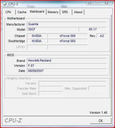

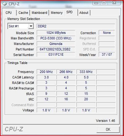

toledoj Posted August 22, 2008 Share Posted August 22, 2008 Hey everyone, I'm basically a noob at this stuff so far. I have the Jas 10.4.8 SSE2 and SSE3 Intel/AMD iso. It booted up fine and everything, but when i came to disc utility, I couldnt see my harddrive with the partitions that i made prior to the boot. Any help would be really appricieated. I have vista home premium, when i partitioned my harddrive for the mac partition i made it 25gb and fat32. I have a hp dv6500 laptop. Here are some screenshots of cpuz of my pc: Thanks a ton, toledoj Make Sure to Check Out My Website!!! Greetings From Austria! Link to comment https://www.insanelymac.com/forum/topic/122327-my-harddrive-doesnt-show-up-in-disk-utility-help/ Share on other sites More sharing options...

Oracle67 Posted August 28, 2008 Share Posted August 28, 2008 nForce common known problem. Use a USB stick to install on it (a 16Gb it can be a full installation), i don't remember but i think that you can find some fixes for the Disk Utility. Link to comment https://www.insanelymac.com/forum/topic/122327-my-harddrive-doesnt-show-up-in-disk-utility-help/#findComment-871358 Share on other sites More sharing options...
