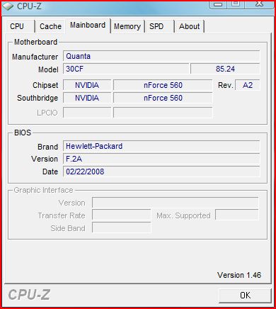

bullet25 Posted July 26, 2008 Share Posted July 26, 2008 i have been haveing the same problem, someone told me it was because of my nForce 560 chipset controler use cpu-z to find the contorler, its on page 3 cpuz_146.zip Link to comment https://www.insanelymac.com/forum/topic/117769-hard-drives-shows-not-up/#findComment-834594 Share on other sites More sharing options...
