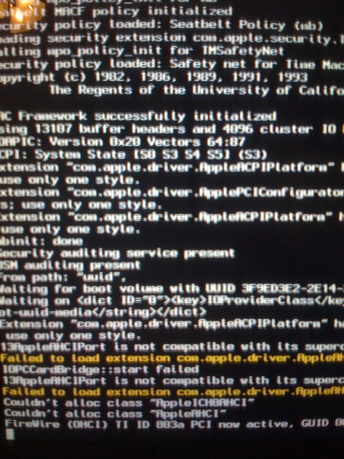

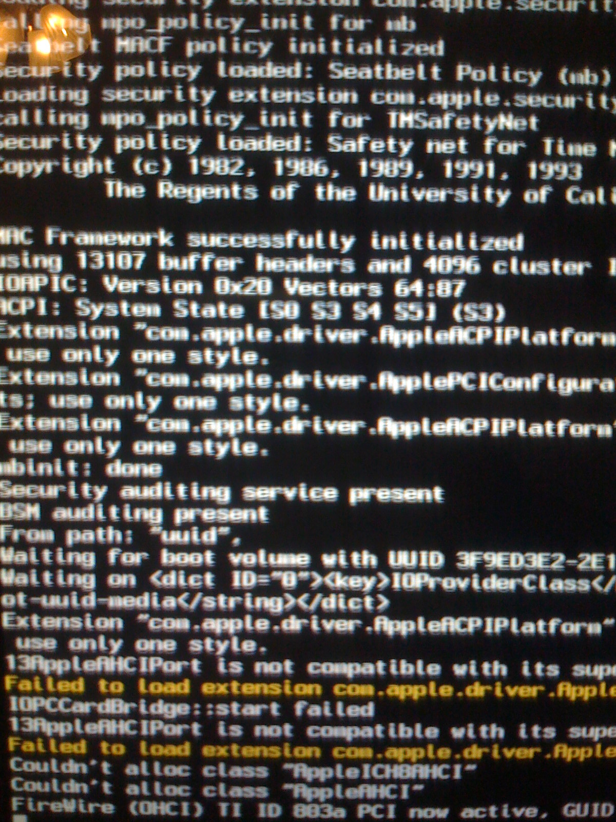

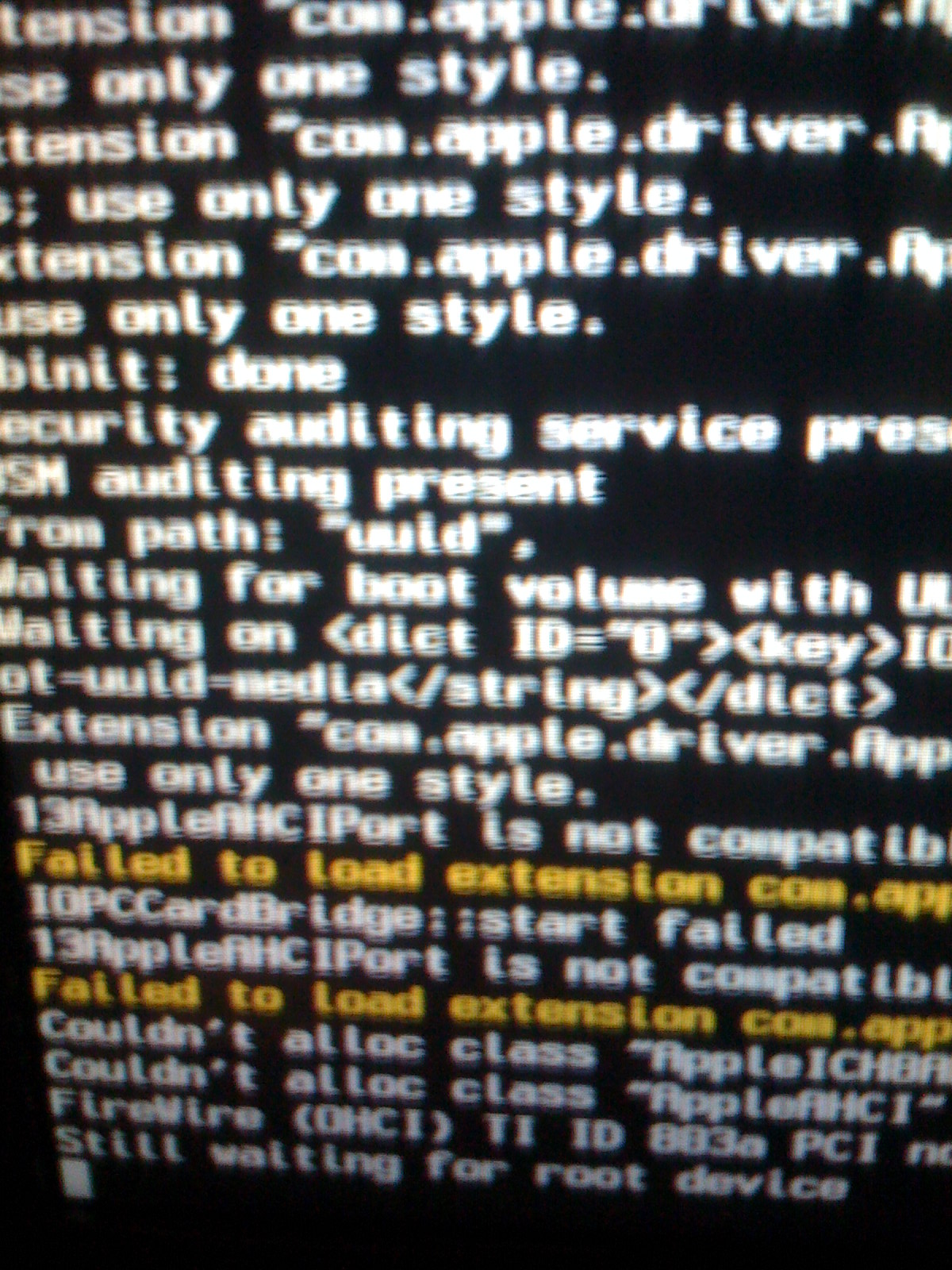

deviantfan23 Posted July 20, 2008 Author Share Posted July 20, 2008 took these pics with my iphone(all i got, sorry), im going to try to install this on my external hd with the extra stuff, then just make an image of it with disk utility, and restore my computers hd with that image. EDIT: forgot to mention, it gets as far as the 1st picture, but then it just keeps saying that its waiting. Link to comment https://www.insanelymac.com/forum/topic/116690-just-intalled-iatkos-1054/#findComment-826323 Share on other sites More sharing options...
anti_user Posted July 20, 2008 Share Posted July 20, 2008 took these pics with my iphone(all i got, sorry), im going to try to install this on my external hd with the extra stuff, then just make an image of it with disk utility, and restore my computers hd with that image. EDIT: forgot to mention, it gets as far as the 1st picture, but then it just keeps saying that its waiting. What options you check in iATKOS installer and give me your hardware list Link to comment https://www.insanelymac.com/forum/topic/116690-just-intalled-iatkos-1054/#findComment-826331 Share on other sites More sharing options...
deviantfan23 Posted July 20, 2008 Author Share Posted July 20, 2008 when i installed it, i checked the intel x3100 driver, and the atheros 500g network driver, i was reading on another forum that it may be because my sata hd isnt supported, should i go back and reinstall along with the sata support drivers? EDIT:after some more research, it seems that the sata is indeed the problem, im going to try and reinstall but select the optional sata support drivers on the dvd. Link to comment https://www.insanelymac.com/forum/topic/116690-just-intalled-iatkos-1054/#findComment-826338 Share on other sites More sharing options...
anti_user Posted July 20, 2008 Share Posted July 20, 2008 when i installed it, i checked the intel x3100 driver, and the atheros 500g network driver, i was reading on another forum that it may be because my sata hd isnt supported, should i go back and reinstall along with the sata support drivers? EDIT:after some more research, it seems that the sata is indeed the problem, im going to try and reinstall but select the optional sata support drivers on the dvd. See in the installer menu - there should be a Delete firewire kexts... If this options yet in there - check this.. Im think this bug from firewire UPD: Not... Its a SATA bug - there is additional S-ATA drivers in installer - check this Link to comment https://www.insanelymac.com/forum/topic/116690-just-intalled-iatkos-1054/#findComment-826343 Share on other sites More sharing options...
