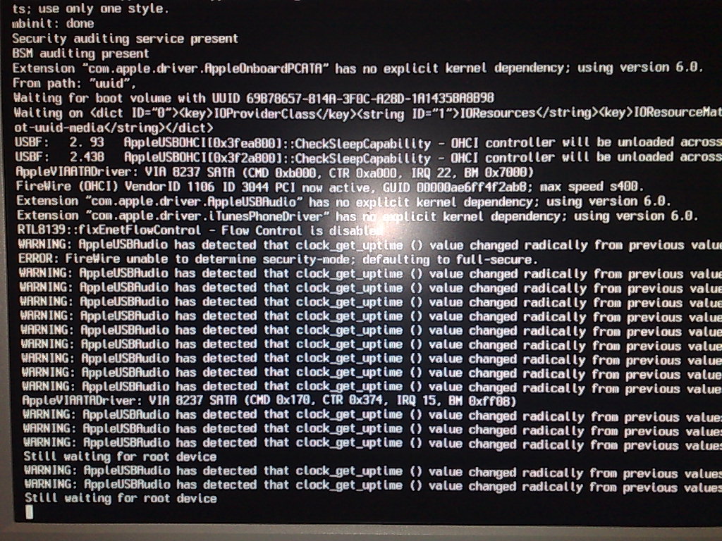

apollo13 Posted July 13, 2008 Share Posted July 13, 2008 io nn credo....vedi lo still waiting for root device indica ke rileva il controller del tuo hdd ma nn sente risposta dall hdd vero e proprio...cmq se è x curiosità puoi provare a togliere la scheda.. Link to comment https://www.insanelymac.com/forum/topic/114303-errore-installazione-kalaway/page/2/#findComment-817845 Share on other sites More sharing options...
CrazyAngel1990 Posted July 13, 2008 Author Share Posted July 13, 2008 ah no caspita è vero io non ho provato ad installarlo su un hard disk con il bus e non con il sata Link to comment https://www.insanelymac.com/forum/topic/114303-errore-installazione-kalaway/page/2/#findComment-817846 Share on other sites More sharing options...
apollo13 Posted July 13, 2008 Share Posted July 13, 2008 bè prova usando la leo4all.... Link to comment https://www.insanelymac.com/forum/topic/114303-errore-installazione-kalaway/page/2/#findComment-817854 Share on other sites More sharing options...
CrazyAngel1990 Posted July 13, 2008 Author Share Posted July 13, 2008 no ma io intendevo dire che fino adesso ho sempre provato con hard disk bus Link to comment https://www.insanelymac.com/forum/topic/114303-errore-installazione-kalaway/page/2/#findComment-817865 Share on other sites More sharing options...
apollo13 Posted July 13, 2008 Share Posted July 13, 2008 si ok allora prova con il sata... Link to comment https://www.insanelymac.com/forum/topic/114303-errore-installazione-kalaway/page/2/#findComment-817867 Share on other sites More sharing options...
CrazyAngel1990 Posted July 13, 2008 Author Share Posted July 13, 2008 ok adesso provo comunque grazie mille dell'aiuto Link to comment https://www.insanelymac.com/forum/topic/114303-errore-installazione-kalaway/page/2/#findComment-817870 Share on other sites More sharing options...

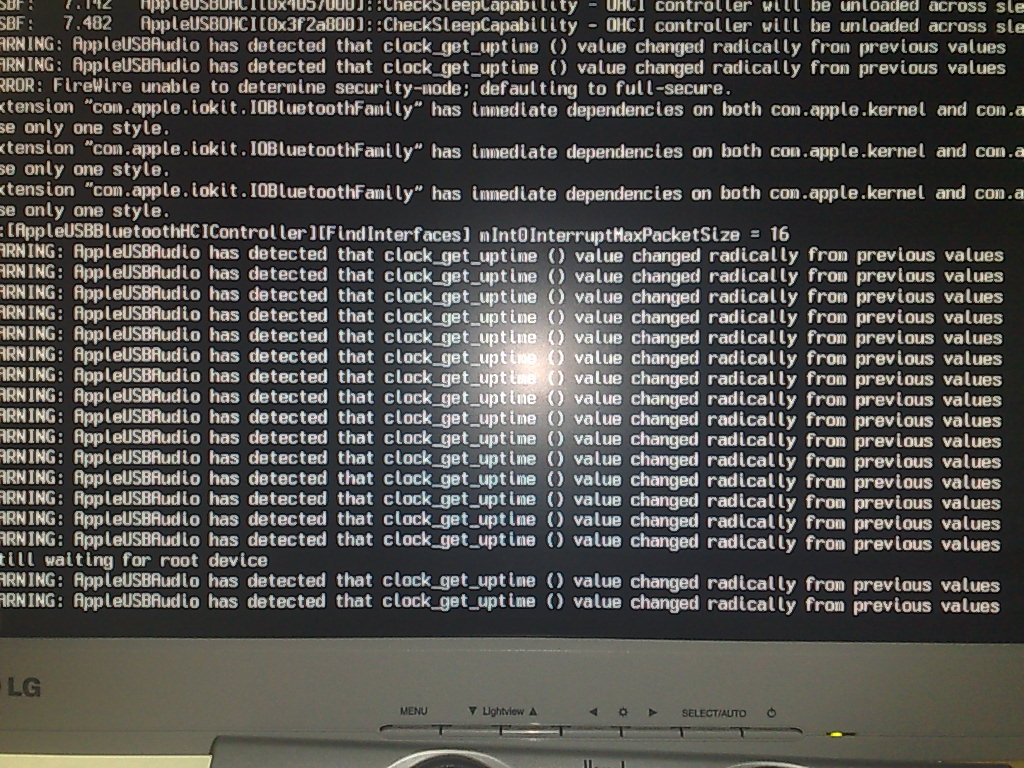

CrazyAngel1990 Posted July 13, 2008 Author Share Posted July 13, 2008 Ho provato ma adesso mi da questo errore e va avanti così e non parte l'instalazione Link to comment https://www.insanelymac.com/forum/topic/114303-errore-installazione-kalaway/page/2/#findComment-817926 Share on other sites More sharing options...
apollo13 Posted July 13, 2008 Share Posted July 13, 2008 rimuovi la schedina usb x l'audio e riprova... Link to comment https://www.insanelymac.com/forum/topic/114303-errore-installazione-kalaway/page/2/#findComment-817941 Share on other sites More sharing options...
CrazyAngel1990 Posted July 13, 2008 Author Share Posted July 13, 2008 Scusa ma non ho capito comuqnue la scheda audio è integrata Link to comment https://www.insanelymac.com/forum/topic/114303-errore-installazione-kalaway/page/2/#findComment-818304 Share on other sites More sharing options...
apollo13 Posted July 14, 2008 Share Posted July 14, 2008 si scusa colpa mia ke mi sono espresso molto male....intendevo di togliere la schedina usb.. EDIT: hai anke il modulo bluetooth??? puoi rimuoverlo o disattivarlo?? Link to comment https://www.insanelymac.com/forum/topic/114303-errore-installazione-kalaway/page/2/#findComment-818924 Share on other sites More sharing options...
CrazyAngel1990 Posted July 15, 2008 Author Share Posted July 15, 2008 ho la chiavetta bluetooth attaccata alle scheda usb interna Link to comment https://www.insanelymac.com/forum/topic/114303-errore-installazione-kalaway/page/2/#findComment-820399 Share on other sites More sharing options...
apollo13 Posted July 15, 2008 Share Posted July 15, 2008 toglila....nn hai niente oltre a quella?? Link to comment https://www.insanelymac.com/forum/topic/114303-errore-installazione-kalaway/page/2/#findComment-820421 Share on other sites More sharing options...
CrazyAngel1990 Posted July 15, 2008 Author Share Posted July 15, 2008 ho tutto l'hardware integrato tranne la scheda usb e la scheda video(nVidia 8500GT) e poi ho gli attacchi davanti degli usb, lettore memory card, fireware, jack audio e basta Link to comment https://www.insanelymac.com/forum/topic/114303-errore-installazione-kalaway/page/2/#findComment-820427 Share on other sites More sharing options...
apollo13 Posted July 15, 2008 Share Posted July 15, 2008 la scheda usb nn puoi toglierla? Link to comment https://www.insanelymac.com/forum/topic/114303-errore-installazione-kalaway/page/2/#findComment-820431 Share on other sites More sharing options...
CrazyAngel1990 Posted July 15, 2008 Author Share Posted July 15, 2008 si si che posso, quindi la gli attachi che ho davanti li posso lasciare. Grazie mille dell'aiuto che mi stai dando Link to comment https://www.insanelymac.com/forum/topic/114303-errore-installazione-kalaway/page/2/#findComment-820434 Share on other sites More sharing options...
apollo13 Posted July 15, 2008 Share Posted July 15, 2008 si quelli davanti lasciali....stracca la scheda e prova a far ripartire....in caso dimmi dove si blocca....sperando ke nn sia still waiting for root device... Link to comment https://www.insanelymac.com/forum/topic/114303-errore-installazione-kalaway/page/2/#findComment-820435 Share on other sites More sharing options...
CrazyAngel1990 Posted July 15, 2008 Author Share Posted July 15, 2008 mi da questa schermata Link to comment https://www.insanelymac.com/forum/topic/114303-errore-installazione-kalaway/page/2/#findComment-820458 Share on other sites More sharing options...
apollo13 Posted July 15, 2008 Share Posted July 15, 2008 con quale edizione stai provando leo4all??cmq permane il still waiting for root device...senti il lettore dvd è sata vero? Link to comment https://www.insanelymac.com/forum/topic/114303-errore-installazione-kalaway/page/2/#findComment-820464 Share on other sites More sharing options...
CrazyAngel1990 Posted July 15, 2008 Author Share Posted July 15, 2008 la 10.5.2 e comunque non è sata è bus Link to comment https://www.insanelymac.com/forum/topic/114303-errore-installazione-kalaway/page/2/#findComment-820469 Share on other sites More sharing options...
apollo13 Posted July 15, 2008 Share Posted July 15, 2008 ecco il problema.....il lettore deve essere sata x installare...x caso nn è ke hai un masterizzatore esterno usb?? Link to comment https://www.insanelymac.com/forum/topic/114303-errore-installazione-kalaway/page/2/#findComment-820473 Share on other sites More sharing options...
CrazyAngel1990 Posted July 15, 2008 Author Share Posted July 15, 2008 no ma se lo avessi avrei risolto il problema Link to comment https://www.insanelymac.com/forum/topic/114303-errore-installazione-kalaway/page/2/#findComment-820478 Share on other sites More sharing options...
apollo13 Posted July 15, 2008 Share Posted July 15, 2008 il masterizzatore deve essere sata...se nn è sata nn partirà mai....magari fattelo prestare da qualche amico... Link to comment https://www.insanelymac.com/forum/topic/114303-errore-installazione-kalaway/page/2/#findComment-820481 Share on other sites More sharing options...
CrazyAngel1990 Posted July 15, 2008 Author Share Posted July 15, 2008 ma se lo installo con il lettore sata poi ci metto il mio bus andra Link to comment https://www.insanelymac.com/forum/topic/114303-errore-installazione-kalaway/page/2/#findComment-820485 Share on other sites More sharing options...
apollo13 Posted July 15, 2008 Share Posted July 15, 2008 si ti basta x installare....poi quando è partito leo sei a posto.... Link to comment https://www.insanelymac.com/forum/topic/114303-errore-installazione-kalaway/page/2/#findComment-820504 Share on other sites More sharing options...
CrazyAngel1990 Posted July 15, 2008 Author Share Posted July 15, 2008 Ok adesso proverò, grazie mille di tutto Link to comment https://www.insanelymac.com/forum/topic/114303-errore-installazione-kalaway/page/2/#findComment-820523 Share on other sites More sharing options...
