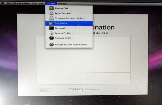

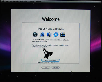

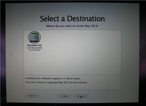

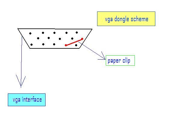

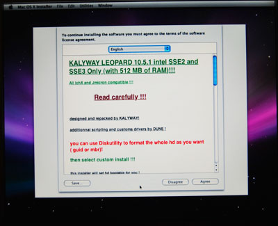

eldarskiy Posted June 25, 2008 Share Posted June 25, 2008 Hello everyone! Thanx for cool forum and community!I will talk about installing Leopard on hp 510 Laptop: 1.Kalyway Leopard 10.5.1 release(www.thepiratebay.org) 2.You need vga dongle,because after booting from dvd you see blue screen,and it freezy, but!!! vga dongle help you!!! 3.Reinstall comp, and boot from DVD, and wait approximate 5 minutes 4.Select language(my english) 5.Dont push continue button! 6.First,you need partiton your harddisk.Choose Utilitys>Disk Utlility.Choose a free space(or another file system),set togle on Mac OS X file system Journal,next press option button and choose MBR(for windows or dos computers),then press partition button.Wait few second,and quit from disk utility. 7.Second,you need make you HFS+(Mac OS X file system name) partition active,otherwise after install and booting from HDD you will see "b0 error" error,and you Leo dont boot.Choose Utilitys>Terminal 8.in Terminal make this: #fdisk -e /dev/rdisk0 >enter #p >enter #f 1 > enter #write >enter # y > enter #exit > 9.Quit from Utilitys, and press next button 10.Agree with license 11.Cheek you drive to install mac os x 12.Dont hit install button!! PRESS CUTOMIZE BUTTON!!! 13.Select Intel sse 2, and below diselect guid, and select mbr!!!(this important!!!) 14.Now click Install!!!! 15.Skip disk check 16.Wait approximate 25 minutes 17.Okey,after installation comp automatic reboot 18.After rebooting hit space button,then Enter 19.Now you see apple logo, wait...... 20.Check you Country,keybord layout,Check "Dont Transfer Information now.." 21.Wait, fater 2-3 minut you setuo reboot, and this accur again and again... 22.Ti fix this you must: Reboot comp, when you see a time counter, press f8 and hit -s, and you will go to superusermode(non graphical) then wait, while you see # - sign then make this: /sbin/mount -uw / passwd root <- Type any password you want (dont forget this password!!!!) touch /var/db/.AppleSetupDone reboot 23.This fix skip first setup. 24.Now you login in Leopard like: login:root 25.Now you Hackintosh is ready to use!!! enjoy!!! Link to comment https://www.insanelymac.com/forum/topic/112505-hp510/ Share on other sites More sharing options...
