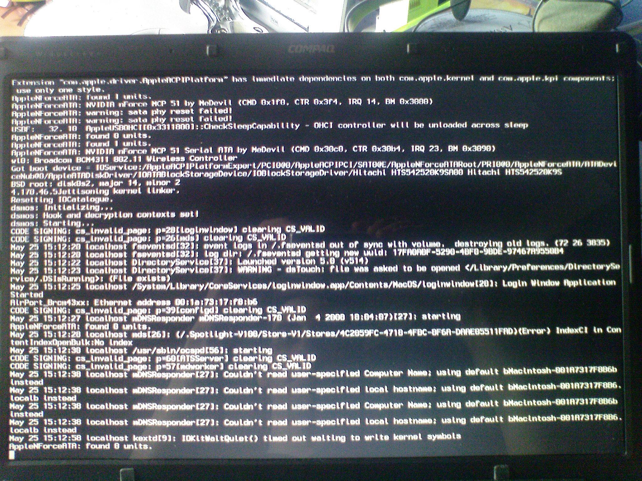

huwbie Posted May 25, 2008 Share Posted May 25, 2008 Hey guys, I've got Leo4All v3 iso burnt to dvd and i've ran through the install process on my laptop (it's a compaq presario AMD) The install proces works fine not a problem, reboot i can start booting in to OSX But I get stuck at the following bit (see pic) I was wondering if any1 has any ideas on wtf is happening been trying for 2 days to get this working now lol. bit more about the laptop: 1gb ram, AMD Turnon Proc 200gb Hdisk Nvidia chipset nvidia geforce go 440 gfx Link to comment https://www.insanelymac.com/forum/topic/106788-leo4all-post-install-problems/ Share on other sites More sharing options...
Krazubu Posted May 25, 2008 Share Posted May 25, 2008 Something's wrong with GFX, boot with -s and do : mount -uw / rm -R /System/Library/Extensions/NV* reboot cross fingers, it should boot with VESA display The commands above are case sensitive Link to comment https://www.insanelymac.com/forum/topic/106788-leo4all-post-install-problems/#findComment-758297 Share on other sites More sharing options...
