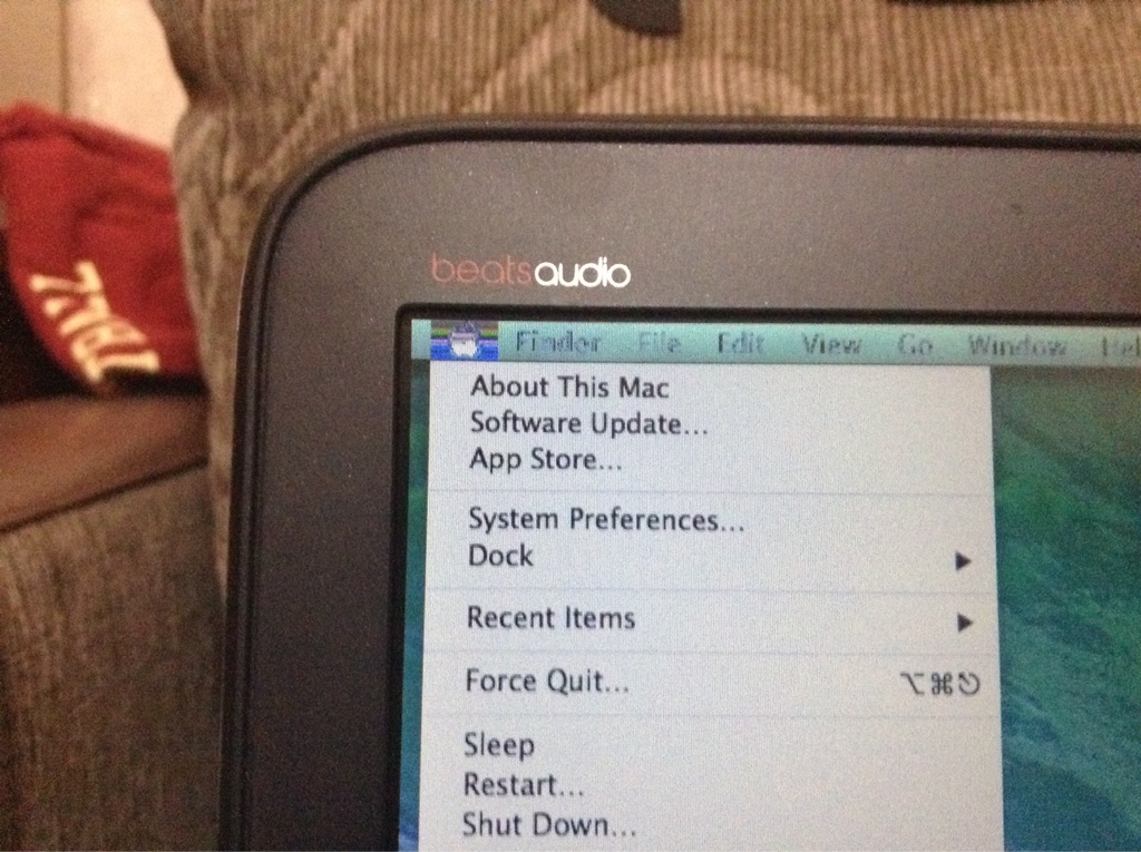

newapple4g Posted October 16, 2014 Author Share Posted October 16, 2014 Intel hd 4400/4600 patch. P.S. brightness works, battery works but not showing correct time , and when pc boot ups there is a big scratches on screen but when log on there disappears , and how to check if nvidia graphics are disabled Scratches like this Link to comment Share on other sites More sharing options...
RehabMan Posted October 16, 2014 Share Posted October 16, 2014 Intel hd 4400/4600 patch. Most just use bootloader config. P.S. brightness works, battery works but not showing correct time , and when pc boot ups there is a big scratches on screen but when log on there disappears , and how to check if nvidia graphics are disabled ImageUploadedByTapatalk1413483451.109736.jpg Scratches like this Battery status generally requires DSDT patches and a kext... (such as my version of ACPIBatteryManager.kext). You can look in ioreg or System Information to see if nvidia is disabled. If your brightness controls started working after applying the patch to turn it off, then it is very likely turned off. You could try a few more things (for 'scratches'): - set bootloader resolution to native resolution - try different ig-platform-id values (0xa260006, 0xa260005, 0xa260000, 0xa160000, 0xa2e0008) - set slide=0 kernel flag - set a color profile - inject EDID - login/logout/login - rollback Azul/HD5000 kexts to 10.9.1 - patch framebuffer... (requires much research) Link to comment Share on other sites More sharing options...
