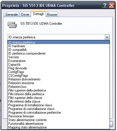

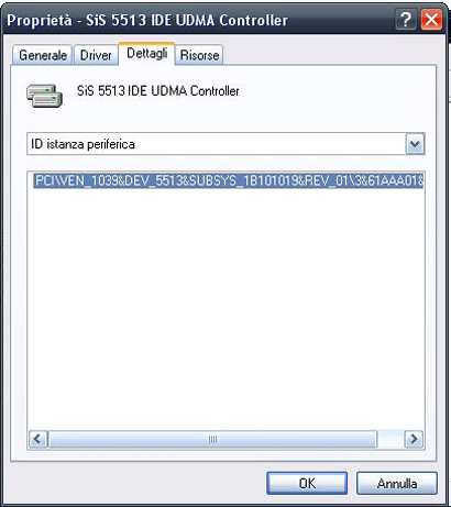

Litium_s Posted October 26, 2007 Share Posted October 26, 2007 Come trovo il mio ID?? ho provato a fare comer dice la guida, ma non so in qual escheda trovarlo. Dov'è il maledetto....!! Link to comment Share on other sites More sharing options...
DanielXan Posted October 26, 2007 Share Posted October 26, 2007 Esattamente nel box sotto il menù atendina che hai aperto. Link to comment Share on other sites More sharing options...
Litium_s Posted October 26, 2007 Share Posted October 26, 2007 mi dice solamente: qual'è il mio id?? Link to comment Share on other sites More sharing options...
