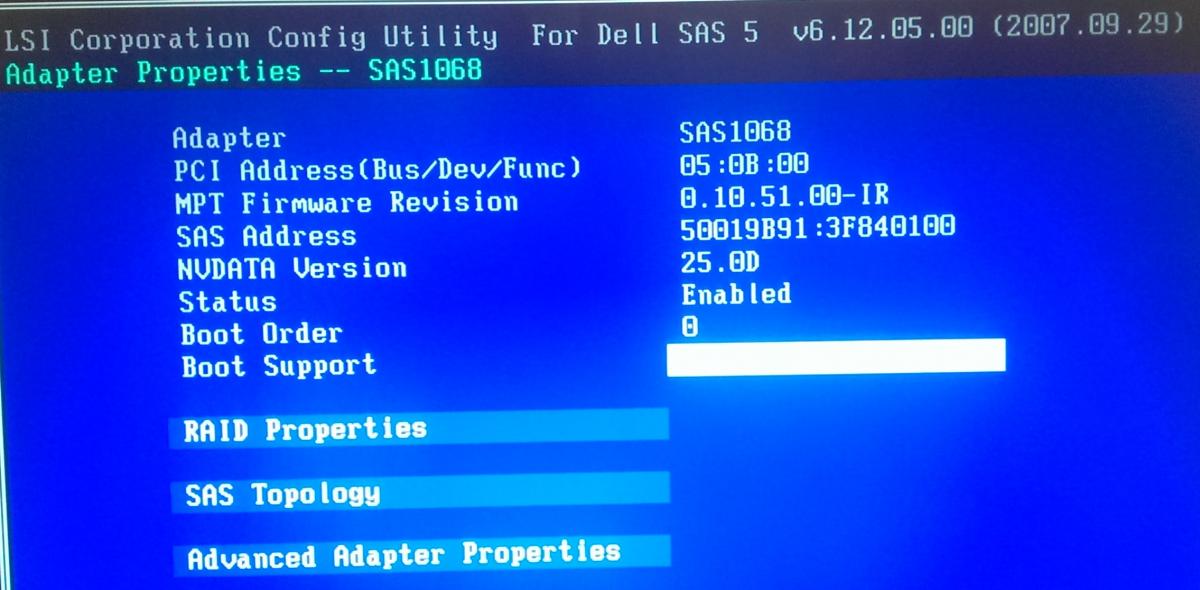

Tinkergnome Posted May 22, 2013 Author Share Posted May 22, 2013 the SAS controller is a LSI 1068 SAS/SATA 3.0Gb/s controller. I am attaching a photo as it contains more information. I am also attaching the kext that i use for it as well as it has already been modified. Not sure if it is easier to fix that or just make a new one. AppleLSIFusionMPT.kext.zip Michael’s Mac Pro.ioreg.txt Link to comment Share on other sites More sharing options...
Rampage Dev Posted May 22, 2013 Share Posted May 22, 2013 Patched driver. I will get to the rest later today. AppleLSIFusionMPT.kext.zip 1 Link to comment Share on other sites More sharing options...
