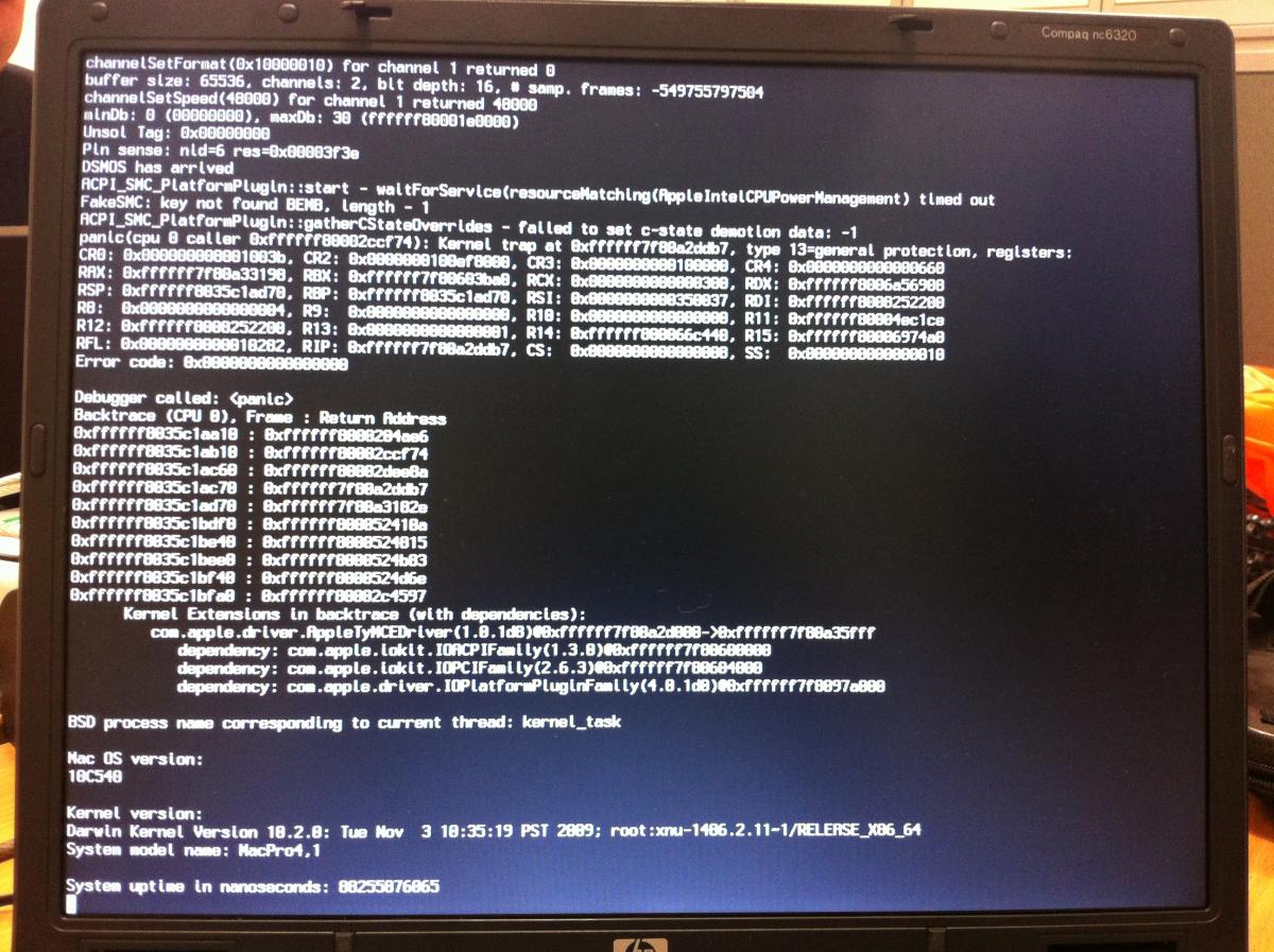

Hi all,
Wondered if someone could have a look at this panic and let me know their thoughts?
The install went smoothly, but at first boot after using the flag -v only, I get the panic.
I've done various installs and I keep getting various panics, but this is the correct install as far as I can make out.
The machine is a HP NC 6320.
Any help appreciated!
I just tried the following in Terminal;
mount -uw /
rm -rf /system/library/extensions/AppleTyMCEDriver.kext
exit
Rebooted, but the same panic comes up.
And I looking at the right thing?
UPDATE:
I also tried removing the other kexts (I think), but it came back with the exact same error (so I probably didnt remove them).
I've tried all variations of the following flags;
-v cpus=1 -f Colors=32

FURTHER UPDATE:
I seem to have removed the kext with the following;
cd /Volumes/OS_X/System/Library/Extensions
rm -r AppleTyMCEDriver.kext
cd ..
rm Extensions.mkext*

And it works :)
