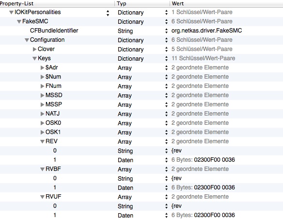

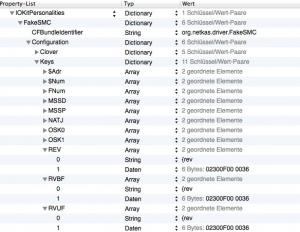

wartomato Posted December 31, 2013 Share Posted December 31, 2013 Hi there, I found an interesting article in this post: http://www.osxlatitude.com/tuning-performance-with-fakesmc-smbios-plist/ It claims that the performance of the internal CPU fan could be influenced by changing the SMC-Vervion in FakeSMC. By default it loads version 1.30fxx which some kind of generic (even suitable for old systems). My fan comes up quite fast and loud when load is on the system. Using my SMBIOS version MBP10,1, which comes closest to my system, I changed the version of the SMC to 2.3fxx. This is the apporpiate version corresponding to the Apple table (see PDF). My fans come in slow and later. the system heats up a bit more (about 10 degrees celsius), but it is really smoother and not so loud. I personally think that the battery might last longer, when the fans do not turn at such high speeds all the time. So test it, if you want: - open the FakeSMC.kext in S/L/E, - choose the correct version from the PDF from Apple, - backup the kext, - edit the Info.plist (look at JPG and Info.plist.txt, which I had to rename in order to upload it here) inside FakeSMC.kext, - install it back with KextWizard and... voila! Happy New Year :-) FakeSMC SMC-Firmware-Updates für Intel-basierte Macs.pdf Info.plist.txt Link to comment Share on other sites More sharing options...

wartomato Posted February 22, 2014 Share Posted February 22, 2014 VGA preferably Hi, tested 4 weeks ago with "standard" Intel driver (non-patched) to get dual link. Well, it functioned, but I hadn't a full-HD monitor. Installed SwitchRes for a help... Will try with patched driver and VGA-cable on my TV (damn, where is the cable...) @iClock: No. Got this with one time after updating FakeSMC. Solved by reinstalling, repairing permissions and kernel cache and using "-f" (or UseKernelCache=No in Chameleon), allthough I did not change that before. Right now the fans are working... (kernel[0]: AICPUPMI: CPU P-States [ 12 22 23 29 30 31 32 33 ]) using FakeSMC 6.0.1115. Link to comment Share on other sites More sharing options...
iClock Posted February 22, 2014 Share Posted February 22, 2014 My laptop runs hot that is the reason why my fans are running constanty at the same speed.Average CPU temp is 64.9 Celcius using Intel Power Gadget to monitor temperature of CPU.This app also shows me the speed of the cpu which goes from 1,2ghz to 2,5 ghz depending on the what the user does,the power used is usually 6.54 W.How can I lower my CPU Temp ?switching system definitions does not work ,currently I have MacBook Pro(9.2). Here is a screen shot in order to show my cpu temp using the Intel Power Gadget app.Temp too high for just surfing the web. https://www.dropbox.com/s/8pqompmlbjumsaz/Screen%20Shot%202014-02-22%20at%2013.53.06.png After using Intel Power Gadget it seems that the cpu average speed is 1.59 ghz when actually idle,however sometimes it goes to 1.2. Link to comment Share on other sites More sharing options...
