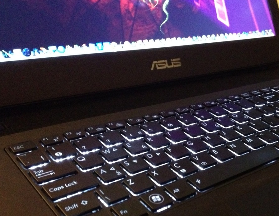

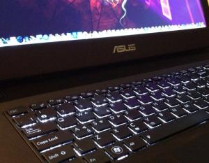

confirm ubuntu enables the keyboard backlight. so at reboot is still turned on!
edit: i'm trying to enable brightness.. I have the control bar but it's not working.

If the soft reboot from ubuntu to mac makes the light untouched .. and if the wake did the same.. is for the same reason:
the EC register has a bit with the info of the value of the keyboard light. And the DSDT tell to BIOS to RESTORE the value that EC has before the sleep.
In fact the WAKE procedure reads all the prvious states and restore them.. and it invoke the ATKD backlight.
so: my idea is to manually create the bit in the EC INI/REG section of the DSDT.
if so.. at boot you'll always have the light turned on.
nice news for the backlit keyboard! So it's enough i run linux ubuntu (downloadable for free) from virtualbox (free) and after that keyboard works on ML after resuming from sleep?
You have a point - since I have got my backlit working, if I sleep then wake (so it comes on) I can reboot and it stays lit through the boot process. Only shutting down entirely turns it off. Or, I guess, loading another OS that calls a 'proper control'.

with RW everything I read the
9C cell in the EC register
it changes from 00/55/aa/ff
in the 4 states
in the dsdt it's the var TSTP
and it's in the RAMB register (volatile 1) and in the EC register (volatile 0)
TSTP, 8,
Offset (0x9C)
in the LCDD (under gfx0) device there is an external entry of EC for that specific control:
 Method (_QAA, 0, NotSerialized)
	 Store (One, ^^^^TSTP)
	 ISMI (0xA7)
	 Store (One, OEMP)
	 PNOT ()
 Method (_QA6, 0, NotSerialized)
	 Store (0x02, ^^^^TSTP)
	 ISMI (0xA7)
 Method (_QA8, 0, NotSerialized)
	 Store (0x03, ^^^^TSTP)
	 ISMI (0xA7)
	 Store (One, OEMP)
	 PNOT ()
these (the _Q methods) are theQUERY : what happens if you press some in the direct connection with bios.. or what happens when you detach a battery.. etc..
the ISMI is locate under the root.. and point to another bank of ram/register
OperationRegion (GPSC, SystemIO, 0xB2, 0x02)
    Field (GPSC, ByteAcc, NoLock, Preserve)
	    SMCM,   8,
	    SMST,   8
    Method (ISMI, 1, Serialized)
	    Store (Arg0, SMCM)
in the WAKE.. the 1st operation is to write ISMI xxxx.. so I suppose that if the value of the ISMI is the same in the 3 query.. is not important or is a flag to tell that the same family of query has changed it's value
the 3 query stores 1, 2, 3 in the TSTP register. and the 4?
I suppose this is not the command but the only a query. because the 4 values 00/55/aa/ff are quite different from 1,2,3.
infact I discovered the under the DEVICE ATKD
Method (GLKB, 1, NotSerialized)
with the 1,2,3 and it STORE that value in the KBLV var.
and
	    Name (PWKB, Buffer (0x04)
		    0x00, 0x55, 0xAA, 0xFF
	    Method (SLKB, 1, NotSerialized)
		    Store (And (Arg0, 0x7F), KBLV)
		    If (And (Arg0, 0x80))
			    Store (DerefOf (Index (PWKB, KBLV)), Local0)
		    Else
			    Store (Zero, Local0)
		    ^^PCI0.LPCB.EC.WRAM (0x044B, Local0)
		    Return (One)
this is the core!
in fact it use the INDEX of KBLV (1,2,3) and get the relative value from the array.
the comand is the last row: it write in the EC.WRAM the proper value in the reg 044B
windows and ubuntu can translate the Fn+key with that command.
If we can change the xproj of the wmi.. we can add a command for the missing f3/f4 unmanaged buttons.. and for the actual needing.. we can invoke that command in the boot.
how?
the Sleep (Method (ECS, 1, NotSerialized)) set to zero the light.. WRAM (0x044B, Zero) after writing the last value Store (RRAM (0x0449), Local0)
and the wake read the value in the RRAM
and fix the value only if we are in a wake:
If (LOr (LEqual (Arg0, 0x03), LEqual (Arg0, 0x04)))
		    And (Local0, 0x02, Local1)
		    If (Local1)
			    Or (Local0, One, Local0)
			    WRAM (0x0449, Local0)
so we're sure.. the WRAM 0x0449 fixes the value in a separate bank.
WRAM 044B fix the value in the live system
i'll try
WRAM (0x044B, 0xFF)
i'ss test the ini and reg EC
see ya
yeah
here you are
this is for g53
search for the text
grab the text i've added in the 3 positions ad put in your dsdt.dsl in the same position

Good find Ugokind, I will test it when i get back. For PNLF, Method GCBL and it's Storing to ECO.STBR.
For Backlit Keyboard Why no store that value under SLKB? This is the last argument before it is invoked by ATK. Since we don't have ATK software to trigger it, just leave it on.
Else
^^PCI0.SBRG.EC0.WRAM (0x044B, Local0)
Return (One)
I think Method _Q0E is how example: (Fn-F5) down backlight stores to EC and so on...
My fixes works.
But the light is always turned on
Why not to engage a team to mod the wmikext source that i posted?
We can do that too but I don't know anything about Xcode. Didi you get that from EMlyDinEsH? Let me do more reading!
Just need to find the right code for FN-F5/FN-F6 for back light
FN-F3/FN-F4 for backlit keys.

maybe we can get some guidance from EMlyDinEsH. Looks like the controls is there, but key press is not enabled. I am currently spending some quality time with family at six flags for the light show tonight. When I get done ill try to look into this later tonight.
this is what i got from a blog
yes is it
https://github.com/EMlyDinEsHMG/AsusNBWMI
but i got pne error in compile.. so this is exactly what we have to do
we have to replicate a behaviour for other keypress.. and hook the internal dsdt function
Can u post what u have done so far?
take it as it comes.. we've a spring .. but the world will be also tomorrow.
I've xcode for ml.. and i'm not a developer.. but a little bit.. yes.
so i'll check the code.. because recent xcode give errors about obsolete code.
then.. i'll check the events-keypress
I had recompile both ACPIBacklight.kext and AsusNBWMI.kext to newest codes. Give me sometime to add new features to it.
