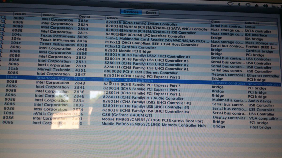

iFIRE Posted August 19, 2012 Share Posted August 19, 2012 you have put your device id in IO80211Famili.kext and for problem slow you have put in your boot.plist UseKernelCaches=Yes    Edit: use this app and locate device id for your wifi, or take one screenshot and post here   Edit:2 use this code for create Extensions.mkext , this is for speed your system boot, copy de code and put in app Terminal wait the process ends, now reboot   sudo kextcache -v 1 -a i386 -a x86_64 -m /System/Library/Caches/com.apple.kext.caches/Startup/Extensions.mkext /System/Library/Extensions    https://www.dropbox....x1bm/Mot87kQ2Y7 Link to comment Share on other sites More sharing options...
theoh88 Posted August 19, 2012 Author Share Posted August 19, 2012 I cant open dpcimanager app Link to comment Share on other sites More sharing options...
iFIRE Posted August 19, 2012 Share Posted August 19, 2012 I cant open dpcimanager app    try this Systeminfo-Mac.zip Link to comment Share on other sites More sharing options...

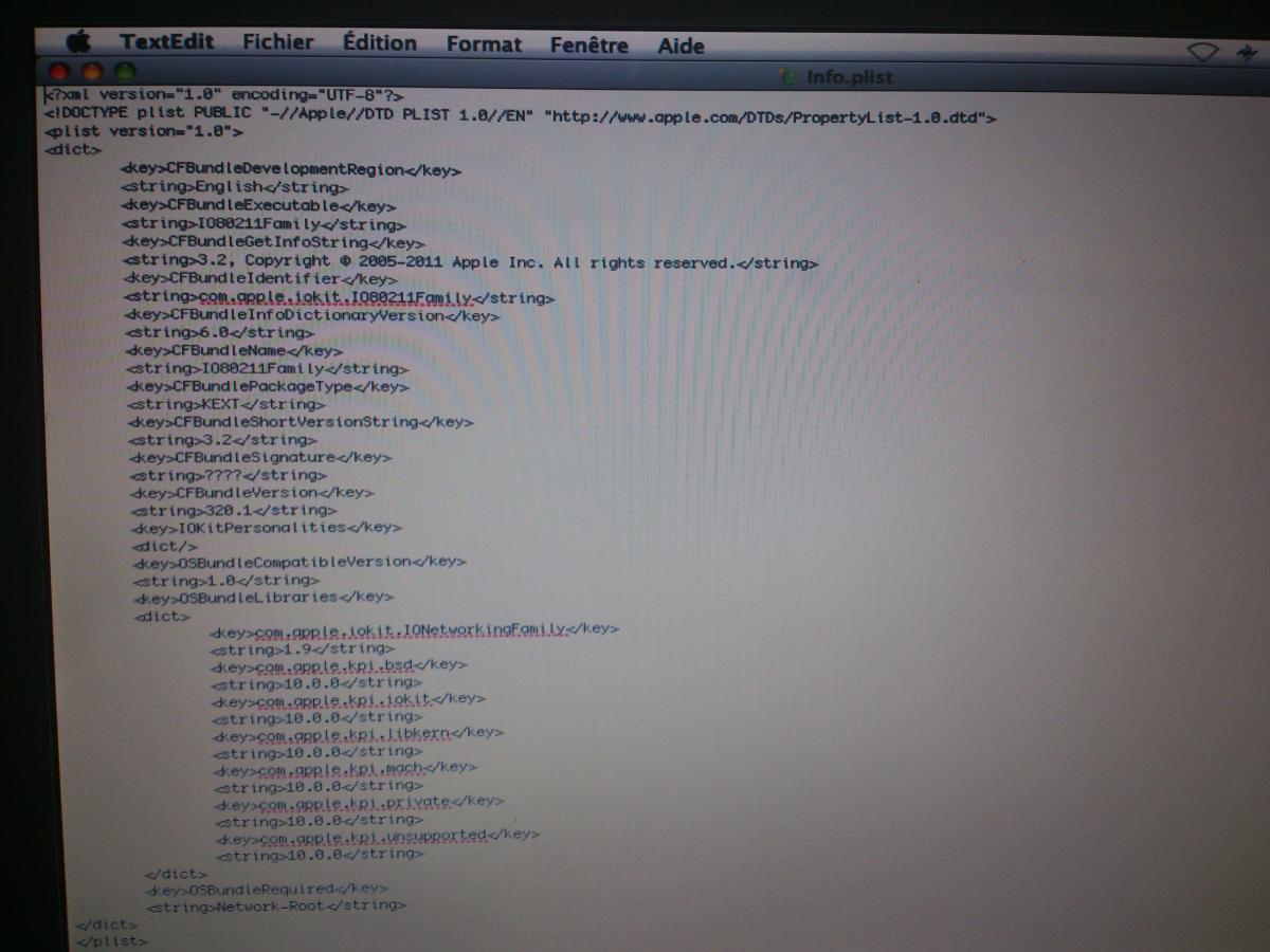

theoh88 Posted August 20, 2012 Author Share Posted August 20, 2012 Screenshot Link to comment Share on other sites More sharing options...

iFIRE Posted August 22, 2012 Share Posted August 22, 2012 post your kext IO80211Family.kext, I go edit the device id for your card Link to comment Share on other sites More sharing options...
