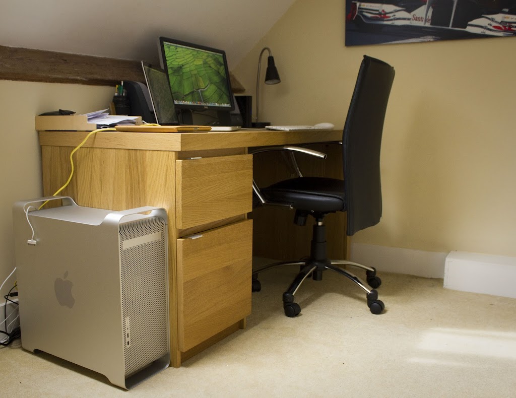

A quick shot of the G5 in place at my set up! It looks really good!
