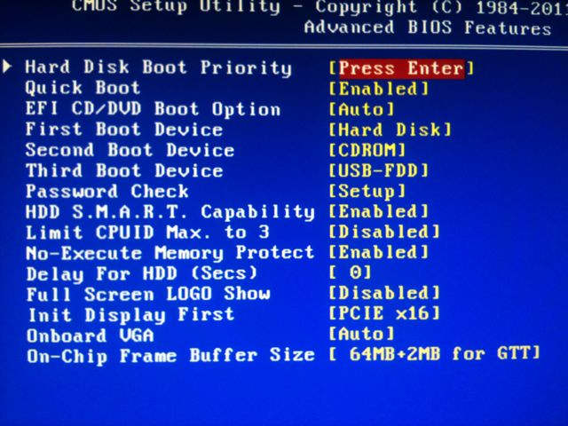

Then something is wrong in your bios setting's. Ill post some pic's later on.
RW

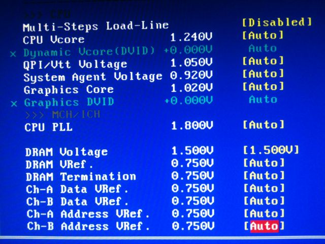

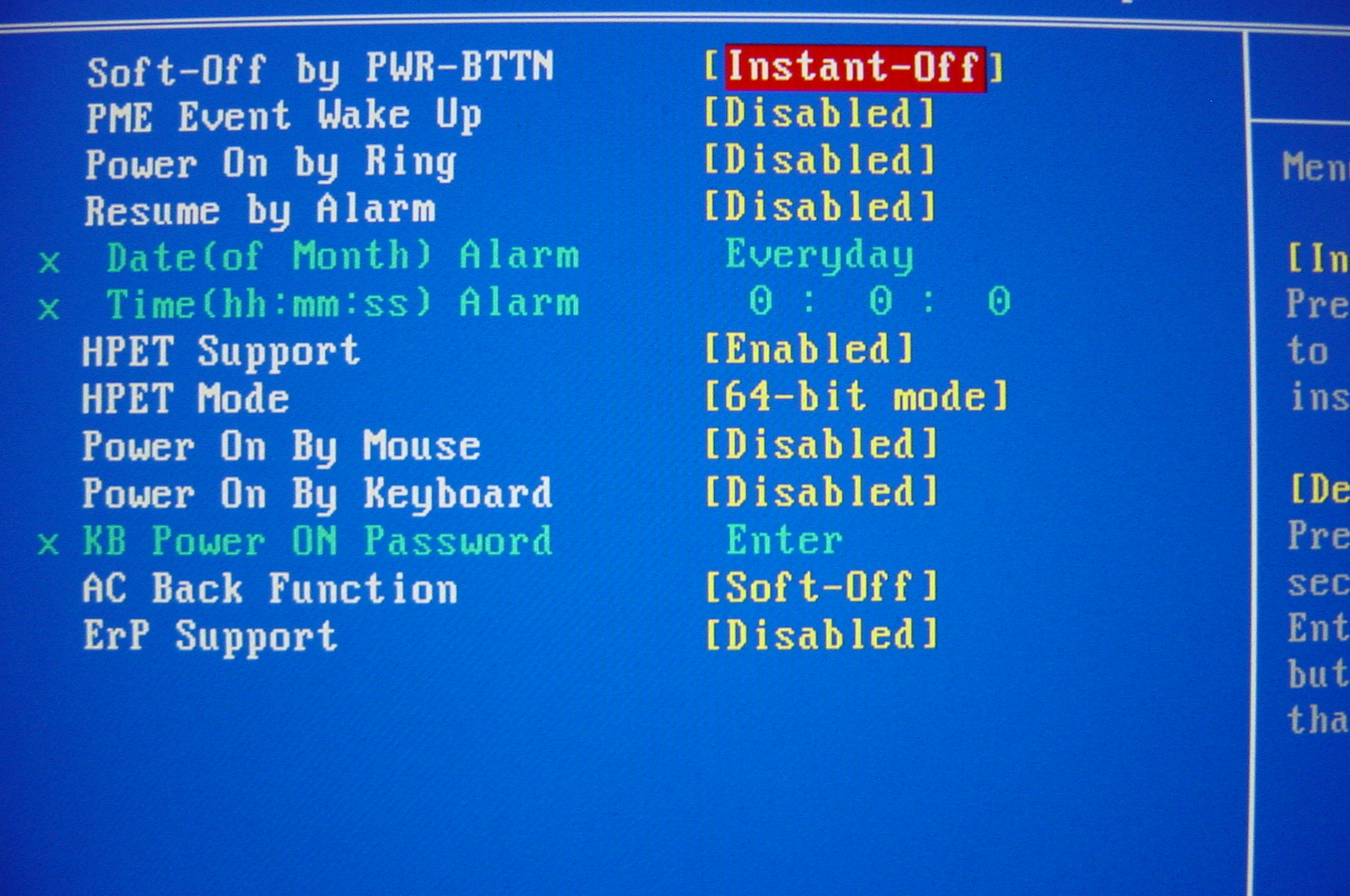

#5
Edkroket
Edkroket
    InsanelyMac Geek
  • Members
  • PipPipPipPip
  • 214 posts
  • Gender:Male
  • Location:Amsterdam
  • Interests:Music, I'm a bass player
RW

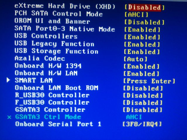

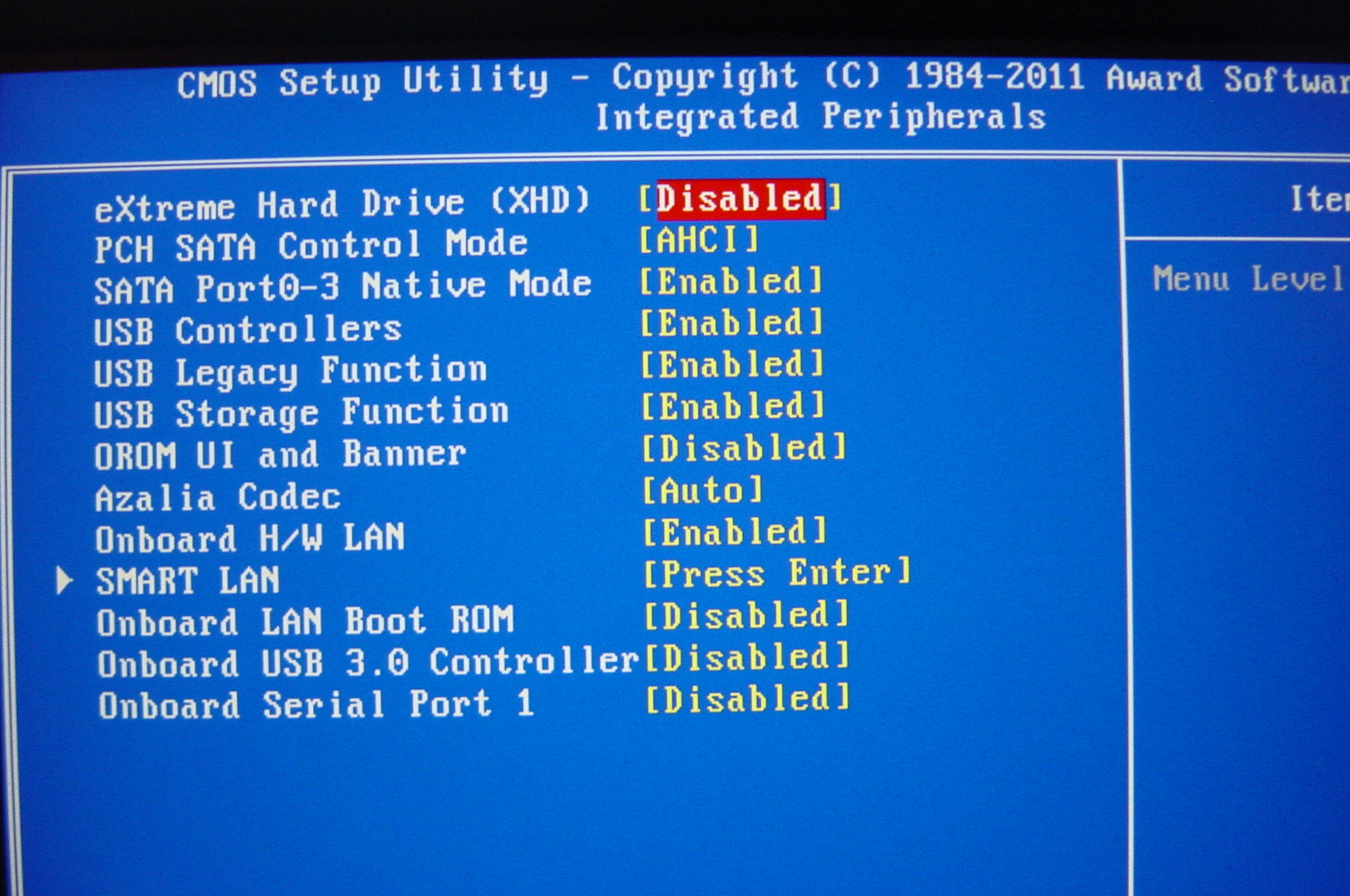

Thanks again! I've changed some settings according to your pics. still the same!
Here are the my BIOS settings.Attached File  IMG_0012.jpg   52.22KB   52 downloadsAttached File  IMG_0013.jpg   77.43KB   51 downloadsAttached File  IMG_0014.jpg   77.1KB   43 downloadsAttached File  IMG_0015.jpg   63.92KB   46 downloadsAttached File  IMG_0016.jpg   69.48KB   45 downloadsAttached File  IMG_0017.jpg   68.67KB   54 downloadsAttached File  IMG_0018.jpg   67.54KB   43 downloads
What else could it be? It's the first time I'm in this kind of trouble.
I already have many different boards and I all managed them to sleep properly except this new board.
Ed

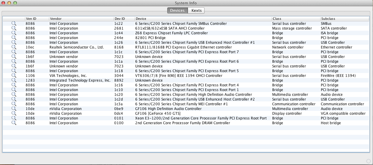

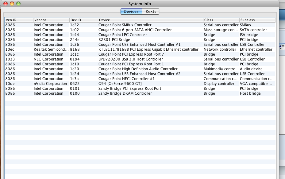

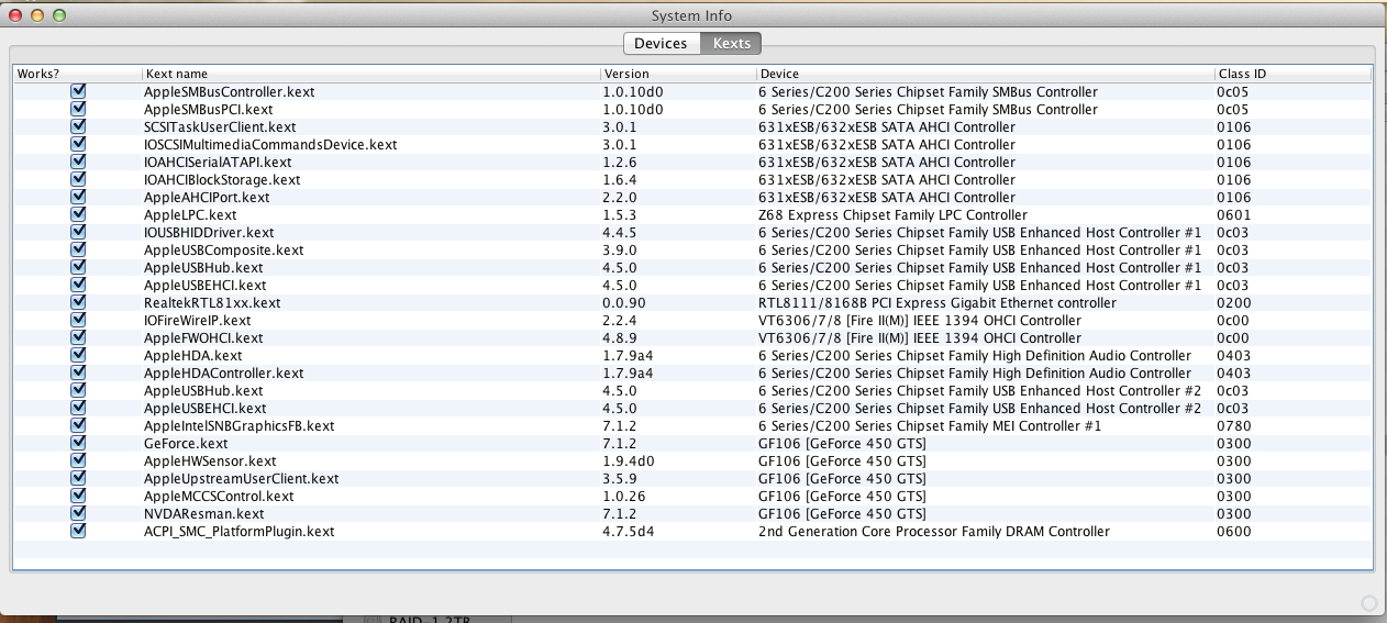

Ha Ed,
Het moet er in ieder geval qua devices zo uitzien!
Post ook even zo'n image. is wel belangrijk dat je imac12.2 kiest.
Update even je signature zodat we al de hardware info hebben.
RW

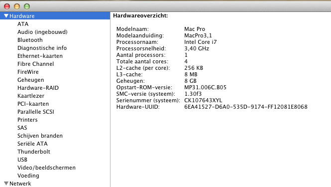

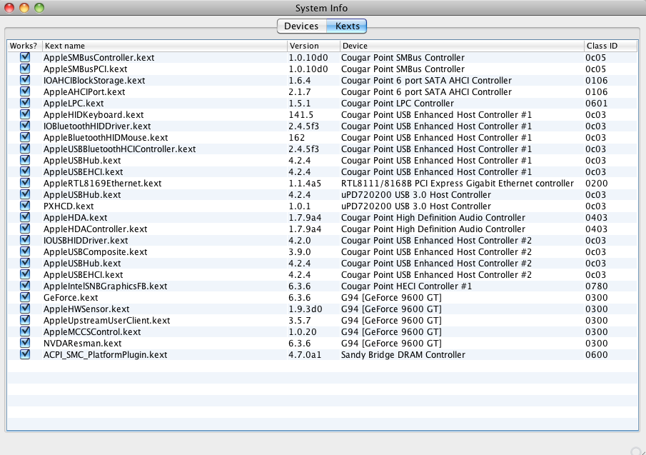

Ha Ed,
RW
Hier mijn plaatjes met MacPro 3.1
Attached File  Schermafbeelding_2011_11_12_om_16.37.28.png   1.31MB   32 downloadsAttached File  Schermafbeelding_2011_11_12_om_16.37.35.png   1.33MB   33 downloadsAttached File  Schermafbeelding_2011_11_12_om_16.40.58.png   1.22MB   30 downloads
Ed

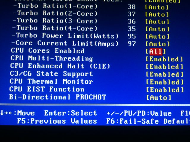

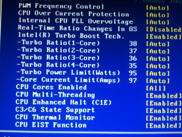

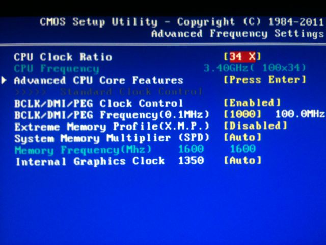

So here is what I did.
running Bios F6. but now I think that F8 will work the same...
in Bios;
MIT/Advanced Freq...../Advanced CPU Core....;
Intel Turbo Boost-enabled
Multitreading-enabled
C3/C6 State-disabled
The rest on auto
Advanced Bios Features
Quick Boot-enabled
Integrated Peripherals
1394-disabled
R_USB3.0 Control-enabled
F_USB3.0 Control-enabled
OROM UI and Banner-disabled
GSATA3 Controller-disabled
Onboard Serial-disabled
I put machine to sleep with either the power button or via Applemenu-sleep
To wake I use power button again, wait a few seconds and press a key on my keyboard and it's wake and I can use mouse and keyboard.
Hope this will help you!
Ed

So here is what I did. running Bios F6. but now I think that F8 will work the same... in Bios; MIT/Advanced Freq...../Advanced CPU Core....; Intel Turbo Boost-enabled Multitreading-enabled C3/C6 State-disabled The rest on auto Advanced Bios Features Quick Boot-enabled Integrated Peripherals 1394-disabled R_USB3.0 Control-enabled F_USB3.0 Control-enabled OROM UI and Banner-disabled GSATA3 Controller-disabled Onboard Serial-disabled I put machine to sleep with either the power button or via Applemenu-sleep To wake I use power button again, wait a few seconds and press a key on my keyboard and it's wake and I can use mouse and keyboard. Hope this will help you! Ed
Thank you for reply.
So your USB devices are still being reconnected after wake up? Are you getting any errors on console like:
kernel: USBF: 395.920 [0xffffff8015543000] The IOUSBFamily is having trouble enumerating a USB device that has been plugged in. It will keep retrying.
kernel: 0 0 AppleUSBCDC: start - initDevice failed

Yes my USB device are still being reconnected after wake. And yes there are some errors in console but they work just fine.
And this one I don't have
This one I also get.
But still all is working!
And also I updated Bios to F8 and everything is working the same so with problems the same behavior as with F6
Ed
