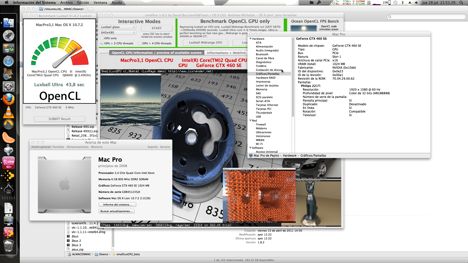

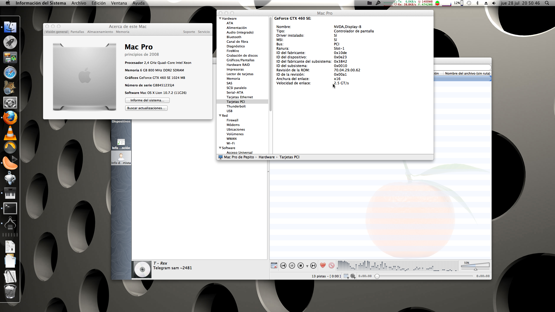

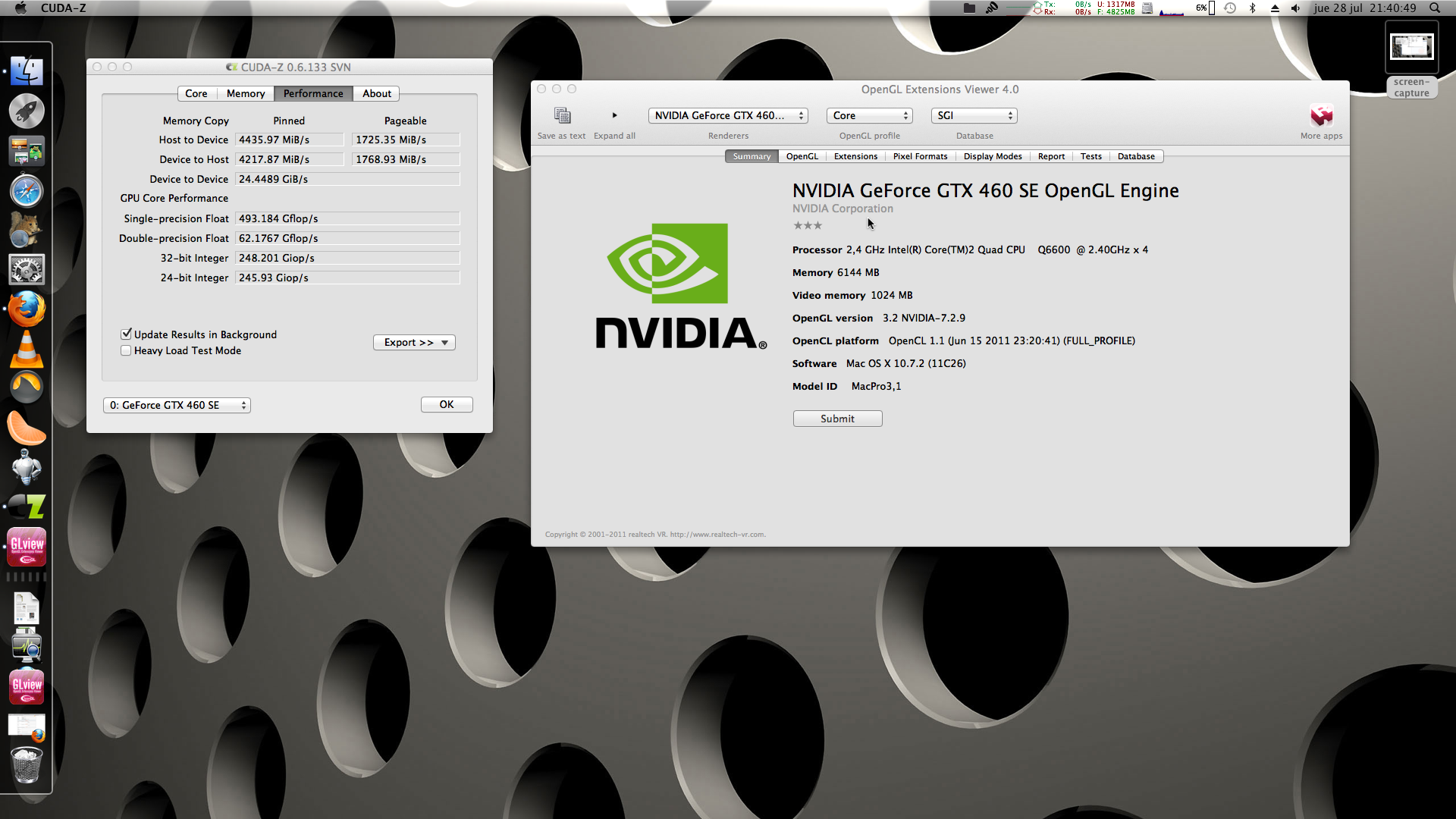

pepitopito pito Posted July 28, 2011 Share Posted July 28, 2011 YEEEEEEEEAAAAAAAH Link to comment https://www.insanelymac.com/forum/topic/263901-gtx-460-se-works-perfect-in-lion/ Share on other sites More sharing options...
