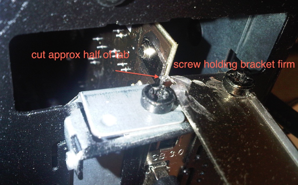

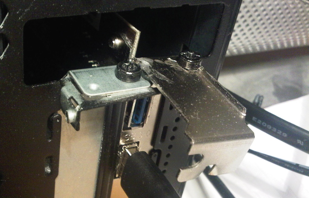

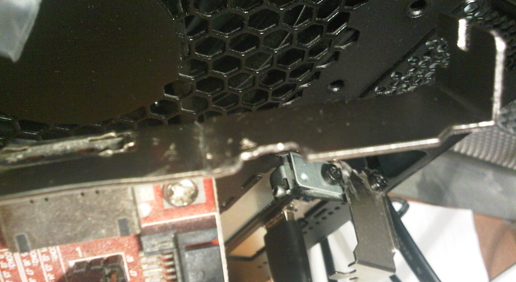

rtrtrtrt Posted November 2, 2011 Share Posted November 2, 2011 Pics below - bberry but better than i expected tbh 1st one shows asus card in situ. you can see i've removed the black metal cover/door - this was easy - just eased it off it's hinge with a fingernail. See how far down you have to go with the dremel - halfway thro the top mounting tab. Also you can see how when i bent it to 90 degrees it didnt work perfectly - ie the lhs of the bracket is a little higher than the rhs so it's at a bit of an angle - but still good enough to tighten the screw and hold it in place. The problem is that the tab is just about a cm higher up than ideal. 2nd one is a closeup and probably shows the dremel cutting a bit better. 3rd one shows the esata card after cutting, bending, installing and then removing and straightening again. Good enough to go back in a full height slot i think. The line across the bracket is a line i scored in the metal with the dremel - an attempt to make the bracket easier to bend - not sure it made any difference. 4th one you can see that the esata bracket is not fully straight afterwards. Link to comment Share on other sites More sharing options...
splonk Posted November 3, 2011 Share Posted November 3, 2011 Thanks for that. I'm impressed the Dremel made it through the metal. I didn't think it had it in it. I might give it a go and sacrifice the end of the bracket. If I need it to go into a full sized machine I can always beg Asus for another bracket. With regard to the lockup, I had something similar the other day on a full sized Proliant I had running all day. This is on SL server 10.6.8. I tried screensharing into it and couldn't connect. I found an old copy of Remote Desktop and threw it on. Still didn't get anywhere, although I could still log into my Proliant and mount shares via Finder. Not sure what is going on, but I disabled any sort of sleep via prefs in all my servers as HP doesn't support S3 in them. Try this kext for your USB 3 and see if it helps PXHCD.kext.zip Link to comment Share on other sites More sharing options...

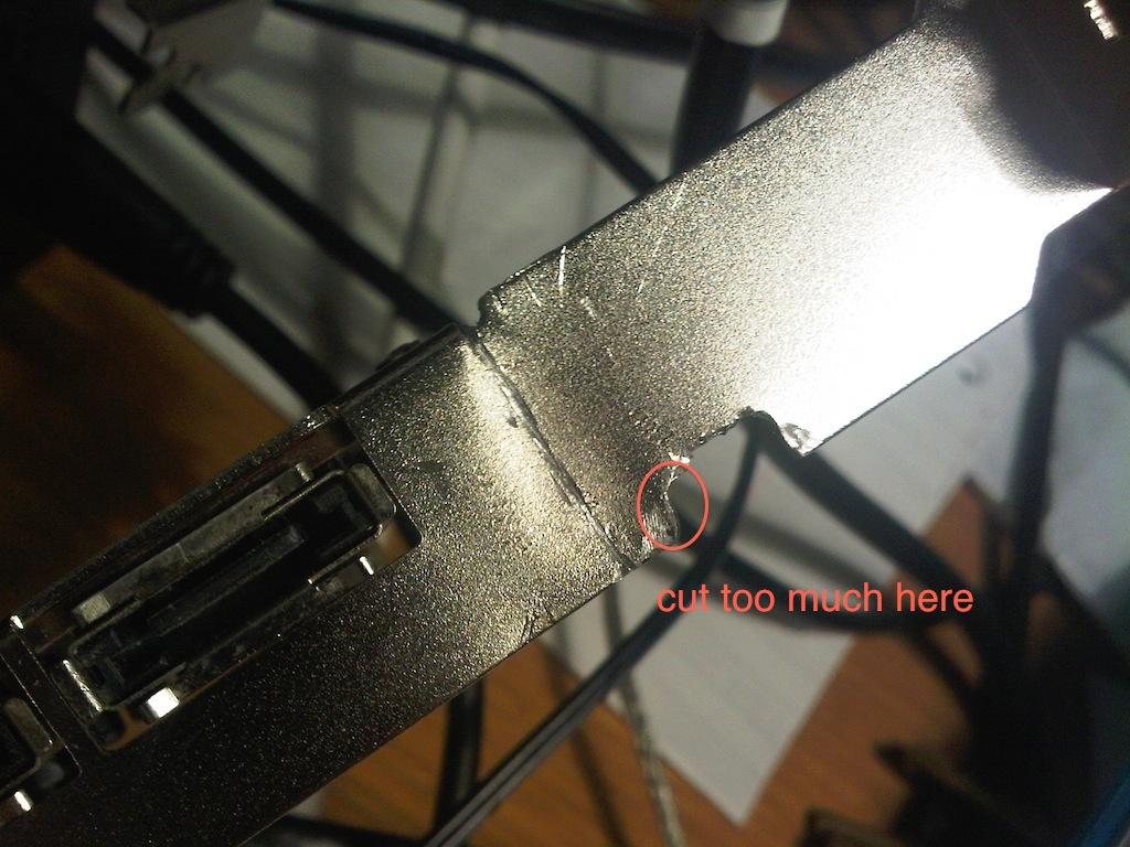

rtrtrtrt Posted November 13, 2011 Share Posted November 13, 2011 You can see that the inability to cut down on the lhs as far as you need to, means that the bracket isn't straight. rhs needs to be bent at the level that the screw can enagage with the server chassis. Hopefully you can see that half of the mounting tab remains attached to the bracket and so secures the card to the bracket Card isn't really straight in the chassis, but i certainly seem to have got away with it. I don't think PCIE is a precision engineered system ie i think there's a bit of slack that I managed to take advantage of. Card is firmly held so you can plug/unplug cables no problem. The cutting involves a bit of trial and error - in this case I measured twice and still got it wrong! Didn't matter as I hadn't gone to far 'into' the bracket and so the screw still gripped there and the other side. This is my practice card - a cheap esata i picked up way back. That one was bent straight and sat in the chassis straight too. Link to comment Share on other sites More sharing options...

splonk Posted November 15, 2011 Share Posted November 15, 2011 Re the card - it's definitely mechanically stable. I know what you mean about the 2nd screw postion. I cut the bracket to allow the 2nd screw clip to stay partially attached from the bracket to the card, which meant I couldn't bend the bracket straight. Let me edit the pic tomorrow to highlight the right part. Btw for those who dont know already, the replacement HP Microserver with the slightly faster processor, now has the £100 cashback offer on for november. Tempted to pick one up to experiment with Linux, as I've never used it for more than 10 minutes on friends machines. Since HP will sell it with Red Hat then i'm assuming any of the distros will work well. Will try this tonight. I think I am going to struggle with the bracket as I don't have a suitable vice to hand, so I am going to try a halfway house and just straighten the top tab of the bracket with a pair of pliers and try to attach the bracket some other way to the housing - glue gun or whatever. That will have to do until I hone my bodging skills. Re the microserver - Scan had a one day special on Friday. They were clearing the N36L for £162 delivered. That is, a ridiculous £62 after cashback. I bought one and chickened out at the last minute just as they were despatching as there was some doubt that Scan qualified as an authorised reseller for the cashback. Could not get hold of HP or the cashback agency over the weekend so I cancelled the purchase as I would have received it that Monday. Turned out that Scan was approved, although Scan itself seemed unaware of it. Offer is over and Scan is clean out of stock. Gutted. It would have been my Linux cum OS/2 plaything. Link to comment Share on other sites More sharing options...
