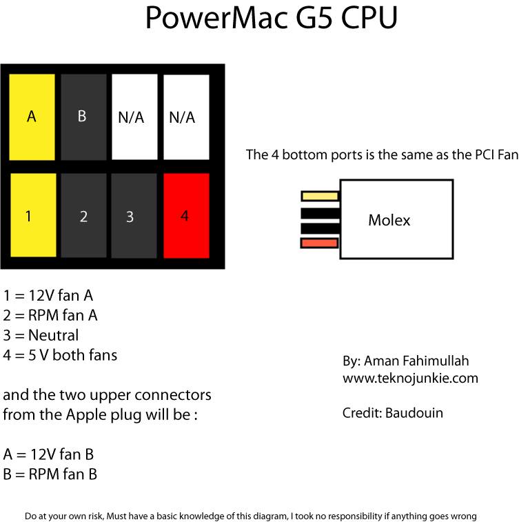

BlackCH Posted May 26, 2011 Share Posted May 26, 2011 I use 90mm PC fans. I got some Noctua; really quiet If you still want to use the original G5 fans here is the pinout: G5 fans are too noisy for my taste. Link to comment Share on other sites More sharing options...
