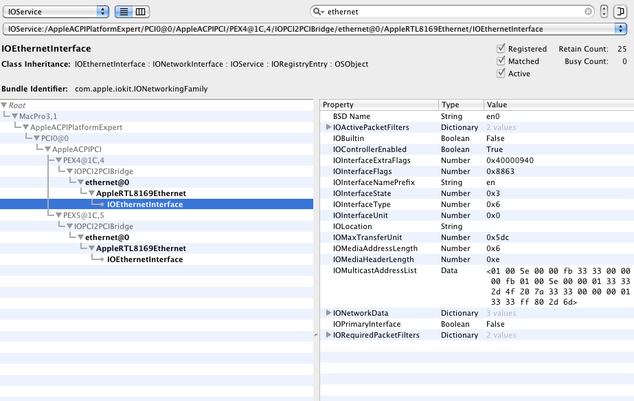

Gringo Vermelho Posted September 8, 2011 Share Posted September 8, 2011 Your DSDT is already patched. Who patched it? I've added the "time machine fix" to both PEX4 and PEX5 (see ioreg screenshot) devices and fixed some compiling errors:dsdt.aml.zip Let me know if it works. Remember to delete networkinterfaces.plist before rebooting! Link to comment Share on other sites More sharing options...
