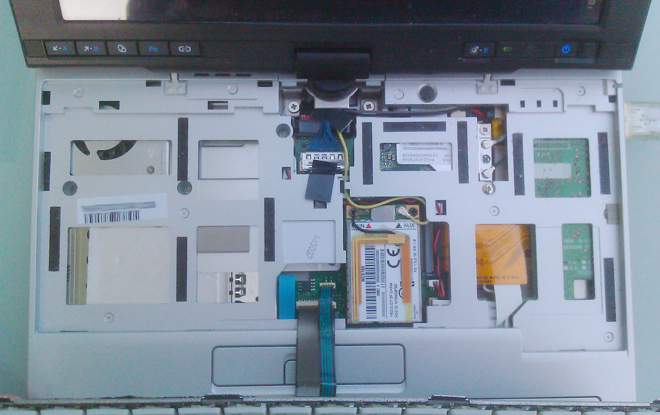

TRJS Posted April 16, 2011 Share Posted April 16, 2011 Quick update on the GPS function of the HSPA-modem: It really works - when using for example a long WLAN-antenna cable hanging out of the laptop... Actually even when switching the cable of the internal antenna of the HSPA-modem with the ones of the WLAN-card makes the HSPA-modem catching a few satellites, but unfortunately not enough for getting a fix. It would be perfect if you could use a very good antenna plugged into the secondary antenna connector - too bad the internal antennas are not good enough. Link to comment Share on other sites More sharing options...

TRJS Posted May 15, 2011 Share Posted May 15, 2011 Success on making GPS work: I installed a U-shaped antenna (see attached picture) that's obviously got a better reception than the first antenna I tried. The new antenna has to be attached to the main plug and the original internal antenna cable to the auxiliary plug, though, which causes the quality of the UMTS reception to drop significantly. It's still usable with reception most of the time, but with this solution you have to choose: either to have very good UMTS reception and no GPS or GPS and weaker UMTS reception... But hey, now I've got GPS, how cool's that? (Even though I don't know for what I might use it...) On the attached picture you can also see a bit of the internals of the P1620: UMTS-card in the middle (with the U-shaped antenna installed on top of the card) and the WiFi-card on the top right side. Link to comment Share on other sites More sharing options...
