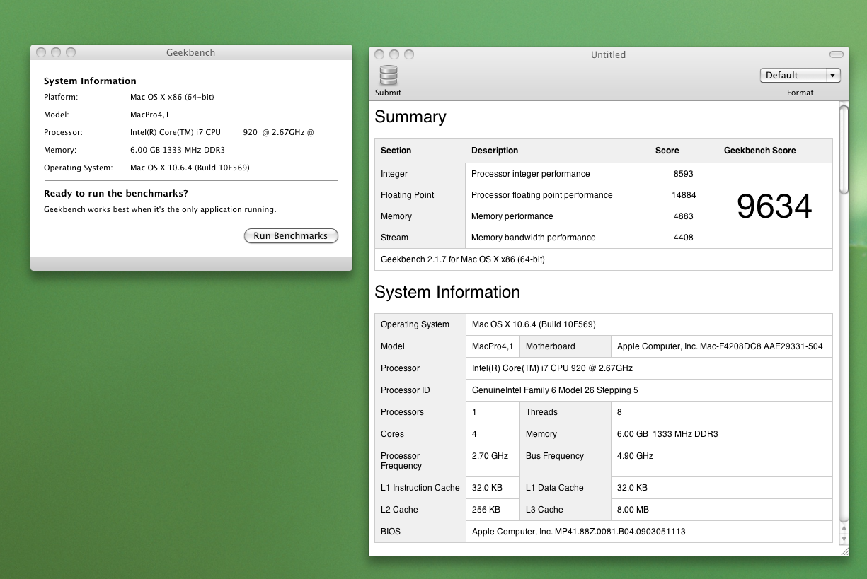

EDIT: Performance in geekbench is pretty good after installing the drivers!
