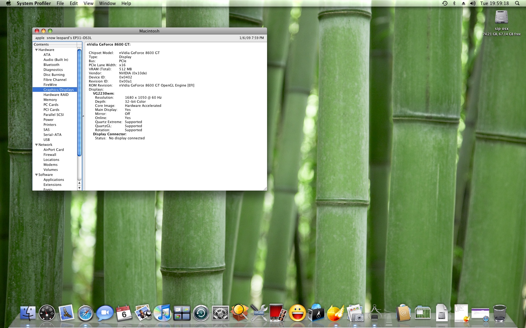

johnjigz Posted January 12, 2009 Share Posted January 12, 2009 @leokeren, what exactly did you do with those programs?? i have the same card looking to get my vga out working properly (without blank screen / crashing). how would i go about changing the rom revision? this is what i'm seeing: Chipset Model: Graphics by NVIDIA Type: Display Bus: PCIe PCIe Lane Width: x16 VRAM (Total): 512 MB Vendor: NVIDIA (0x10de) Device ID: 0x0407 Revision ID: 0x00a1 ROM Revision: NVinjectGo 0.2.0 Link to comment https://www.insanelymac.com/forum/topic/110488-nvidia-8600m-gt-vga-rgb-video-out-working-nvinstaller-v41-v52/#findComment-1038601 Share on other sites More sharing options...
