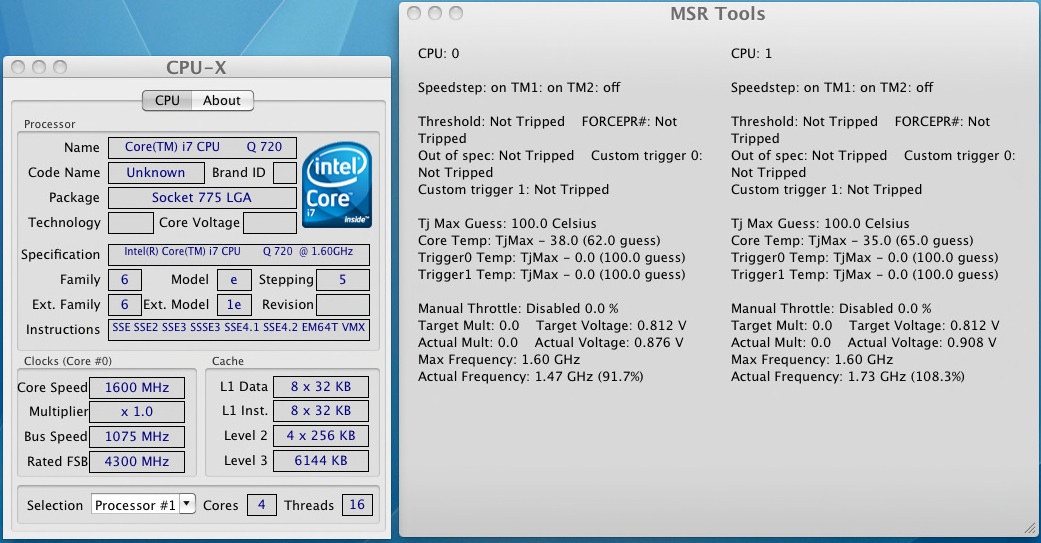

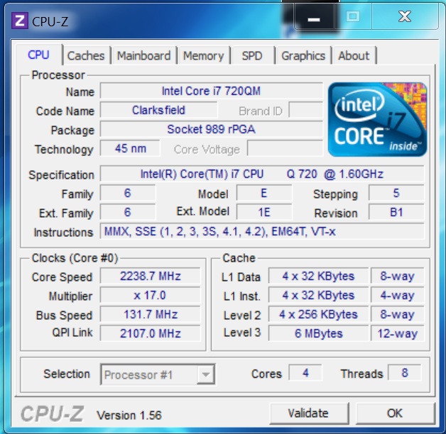

night_mare007 Posted June 4, 2011 Share Posted June 4, 2011 Hello, I have i7 720QM. As long as I can remember my snow, no matter what, I get a corrupt CPU values read using CPU-X: - 16 thread instead of 8 - 1075Mhz BUS SPEED instead of 133 Mhz - x1 Multiplier instead of the normal x12 or any higher value under load with Windows 7..... The problem exist with and without boot options like CPUS=4, BUSRATIO=12, FSB=133. I'd tried many combinations and every time it's just worst then the auto scanning of the chameleon it self. I think even I got SpeedStep working under this weird values... Moreover, when I load iPC 10.5.6 boot cd - the values are OK ! ( BusSpeed is 133, multiplier is 12... ) Maybe its something to do with smbios.plist / Chameleon bootloader ( tried many rev and no change ) / Boot switches ? I attach CPU-Z from windows 7 ( which is 100% alright ) and CPU-X & MSR-TOOL from OSX 10.6.7 (without any special boot switches)... WHAT IS WRONGS ?! WHY ARE THOSE VALUE AREN"T RIGH"T ? Link to comment https://www.insanelymac.com/forum/topic/258517-solved-i7-busspeed-multiplier-problem/ Share on other sites More sharing options...

night_mare007 Posted June 5, 2011 Author Share Posted June 5, 2011 So... as I suspected it had something to do with Chameleon bootloader and its version. I've post a "Issue" under one of the developer's site and he comment about my current v2 RC5 Rev 921 that: your bdmesg shows everything fine. The cpu part and the SMBIOS part.i dont' think you truly have a problem. YIPI !!! He also stated that: CPU-X and MSRTools are not reliable, please check your bdmesg. So i've download one of the "Compiled binaries for manual install" from our forum's "Chameleon 2 RC5 Unofficial thread", and then I "Copy the the executable bdmesg into /usr/sbin for the Boot dump tool" (as wrote in that thread ) and run that command using Terminal. This BMESG apparently one of the only TRUE way to get CORRECT CPU values ! (While CPU-X & MSRTools AREN'T ALWAYS precise !!!) So right now I have the correct BusSpeed&Multipier and also got back my SLEEP feature fully working !! ;) All's Well That Ends Well... Link to comment https://www.insanelymac.com/forum/topic/258517-solved-i7-busspeed-multiplier-problem/#findComment-1693341 Share on other sites More sharing options...
