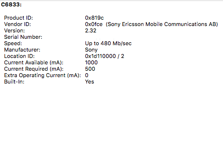

Adam55 Posted January 20, 2016 Share Posted January 20, 2016 Hi kishine, After running some tests I came with results: * SD is not working (The VoodooSDHC is not working for me) * I still have to use the NullCPUPowerManagement * When I attach some USB disks they all show as internal * The previous AppleHDA provided by you stopped working after updating to 10.11.3 so I replaced it with newer VoodooHDA, seems that it hasn't got the kernel panic on boot problem. * There isn't any solution for sleep issues. * WiFi is not working. * I think HDMI audio is working (at least it is as option in Sound output) * I haven't tested other functionalities but I think that nothing else have been improved. Config and DSDT: Clover.zip Link to comment Share on other sites More sharing options...
kishine Posted January 20, 2016 Share Posted January 20, 2016 Hi kishine, After running some tests I came with results: * SD is not working (The VoodooSDHC is not working for me) * I still have to use the NullCPUPowerManagement * When I attach some USB disks they all show as internal * The previous AppleHDA provided by you stopped working after updating to 10.11.3 so I replaced it with newer VoodooHDA, seems that it hasn't got the kernel panic on boot problem. * There isn't any solution for sleep issues. * WiFi is not working. * I think HDMI audio is working (at least it is as option in Sound output) * I haven't tested other functionalities but I think that nothing else have been improved. Config and DSDT: Hi Adam55, * SD is not working (The VoodooSDHC is not working for me) - Same here, I have no plan in using it at this moment. Check in the last link I gave, I think Ocelas had it working. At 10.11.3, maybe updated kext is needed. * I still have to use the NullCPUPowerManagement - As you have said, it is an Apple kext issue. * When I attach some USB disks they all show as internal - I am not using El Capitan. Last time I checked during the Christmas Break on 10.11.2, my usb2.0 is getting recognized properly. * The previous AppleHDA provided by you stopped working after updating to 10.11.3 so I replaced it with newer VoodooHDA, seems that it hasn't got the kernel panic on boot problem. - Check Mirone's latest AppleHDA patch. I read it somewhere here. Just look for it. * There isn't any solution for sleep issues. * WiFi is not working. - I had mine working before I replaced it with Broadcom. I lost my note on this, sorry you have to research this on your own for now. The earliest I can play/upgrade my laptop is on March Break. I am currently using it and can't play with it. * I think HDMI audio is working (at least it is as option in Sound output) - cool * I haven't tested other functionalities but I think that nothing else have been improved. - For me, Yosemite is running great. It is up to you if you want a bleeding edge machine. Good luck kishine Link to comment Share on other sites More sharing options...
Adam55 Posted January 21, 2016 Share Posted January 21, 2016 Hi Adam55, * SD is not working (The VoodooSDHC is not working for me) - Same here, I have no plan in using it at this moment. Check in the last link I gave, I think Ocelas had it working. At 10.11.3, maybe updated kext is needed. * I still have to use the NullCPUPowerManagement - As you have said, it is an Apple kext issue. * When I attach some USB disks they all show as internal - I am not using El Capitan. Last time I checked during the Christmas Break on 10.11.2, my usb2.0 is getting recognized properly. * The previous AppleHDA provided by you stopped working after updating to 10.11.3 so I replaced it with newer VoodooHDA, seems that it hasn't got the kernel panic on boot problem. - Check Mirone's latest AppleHDA patch. I read it somewhere here. Just look for it. * There isn't any solution for sleep issues. * WiFi is not working. - I had mine working before I replaced it with Broadcom. I lost my note on this, sorry you have to research this on your own for now. The earliest I can play/upgrade my laptop is on March Break. I am currently using it and can't play with it. * I think HDMI audio is working (at least it is as option in Sound output) - cool * I haven't tested other functionalities but I think that nothing else have been improved. - For me, Yosemite is running great. It is up to you if you want a bleeding edge machine. Good luck kishine Thanks kishine, I checked the USB on 10.11.1, .2 and .3 and it is shown as internal on all versions. I patched the AppleHDA using patch-hda.pl it works better than Voodoo. I tried Ocelot's VoodooSDHC on 11.2 and 11.3 and it isn't working for me. Update: I found out that when I go into information about battery it displays weird values: When I go to USB on every device flag Built-in is Yes: Link to comment Share on other sites More sharing options...

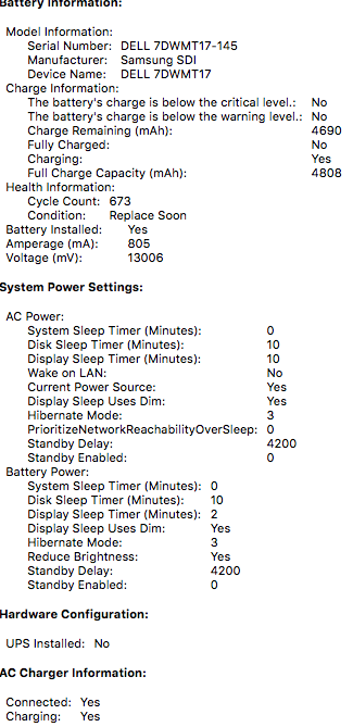

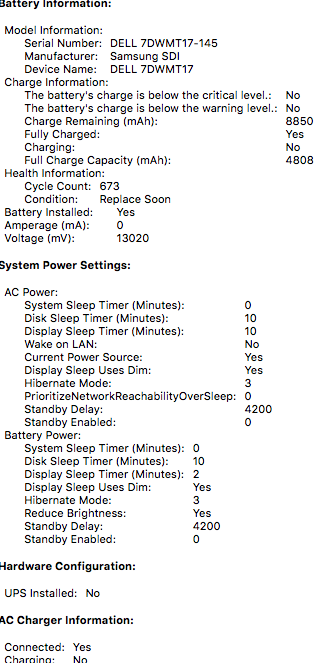

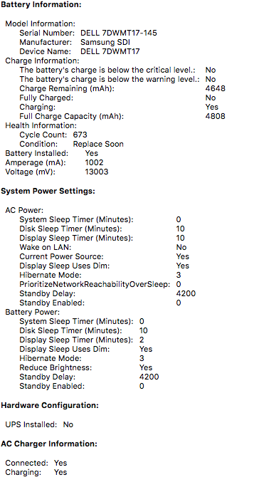

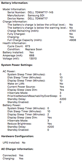

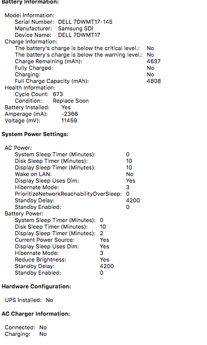

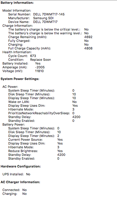

kishine Posted January 24, 2016 Share Posted January 24, 2016 Hi Adam55, Good job in making your audio work better. For the battery info: if you are particular about the mAh, google "Yosemite on Dell M6600...a bit of help kapone". In the thread (not in the google result), check page 2 onward. If you want to dive deep into the code, check ECG9 and ECG6 methods in your DSDT. Compare it to the DSDT methods (attached file) on the link below: http://www.insanelymac.com/forum/topic/307740-need-help-install-yosemite-on-dell-precision-m6600/page-2?do=findComment&comment=2201404 For the USB ... I really want to help you, but I am really hard pressed on something right now. However, I remember some laptops had this issue in Yosemite as well. Look into those thread to get some idea. Nice progress kishine, Note: it is really great that you were able to fix your AppleHDA.kext. It would be great too if you upload your AppleHDA kext here - for future reference. Link to comment Share on other sites More sharing options...
