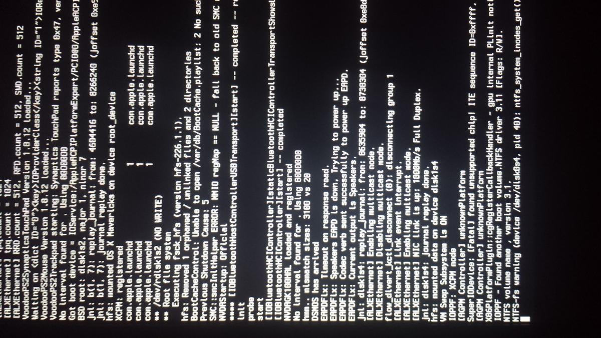

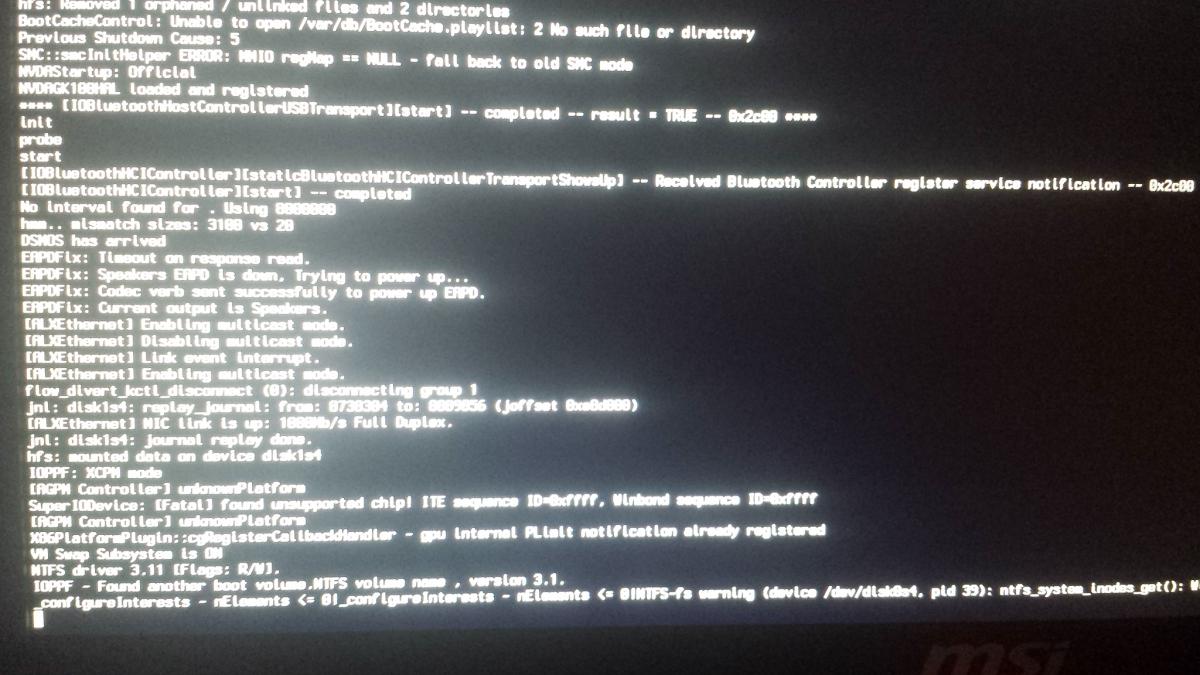

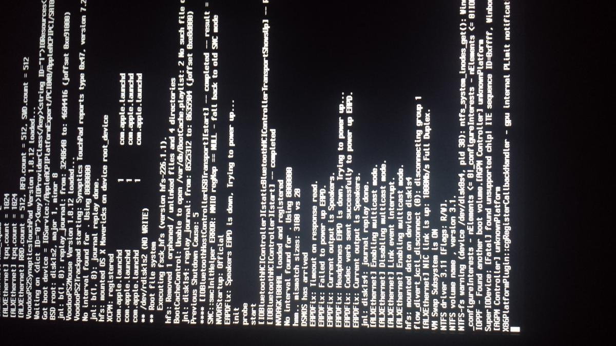

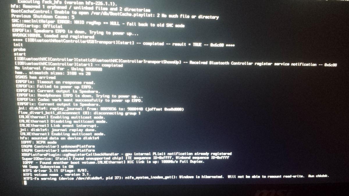

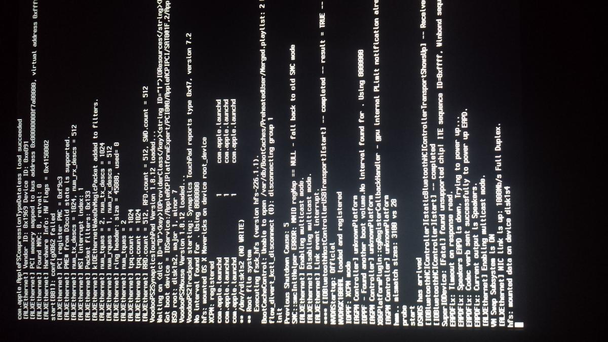

IIIdefconIII Posted August 19, 2014 Share Posted August 19, 2014 Hi guys, i have this problem. I installed osx and tuned it so its working i have full ci/qe everything works exacpt.If i remove the ac adapter and try to boot with only the battery it doesn't boot. I tried to boot 10 times without caches. Didn't work. As soon as i reconnect the AC adapter and boot it works again. Seems its not loading the gfx cause the system doesn't freeze (can still use caps lock light on/off) This are the different pictures of where it stopped loading without ac adapter, any idea? greet Thomas also uploaded my efi files config etc... Here https://www.sendspace.com/file/ii3ik0 Link to comment Share on other sites More sharing options...
IIIdefconIII Posted August 19, 2014 Author Share Posted August 19, 2014 Solved with nvidia_disable=1 and dart=0 nv_disable=1 did the tick dart=0 not needed Link to comment Share on other sites More sharing options...
