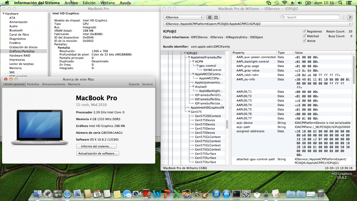

Hi, now this is the result but still see the little problem (a bit pixelated image). But we already have the correct resolution and QE enabled through the main monitor.
I'm using all kexts from this post: http://www.insanelym...el-hd-graphics/
Natit.kext posted in the same post: Natit.kext.zip
And ML AppleIntelHDGraphicsFB (SingleLink). AppleIntelHDGraphicsFB_ML_Fixed.zip
My Laptop:
Core i3 370M 2.40 GHz
Intel HD Graphics 0046:8086, Rev 002 (Arrandale)
Display Native Resolution: 1366x768
Regards.
Many thanks to
verteks.

I have tried your fix. I did this on Mountain Lion 10.8.2 Here are my tests:
Test 1:
Original AppleIntelHDGraphics.kext (10.8.2)
AppleIntelHDGraphicsFB.kext (SingleLink)/(DualLink)
AppleIntelHDGraphicsGLDriver.bundle
AppleIntelHDGraphicsVADriver.bundle
AppleIntelHDGraphicsGA.bundle
Natit.kext
Computer Freezes
Test 2:
MLDP2AppleIntelHDGraphics.kext
Natit.kext
Computer Freezes
Test 3:
Natit.kext
Pixelated screen
Test 4:
AppleIntelHDGraphicsFB.kext (DualLink)
Natit.kext
Black screen
This is actually a step in the right direction. Test 3 tells us that using SingleLink will load the framebuffer and give us a pixelated screen. Also, the internal display gets detected successfully and other resolutions are available.
However I was not able to achieve Quartz Extreme in none of these. I'm not sure why unless because my computer froze.
Here is a picture of how it looks like:
Attached File  FBPix.JPG   129.82KB   92 downloads

ML 10.8.2 kext loaded and i have QE/CI and my native resolution 1366x768
But it still a bit pixelated image.
Posted Image

I am using MacBookPro6,1, but I've applied a patch to the kext I'm using. The ones I've posted here do not have this patch applied. The kext uses a different os-info structure depending on the model name. The 4th byte of the os-info structure contains the ORed value of the connectors (0x01 = LVDS, 0x04 = VGA, 0x10 = DisplayPort). The MBP6,1 and MBP6,2 os-info has the value 0x11, which means LVDS + DisplayPort. I think if you don't have a monitor attached to DisplayPort, it may cause it to hang.
See if this one fixes the pixelated image.
Hello, Good news.
I confirm now we have correct image and QE/CI enabled in our main monitor.
My Notebook:
Intel HD Graphics 0046:8086 Rev 002 (1366x768)
SMBios: MacBookPro6,2
DSDT Graphics Fix (NO)
Natit.kext (Attached)
AppleIntelHDGraphics.kext and AppleIntelHDGraphicsFB.kext (Attached)
AppleIntelHDGraphicsGA.plugin (10.8.2)
AppleIntelHDGraphicsVADriver.bundle (10.8.2)
AppleIntelHDGraphicsGLDriver.bundle (10.8.2)
Resolution Module (YES)
Thanks verteks!!

Awesome work verteks!
Got full QE/CI, native resolution and no pixelated image anymore!
Posted Image
