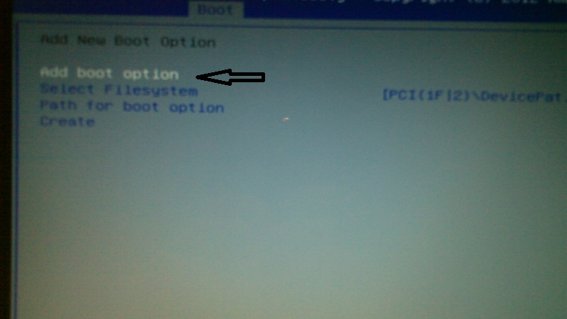

Installation with USB stick no problem, booting into desktop through USB no problem.  Adding bootloader to disk...problem.  Only get logo and no spinning wheel.   I think is cause the bios doesn’t see the hard disk to boot from. I don’t see as a boot option.
I’m thinking has to do with partition scheme?.. Is bios only interested in MBR scheme? Laptop has this aptio ami bios UEFI.  Is this my main issue?
Core spec is ivy bridge i5 3210m with 4000HD graphics.
Questions:
Does anyone know how to make this bios see the new disk..  see pic it may allow me to add a boot file?? Don’t know how to make it see location of the bootloader.
If no can do , I’m fine booting from usb then to desktop. Is there a way I can install kext to get things to work and possibly enable the HD4000 graphics? Doesn’t recognize it now.
Can I install a working ML on the USB and have a dual boot with Win8 by putting back the hard disk?  Im guessing not if bios is only interested in MBR scheme...
thanks for any help or suggestions, and sorry if questions are dumb. Im not an expert in this but exciting to learn.

I configured that model ASUS. The bios does not recognize a GUID HD, must be MBR. You have two solutions: use GUID for Mac and boot from a MBR USB drive or install Mac OS on an MBR drive. I chose to install Mac OS to an MBR drive by cloning an existing 10.8 install to the HD. I then connected the target HD to the Mac via an external USB case to get the Chameleon bootloader to install properly (Boot 0 error otherwise).
There is an EFI string (found in the Intel graphic forum on this site) which can be added to the org.chameleon.boot.plist to give proper functioning HD4000 graphics. In the Ethernet section is a kext that will get the builtin ethernet to work and you need to add PID and VID to the Atheros40 kext to get WiFi working.

I don't mean to revive an old thread, but there is some information here that is incorrect. I intend to correct it as this thread is the no 1 Google result for "k55a clover method" and I don't want future readers misled.
The ASUS K55A does not have a BIOS. It is a pure UEFI implementation with a Compatibility Support Module (CSM).
It can read GPT disks just fine, and in fact, the stock Windows 8 image is installed in EFI mode and the drive formatted to GPT.
The limitation here (and I don't know if this is true for every UEFI machine [someone feel free to confirm]) is that the UEFI on this machine can only read FAT32 partitions. It will not read anything else, including NTFS (Windows Filesystem) and HFS+ (Mac Filesystem). Windows boots just fine because there is a small 100MB-350MB helper partition that is formatted to FAT32. This partition contains the NT bootloader which is capable of reading other filesystems including NTFS.
The reason you can't boot from USB Mac installer is the same. The partition is formatted to HFS+ which is unreadable by the UEFI. All you have to do to work around this is create a separate fat32 partition and install your bootloader of choice. I'm currently experimenting with Clover EFI as I hope to install all my OS in EFI mode.
