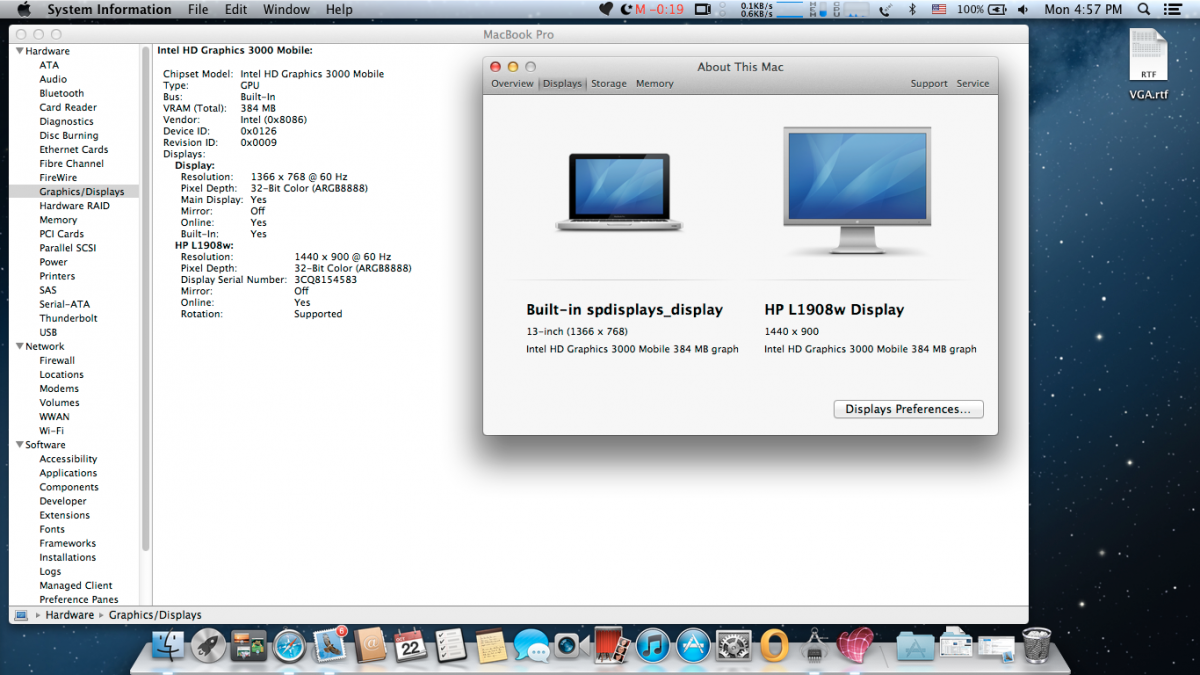

Biso007 Posted September 25, 2012 Share Posted September 25, 2012 Specs: Core i7-2640M Sandy Bridge 2.79 GHz + Intel HD3000 (0x0126) + 4 GB Ram (Geekbench64 score: 7226) - I used USB flash drive and the retail ML 10.8.0 DMG to install on a partition on the same HDD with Windows 7 (Dual booting through Chameleon). - Optionally: if your HDD is partitioned as MBR scheme you may need to patch your installer before beginning [attached]. - To avoid boot problems, from the installer: - Delete all AppleIntelHD* kexts from /S/L/E. - Copy ApplePS2Controller.kext to /S/L/E or you will not be able to type during the initial setup. - Add FakeSMC.kext, AppleACPIPlatform.kext and NullCPUPowerManagement.kext to /S/L/E - After initial boot, you will get VGA resolution only. You need to update your system to 10.8.2 to get QE/CI and native resolution. - To connect to internet, you need to install the AppleIntelE1000e.kext [attached] to use the integrated Ethernet card. - Use Chameleon Wizard to configure your boot.plist file and use the pre-made SMBios for Mac Book Pro 8.1 to recognize the HD3000 GPU. - To enable VGA external monitor use the attached AppleIntelSNBGraphicsFB.kext (Credit to bcc9 for the patching details). - Audio can be enabled with VoodooHDA 2.5 [attached] or a higher version (latest is 2.7.4). - To enable trackpad features, install VoodooPS2Controller from here and remove ApplePS2Controller or any other PS2 kexts. - To enable power management and speedstep, install the attached AICPM.zip: - AppleIntelCPUPowerManagement.kext in /S/L/E (delete NullCPUPowerManagement if installed). - DSDT in /Extra (if you use your own DSDT, only HPET device methods are patched). - SSDT.aml in /Extra (it's same as SSDT-4 table if extracted from H/W). - To use the internal GSM HSPA modem: - Unarchive and put the attached Sony Ericsson scripts in /library/modem scripts - in Network Preferences, select the Advanced tab of the HP hs2340 modem. - Select the vendor as "Other" and select one of the scripts (CID 3 worked for me). - Go back to the main page and type the APN in the Telephone number field. - Apply and connect. Remaining issues: - The integrated Wifi can't be used (no available kext). - The trackpad can be used as a mouse only (no multi fingers or gestures so far but working on it). Plz feel free to contribute. Good hack MBR Patch.zip AppleIntelE1000e.kext.zip VoodooHDA(32-64).kext.zip Sony Ericsson GPRS.zip AppleIntelSNBGraphicsFB.kext.zip AICPM.zip Link to comment Share on other sites More sharing options...

Biso007 Posted February 7, 2013 Author Share Posted February 7, 2013 Thanks for the writeup. I am trying to do this with my 8460, but I need a couple pieces of information. 1. What tool did you use to edit your DSDT? I have alot 200+ unresolved objects. Should I just add external declarations for all of them? 2. I am trying to go straight to 10.8.2 should I have any issues? 3. What are your boot.plist options/settings? Thanks! 1. I use DSDT Editor and yes usually I get these mass errors during the first compile. Just google for the text of the 1st error (it's about moving an IF statement into an existing scope) and the rest of errors will be resolved. 2. No issue. 3. only GraphicsEnabler=Yes (make sure to uncheck UseKernelCache or set it to No). Good hack. Link to comment Share on other sites More sharing options...
