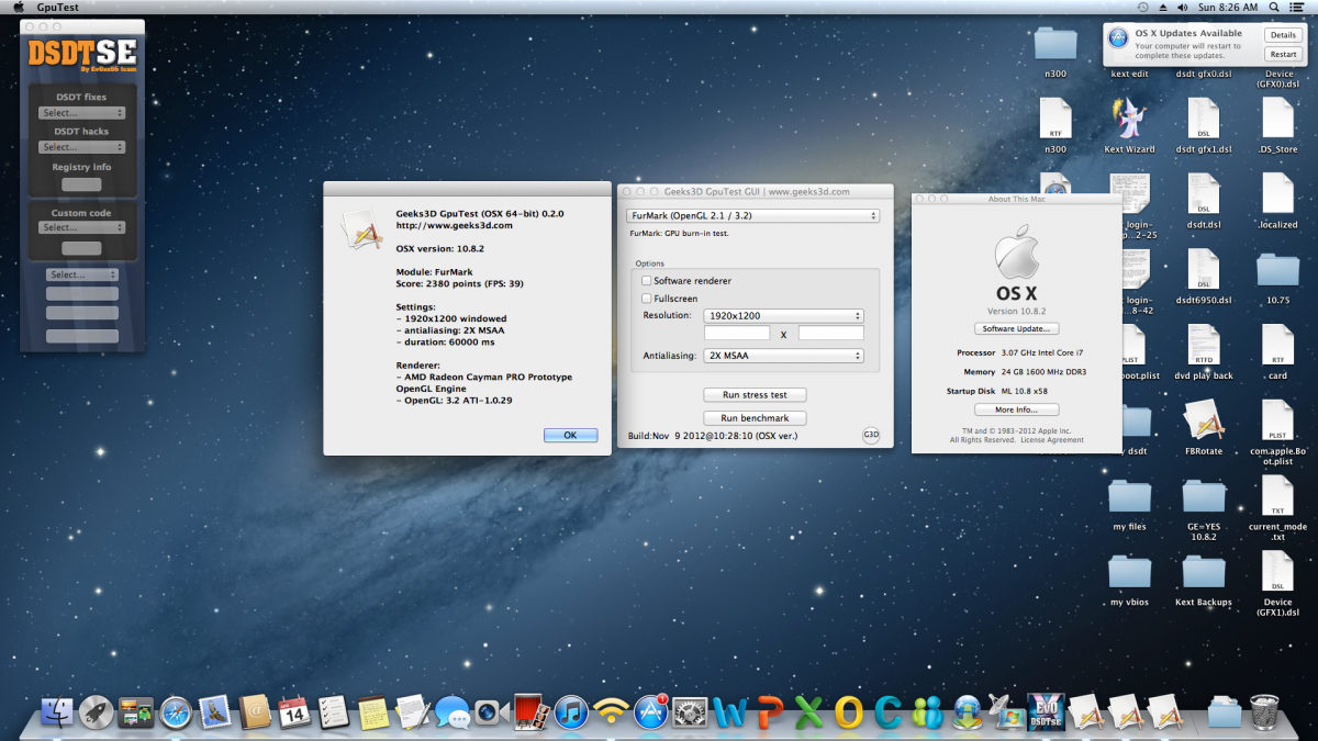

figarotheall Posted April 13, 2013 Share Posted April 13, 2013 AMD dual graphics 6950 supported Hi ALL all credit goes to Netkas/Andy/chameleon team Ermac This 7 kexts support 6950/6970 to mac osx 10.7.x and 10.8 just install via kext wizard. before install delete Amdraden kexts. AMDRadeonAccelerator.kext After install kexts set GraphicsEnabler=Yes. MY dual cards works v.well. more info look my ioreg files. Allso windows7 supported crossfire All but 2 monitors must be connected to the DP ports on the AMD graphics card, and be able to support the required resolution. The 2 exceptions can be connected to the DVI or HDMI ports. The monitors connected to the DP ports can be connected with DP cables, or using AMDrecommended active adapters to DVI or HDMI ports on the monitors. Where multiple graphics adapters are installed, Eyefinity groups cannot span across multiple adapters. With cross-fire enabled, only monitors connected to the primary card will be enabled. NOTE-10.8 dp4 this kexts not 100%support. http://www.mediafire...yg175ou2sqt52z3 Hi, I has installed yours 7 kext and ML 10.8.2 goes well (1080p) but without hardware acceleration. So I has installed the other 3 oleg's kext but I has gray screen without cursor...How can I enable hardware acceleration?? thanks a lot! Link to comment Share on other sites More sharing options...

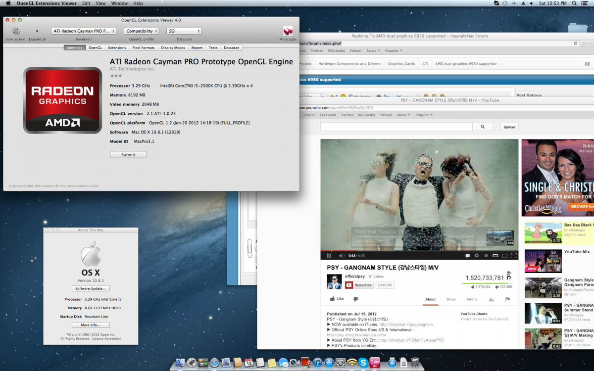

0o0 Posted April 14, 2013 Share Posted April 14, 2013 Success! 6950 with acceleration on 10.8.1. using the kext attached. no dsdt. Booting with wired plugged ino 6950. No SCreen until its gotten into mac. which is fine by me. using dsdt for motherboard but thats for other stuff. Kexts : http://www.filedropper.com/atihd6950 Good luck people. Link to comment Share on other sites More sharing options...
