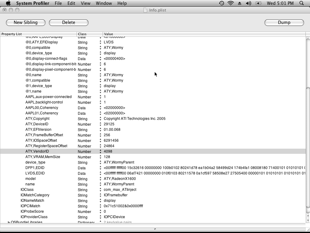

Guest cmad Posted May 13, 2009 Share Posted May 13, 2009 You need a ATINDRV.kext from Tiger (version 1.4.32 works fine here), it's not that hard find it on this forum or elsewhere on internet. And send me the Info.plist you used for ATIinject.kext, I'll check if you haven't missed something. This is my info plist after edid{photo} I didnt find the ATINDRV.kext from Tiger.do u know where i can download it? can u please tell me all the instuctions, commands in terminal? Link to comment Share on other sites More sharing options...
lebidou Posted May 14, 2009 Share Posted May 14, 2009 your plist seems to be good. Just be sure you've put your EDID in LVDS,EDID for your internal panel, not in DFP. I attached the ATINDRV.kext I use. It works fine here with 10.5.7 with my X1900 Mobility, so it would be ok for your X1600. To use it install it with Kexthelper (this one only need google to be found) and reboot. Tell me if you still have trouble. ATINDRV.kext.zip Link to comment Share on other sites More sharing options...
