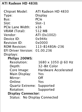

williamcsk Posted July 12, 2009 Share Posted July 12, 2009 Updated on 8-8-2009 Kexts work under 10.5.8. After update(Please refer to proper instructions for updating), you may need to enter single user mode to remove all ATI kext. Instructions for removing original ATI kexts in single user mode: 1. Start up with -s string 2. sudo -s 3. mount -wu / 4. cd /System/Library/Extensions 5. rm -r ATI* 6. rm -r Natit* Updated on 21-7-2009 After playing a little bit more, some more things to note. 1. For DVI/VGA/HDMI 4830 Sapphire card 1.1 Both VGA and DVI port working individually with QE and CI support. But VGA Port do not support wide screen resolution, even using "Granphics Mode" string during boot. 1.2 It is not working for DVI2VGA adapter with this DVI/VGA/HDMI card. 1.3 Once the DVI is working, the VGA port will not work until restart. Therefore, Dual Screen probably won't work. 1.4 Both 800SP and 640SP version work exactly the same. 2. For DVI/S-VIDEO/DVI 4830 Sapphire card 2.1 Working for both DVI port individually. (Reported by joeblowm) Updated on 19-7-2009 Turn out maybe it is better to remove those old drivers before installing new ones. Instructions for removing all ATI Drivers: 1. Open Terminal 2. sudo -s 3. enter your password 4. cd /System/Library/Extensions 5. rm -r ATI* 6. rm -r Natit* If you use PC_EFI V9 or chameleon, you may also need to delete ATI kext from /Extra/Extensions folder. 7. cd /Extra/Extensions 8. rm -r ATI* 9. rm -r Natit* Updated on 18-7-2009 1. New download location added. 2. Kexts also work for ASUS EAH4830 (reported by Xikita). Original posted on 12-7-2009 Hi all, I just got this Sapphire 4830 recently and suffered from makeing it work under OSX. I downloaded a lot of files and no luck for all of them. Since this card got only 1 DVI, so, the dvi2vga hack won't work for it too. After playing arround all those files, install, remove the install again, suddenly, it works!!!! What I have done is like this I believe ( I forgot how exactly I make it, maybe figure it out later). 1. Install 7_radeon_hd_48x0_drivers.pkg from "A Simple guide for 4830.....". 2. Install netkas Patched framebuffers for 48x0 and 3870x2. 3. Install Enabler_for_Nvidia_and_multiple_ATI_cards.pkg from Simple Guide. 4. Install accel pack from another post in this forum, not the one in Simple Guide.(Sorry, I forget which post) 5. Reinstall 7_radeon_hd_48x0_drivers.pkg again.(Don't use Kext Helper to install those files in the pkg, just install using the pkg file. I think this is the part that I do right) 6. Install Natit.kext from 64bit's mod using Kext helper. It's now working with QE/CI, and only the DVI is plugged in. Attached is the link for the files finally I got. Hope it works for every one. http://www.box.net/shared/huzxkdjsxc P.S. May someone using the dvi2vga hack try these files? In order to see do they work without that trick, thanks. Link to comment Share on other sites More sharing options...

joeblowm Posted July 18, 2009 Share Posted July 18, 2009 P.S. May someone using the dvi2vga hack try these files? In order to see do they work without that trick, thanks. Indeed, working much better than the previous hack-up I was using with the DVI in either port and nothing anywhere else (sapphire 4830 512 with dvi-svid-dvi), I'd presume I could probably even use multiple monitors now - I also no longer see waves rolling across my screen very faintly like I did with the old ones I was using before now and notice text seems somewhat clearer. Thanks for sharing your find williamcsk Link to comment Share on other sites More sharing options...
tk0 Posted July 18, 2009 Share Posted July 18, 2009 awesome stuff... this is the closest ive gotten to getting mines (sapphire 4830 hd 512mb dvi-svideo-dvi) ... its show total VRAM (Total):512mb but still no Quartz Extreme any ideas? Link to comment Share on other sites More sharing options...

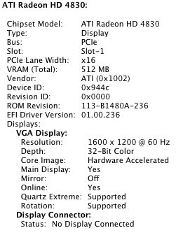

justdohnut Posted July 19, 2009 Share Posted July 19, 2009 Followed the instructions exactly, got an out of frequency error. also tried just installing your files, same deal. I have the same card, Sapphire HD 4830 VGA/HDMI/DVI, but I'm connecting to a VGA monitor, so maybe your method works just for DVI monitors? I tested it on an HDTV as well, just to make sure, I tried both HDMI and DVI and still didn't work. anyone have any ideas how I can solve the out of frequency message? I have to say though, great work, this is the closest I've gotten I think.. all other methods have gotten me the infamous black screen with weird lines. thanks! Link to comment Share on other sites More sharing options...
williamcsk Posted July 19, 2009 Author Share Posted July 19, 2009 awesome stuff... this is the closest ive gotten to getting mines (sapphire 4830 hd 512mb dvi-svideo-dvi) ... its show total VRAM (Total):512mb but still no Quartz Extreme any ideas? According some posts in other forums that QuartzGL should not be loaded under Leopard. You can try to delete all ati drivers before installing those I provided. Hope this help. Instructions for removing all ATI Drivers: 1. Open Terminal 2. sudo -s 3. enter your password 4. cd /System/Library/Extensions 5. rm -r ATI* 6. rm -r Natit* If you use chameleon, you may also need to delete ATI kext from /Extra/Extensions folder. 7. cd /Extra/Extensions 8. rm -r ATI* 9. rm -r Natit* Link to comment Share on other sites More sharing options...
williamcsk Posted July 19, 2009 Author Share Posted July 19, 2009 Followed the instructions exactly, got an out of frequency error. also tried just installing your files, same deal. I have the same card, Sapphire HD 4830 VGA/HDMI/DVI, but I'm connecting to a VGA monitor, so maybe your method works just for DVI monitors? I tested it on an HDTV as well, just to make sure, I tried both HDMI and DVI and still didn't work. anyone have any ideas how I can solve the out of frequency message? I have to say though, great work, this is the closest I've gotten I think.. all other methods have gotten me the infamous black screen with weird lines. thanks! I have just tried my card with only VGA cable. It could not detect the best resolution for my monitor, but it works fully also, just need to manually select the appropriate resolution and frequency. Maybe you could try removing those old drivers first and then try install again. Hope this help. Link to comment Share on other sites More sharing options...

justdohnut Posted July 22, 2009 Share Posted July 22, 2009 Hmm, I tried it again, with the new instructions and still run into the same "Out of Frequency" problem. I tried a widescreen monitor, a non-widescreen monitor, an HDTV, DVI, HDMI, and VGA outputs, and still nothing. I read on another topic, something about openGL framework.. did you ever update that? I don't think I ever messed with that, but maybe it's the reason I can't get mine to work? Also, I updated to 10.5.7, did you as well or are you running a different version? Thanks again for all your help Link to comment Share on other sites More sharing options...

williamcsk Posted July 22, 2009 Author Share Posted July 22, 2009 Hmm, I tried it again, with the new instructions and still run into the same "Out of Frequency" problem. I tried a widescreen monitor, a non-widescreen monitor, an HDTV, DVI, HDMI, and VGA outputs, and still nothing. I read on another topic, something about openGL framework.. did you ever update that? I don't think I ever messed with that, but maybe it's the reason I can't get mine to work? Also, I updated to 10.5.7, did you as well or are you running a different version? Thanks again for all your help I am on retail 10.5.7. P5QL-E, E8500, Saphhire 4830. I think you can turn off QuartzGL by OSX86tools or like these: 1. Open Terminal 2. sudo defaults write /Library/Preferences/com.apple.windowserver QuartzGLEnabled -boolean NO 3. enter your password 4. Restart or log out to see if it's unloaded. I didn't update those files these days. Still figuring out its working behaviour. Link to comment Share on other sites More sharing options...

IceNio Posted July 23, 2009 Share Posted July 23, 2009 I can't get the QE / CI working dunno why , i did exactly the same as above. are you using some other files ? I'm getting 1680x1050 res now cause I bought a dvi-dvi cable and it's ok only i think the edges of the fonts look a lil raw .. it's kinda annoying i'll try some other methods and write to let you know what happened. edit- got everything working with the following : used 64bit's method : 1.drivers 2.his natit via Kext Helper 3.accel files 4.(that's a point FROM ME - 1st DVI - dvi-svideo dongle put in the slot closer to the MB , and on the other DVIport - DVI-DVI cable to the monitor) - that way i got full QE , CI GL support it doesn't say my monitor is connected , but WHO CARES !?!? Thank You all for all of your hard work , making these things possible , the only thing I haven't tried yet is netkas' method it might be working without the dvi-svideo dongle , but i'll leave it for later. Thanks again and good luck ! p.s. forgot - iPC 10.5.6 updated to 10.5.7 , got it working on the 10.5.7 with the DVI-DVI cable. ! Link to comment Share on other sites More sharing options...
williamcsk Posted July 23, 2009 Author Share Posted July 23, 2009 I can't get the QE / CI working dunno why , i did exactly the same as above. are you using some other files ? I'm getting 1680x1050 res now cause I bought a dvi-dvi cable and it's okonly i think the edges of the fonts look a lil raw .. it's kinda annoying i'll try some other methods and write to let you know what happened. At first I also don't have QE/CI after I install 64bit's modded Natit.kext. The card is regonized but not supported by QE/CI. Then I try some other accel files (i.e. those plugin in my zip file) and it works finally. I think the problem is some old drivers left over in you system. You can try to clean out all those ATI*.kext and Natit.kext from Extensions first. Also, remember to clean out those in Extra folders Then finally, when you boot up, use -v -f to rebuild the driver cache. Turn out when I was replying you already get your card working. good for you. Link to comment Share on other sites More sharing options...
