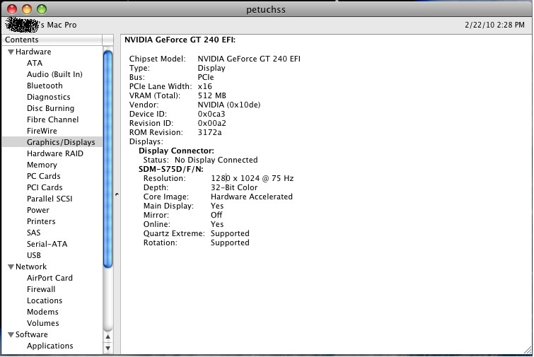

ankas Posted February 22, 2010 Share Posted February 22, 2010 I have "GT240 512M GDDR5 128 from Palit" and make it work for me. My system is iDeneb 10.5.8 . Link to comment https://www.insanelymac.com/forum/topic/198324-nvidia-g-210-gt-220-gt-240-gts-240/#findComment-1415281 Share on other sites More sharing options...
