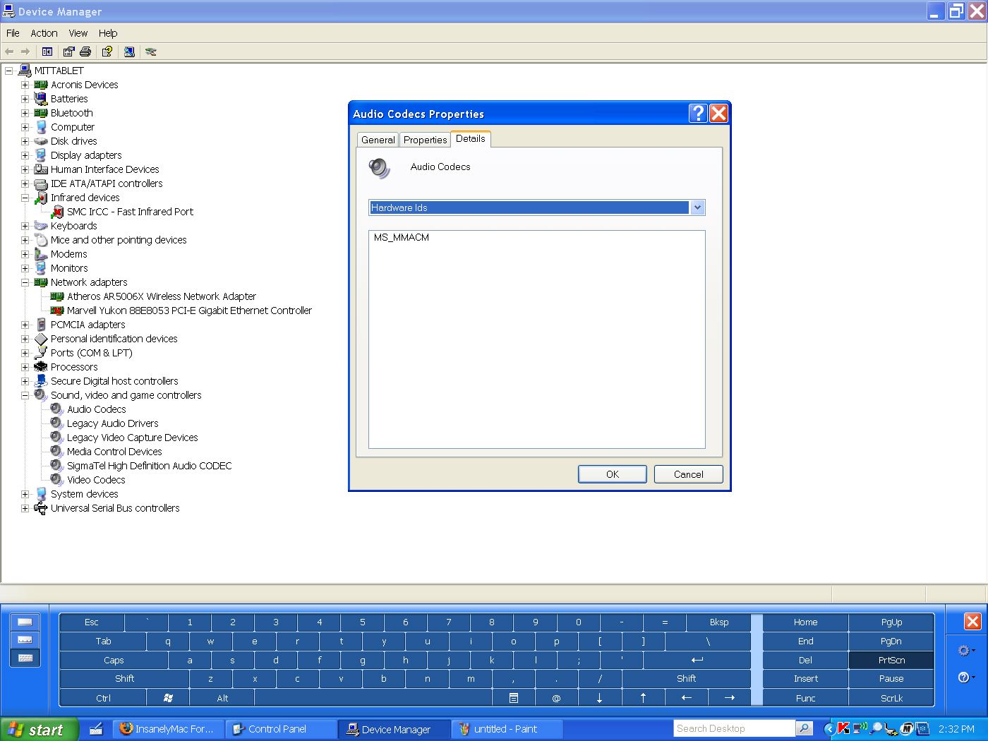

iNoob Posted March 18, 2008 Author Share Posted March 18, 2008 Look for your audio codec in the Device Manager, then doubleclick it, then go to the Details tab, then choose Hardware Identifier from the drop-down menu. Copy and paste the content here. Link to comment https://www.insanelymac.com/forum/topic/87453-problems-with-notebook-speakers/page/2/#findComment-672133 Share on other sites More sharing options...
pianimator Posted March 18, 2008 Share Posted March 18, 2008 Look for your audio codec in the Device Manager, then doubleclick it, then go to the Details tab, then choose Hardware Identifier from the drop-down menu. Copy and paste the content here. The Hardware IDs dropdown menu provides this item: MS_MMACM Thanks. Link to comment https://www.insanelymac.com/forum/topic/87453-problems-with-notebook-speakers/page/2/#findComment-672163 Share on other sites More sharing options...
iNoob Posted March 18, 2008 Author Share Posted March 18, 2008 Take a screenshot of your Device Manager, specifically the multimedia devices section. Link to comment https://www.insanelymac.com/forum/topic/87453-problems-with-notebook-speakers/page/2/#findComment-672203 Share on other sites More sharing options...

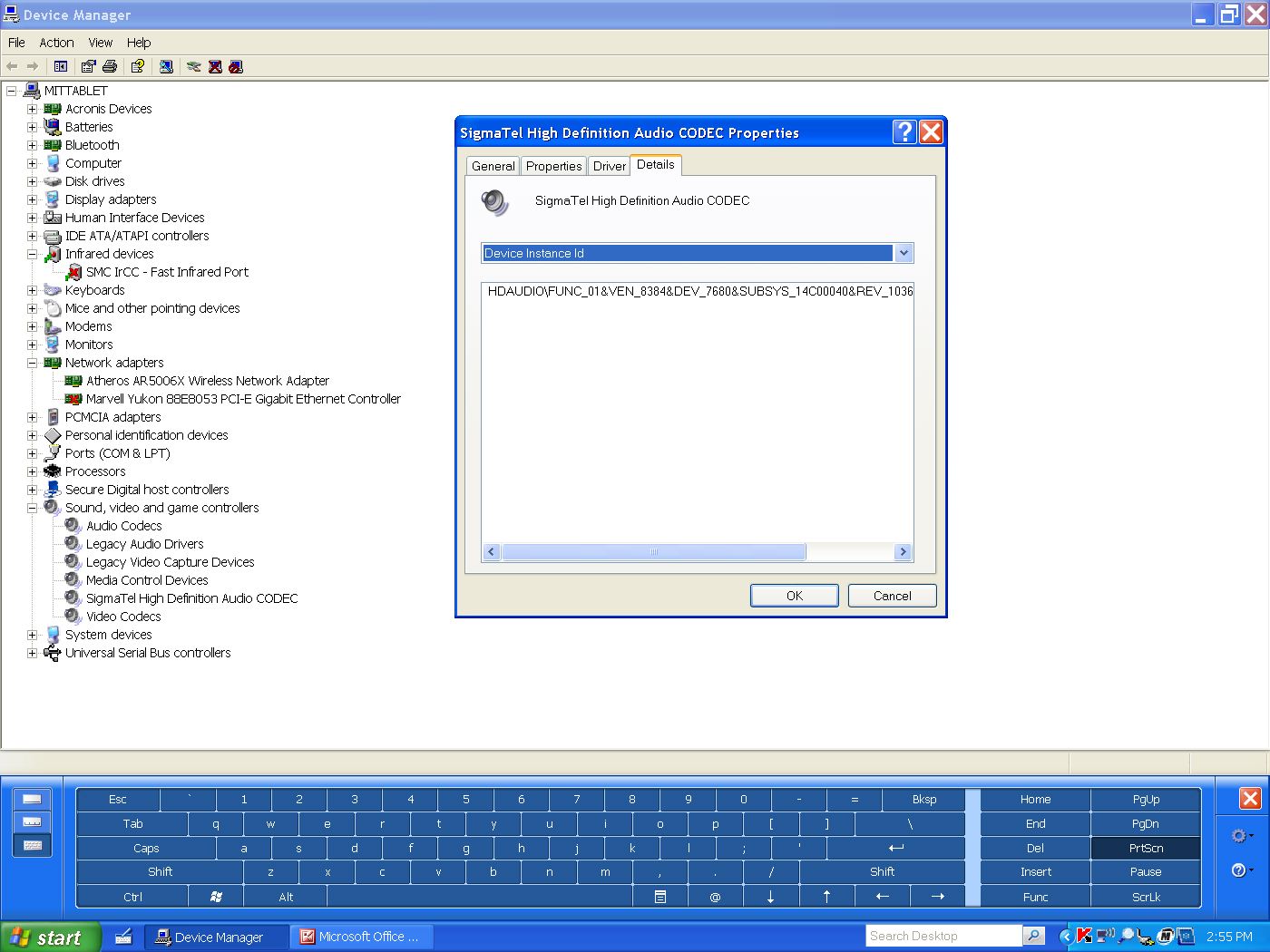

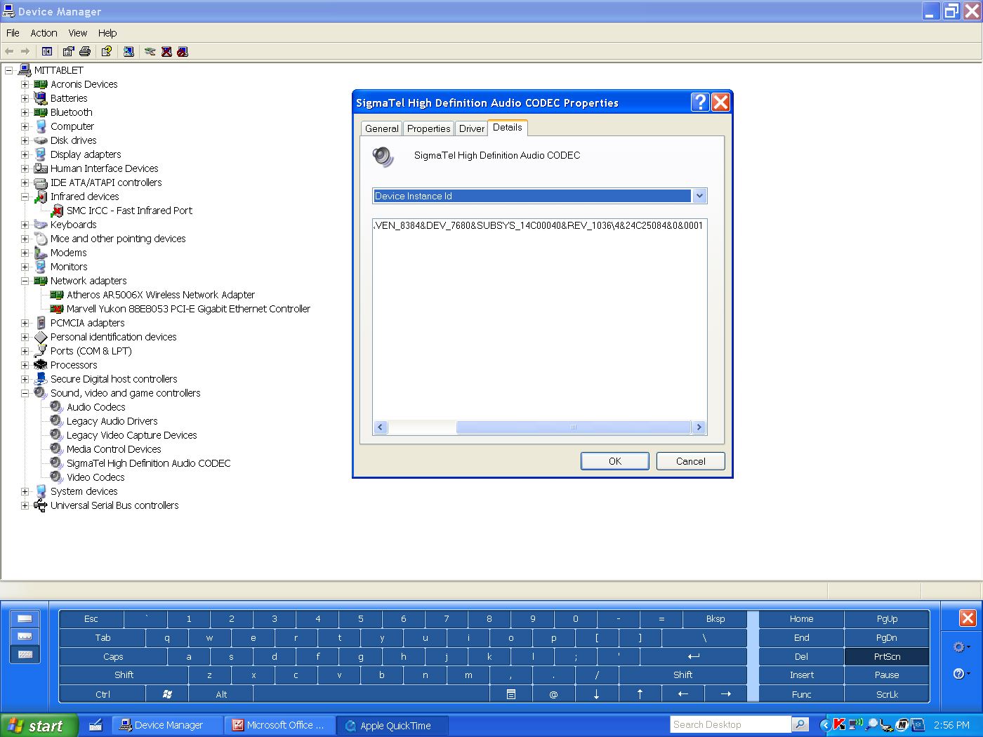

pianimator Posted March 18, 2008 Share Posted March 18, 2008 Take a screenshot of your Device Manager, specifically the multimedia devices section. attached to this post are 3 jpegs. Link to comment https://www.insanelymac.com/forum/topic/87453-problems-with-notebook-speakers/page/2/#findComment-672351 Share on other sites More sharing options...
iNoob Posted March 18, 2008 Author Share Posted March 18, 2008 Oddly enough, your system has the MacBook's audio codec, which is the Sigmatel STAC9221. Link to comment https://www.insanelymac.com/forum/topic/87453-problems-with-notebook-speakers/page/2/#findComment-672373 Share on other sites More sharing options...
