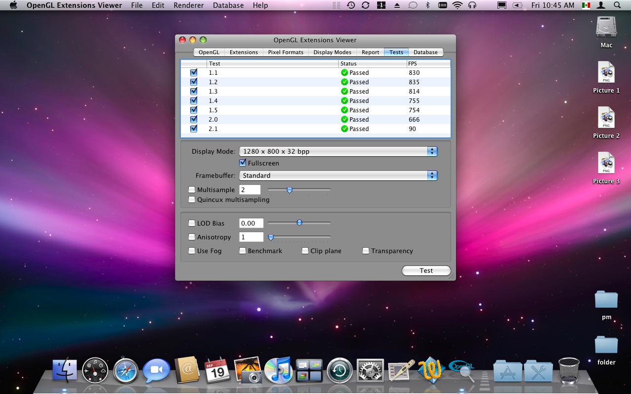

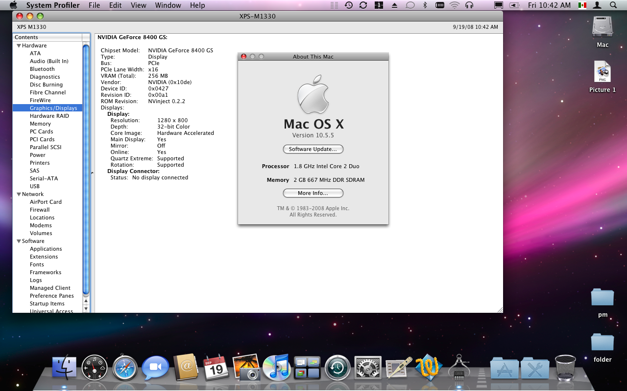

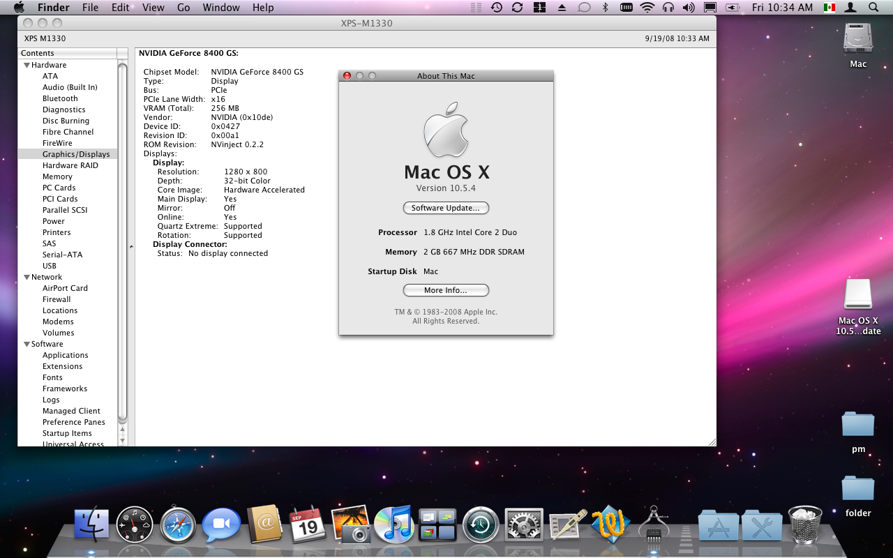

Well that was an incredible way to learn.
For me EFI strings are no longer working for the graphics card, even on 10.4.4 (which does not have new Nvidia kexts, they are 10.5.3), so I use NVinject.
NVinject 0.2.2 from XDarwin installer did the work, even on 10.5.5, but what is better is that with 10.5.5 Nvidia kexts I have better performance on OpenGL, from 400 fps (avg) with my previous installation to 800 fps (avg) with this 10.5.5, like Windows performance, just a note: remember to put the display to sleep, it needs just a second to have the increased performance, before sleep display the performance is very low, like 10% of the performance of after sleep display.
So what I did:
Install of retail 10.5 with DFE boot 132, then update straight to 10.5.4 (with the combo update) but I guess that updating straight to 10.5.5 will work.
If you want to try use this NVinject, is modded for M1330's 8400GS: NVinject.kext.zip
Here are some pics from my recovering:
10.5.4 with NVinject
10.5.5 with NVinject
