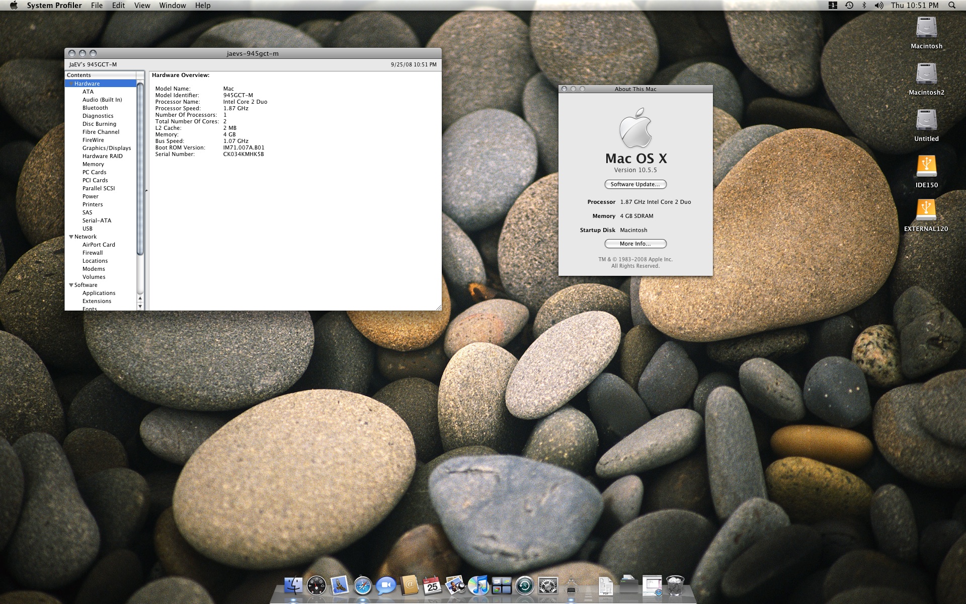

JaE-V Posted September 26, 2008 Share Posted September 26, 2008 I thought the ECS945GCT-M/1333 only supported a total of 2GB RAM but JAe-V has 4GB. The ECS website now says 4GB (in red letters like it was changed). So does this work for the all the 3.0 version boards? Does 4GB require the 2-18-08 BIOS or will it work with the 11-7-07 BIOS? Thanks, Gregg No its supports 4gigs of ram just fine, i'm even using mixed models. Its 800mhz. And i havent been able to boot into an install with anything other than the original bios of 11/7/07. I'm gonna give the modified a shot in a few mins. So great news guys who have the ECS 945GCT-M/1333 version 3.0 board. I successfully modded the bios to get 2 cores enabled with the latest bios (Version: 08/07/18Release Date: 2008/08/28). CREDIT GOES TO ALL THOSE WHO PARTICIPATED IN THIS THREAD: http://forum.insanelymac.com/index.php?showtopic=90505 Disclaimer: Flashing your bios is risky and I assume no responsibility to any damage that may occur. This bios is only for version 3.0 motherboards (ECS 945GCT-M 3.0)! DO NOT FLASH IF U DO NOT HAVE THIS MOTHERBOARD! Good luck to those who try! Hey what processor are you using? 45nm i hope? lol *EDIT* Just informing that i'm up and running with the modified bios. MacMan2007 i'd like to know what if your running vanilla kernel or not? I'm unable to boot running any vanilla kernel unless i flag cpus=1 before this. In the past and presently i had been using both cores with the modbin kernel. Works well, here's a screenshot: Link to comment https://www.insanelymac.com/forum/topic/82928-mostly-successful-leopard-install-on-ecs-945gct-m1333/page/10/#findComment-906482 Share on other sites More sharing options...

MacMan2007 Posted September 26, 2008 Share Posted September 26, 2008 Hey what processor are you using? 45nm i hope? lol *EDIT* Just informing that i'm up and running with the modified bios. MacMan2007 i'd like to know what if your running vanilla kernel or not? I'm unable to boot running any vanilla kernel unless i flag cpus=1 before this. In the past and presently i had been using both cores with the modbin kernel. Works well, here's a screenshot: I'm running a E5200 45nm Wolfdale CPU clocked at 2.5 gighz. I never have to boot with the cpus=1 flag. I'm using original 10.5.5 kernel straight from the update. I do believe all the .kext are vanilla as well. Bios settings are as follows: CPU TM Function: Enabled Max CPUID Value Limit: Disabled Execute Disable Bit: Enabled Intel SpeedStep tech: Disabled Enhanced Halt: Enabled APIC Mode: Enabled <----- Important to enable this because the modification in the bios makes this works now. High Performance Event Timer: Enabled I do boot with the -f flag, so maybe that could be another reason why I don't need to use cpus=1. Link to comment https://www.insanelymac.com/forum/topic/82928-mostly-successful-leopard-install-on-ecs-945gct-m1333/page/10/#findComment-906809 Share on other sites More sharing options...

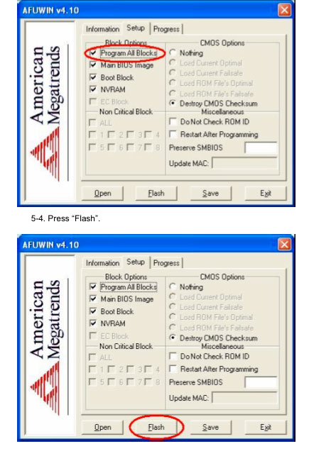

ismaelgualdi3 Posted September 27, 2008 Share Posted September 27, 2008 Release Date: 2008/08/28. Bios settings are as follows: CPU TM Function: Enabled Max CPUID Value Limit: Disabled Execute Disable Bit: Enabled Intel SpeedStep tech: Disabled Enhanced Halt: Enabled APIC Mode: Enabled High Performance Event Timer: Enabled I flash bios to new release and followed your bios settings, but still restart if not write cpus=1 flag. I used the files in ECS website. Should i open your file as rom in afuwin and use it to flash? Or is the same that in ECS web but with your config? Has others changes? Thank you. Link to comment https://www.insanelymac.com/forum/topic/82928-mostly-successful-leopard-install-on-ecs-945gct-m1333/page/10/#findComment-908344 Share on other sites More sharing options...
MacMan2007 Posted September 27, 2008 Share Posted September 27, 2008 I flash bios to new release and followed your bios settings, but still restart if not write cpus=1 flag. I used the files in ECS website. Should i open your file as rom in afuwin and use it to flash? Or is the same that in ECS web but with your config? Has others changes? Thank you. You will need to flash with the bios that I attached to my post. It contains a different DSDT table that allows APIC to work properly under OSX. Please report back if successful. Link to comment https://www.insanelymac.com/forum/topic/82928-mostly-successful-leopard-install-on-ecs-945gct-m1333/page/10/#findComment-908576 Share on other sites More sharing options...
ismaelgualdi3 Posted September 27, 2008 Share Posted September 27, 2008 You will need to flash with the bios that I attached to my post. It contains a different DSDT table that allows APIC to work properly under OSX. Please report back if successful. ok. It is safe? Did you did it? The options in afuwin are like the image i attach? That is the options in the ecs website and what i used always to flash bios. Thank you. Link to comment https://www.insanelymac.com/forum/topic/82928-mostly-successful-leopard-install-on-ecs-945gct-m1333/page/10/#findComment-908723 Share on other sites More sharing options...

JaE-V Posted September 29, 2008 Share Posted September 29, 2008 ok. It is safe? Did you did it? The options in afuwin are like the image i attach? That is the options in the ecs website and what i used always to flash bios. Thank you. I did it with the same utility they give you when you download the bios from ecs and it worked awesome. I couldnt even boot up my leo installation with the unmodified version latest update. My advice to everyone is to grab this bios and an E8400 lol. JaE-V,On a selfish note, I wish you would stick with your current MB so that we could continue to have you around on this thread contributing. Thanks for being helpful... BTW, that update http://forum.insanelymac.com/index.php?showtopic=107340 worked for me. I'm at 10.5.5 the only weird thing I've noticed so far is that in my general hardware section of the system profiler, the screen shows: There was an error while gathering this information. Otherwise, my onboard video is now QE enabled. All that and I'm just waiting for the 9600gso to arrive. Oh and I did have to reapply my mods for the video,sound,and wifi card. After the update... Lol no worries, i'm around! I love these forums. And you had better luck than me with that update. Maybe it was nvinject drivers. When your card gets in try that method i posted to create your own efi string, its really simple. You should be fine with that card I think. I'll write up a simpler guide if need be. Link to comment https://www.insanelymac.com/forum/topic/82928-mostly-successful-leopard-install-on-ecs-945gct-m1333/page/10/#findComment-910328 Share on other sites More sharing options...
ismaelgualdi3 Posted September 30, 2008 Share Posted September 30, 2008 You will need to flash with the bios that I attached to my post. It contains a different DSDT table that allows APIC to work properly under OSX. Please report back if successful. Hi. I installed your modified bios and setup and there is no problem. I had the 07 version with two cores enabled and now bios updated and two cores enabled two (i have an e4600) I recommend this mb to my girlfriend and a E8400, but with 07 bios the FSB was being misread it, and with 08 only one core was enabled. In this days I will install her your bios. Like JaE-V said, this cheap mb, with 4GB RAM and an E8400 is a very good option. Thank you very much. And to JaE-V too. Link to comment https://www.insanelymac.com/forum/topic/82928-mostly-successful-leopard-install-on-ecs-945gct-m1333/page/10/#findComment-912341 Share on other sites More sharing options...
