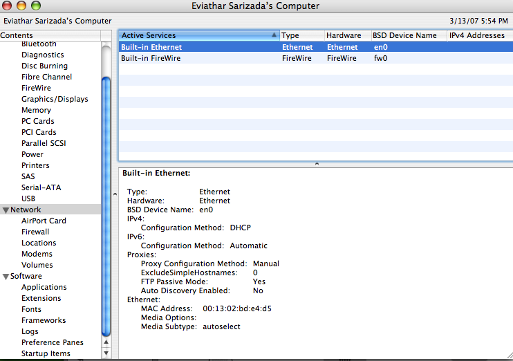

Let me begin by thanking you guys for taking up this task of creating these drivers. I have the intel 3945 and for some reason my wireless card is coming up as Built In Ethenet. The Mac address supplied for built in ethernet correspondes with my wireless card. I have included my logs with this posting. I have a HP 6400 with Jas 10.4.8. It also has a Broadcom 5753M gigabit ethernet built in. Thanks for any help in advance.

OK, now in my system the mac address is right, but my original problem is the same: the card ethernet is riallocate in en1 the 3945 card is configurate as en0 but is not an airport port but like an another ethernet cable card ...

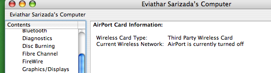

http://iwidarwin.googlecode.com/svn/trunk/...945/iwi3945.dmg
Not certain if the above is supposed to resolve the issue I have of the Airport being off and unable to turn it on.. but I applied the updated release above and there is absolutely no change whatsoever. My Aiport status remains as "OFF"
I assume others have already reported that and have posted the logs. I just wanted to make a note of it that the updated code didn't do squat for me.. :( but the efforts are Sooooooooooo Appreciated!
