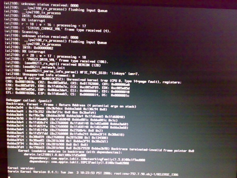

if this crashes please post the picture of the kernel panic
.javi,
can you run a test with the -s option
if i can get a picture of the kernel panic i might find out where it crashes
ttorok,
can you post a picture of the kernel panic you get?

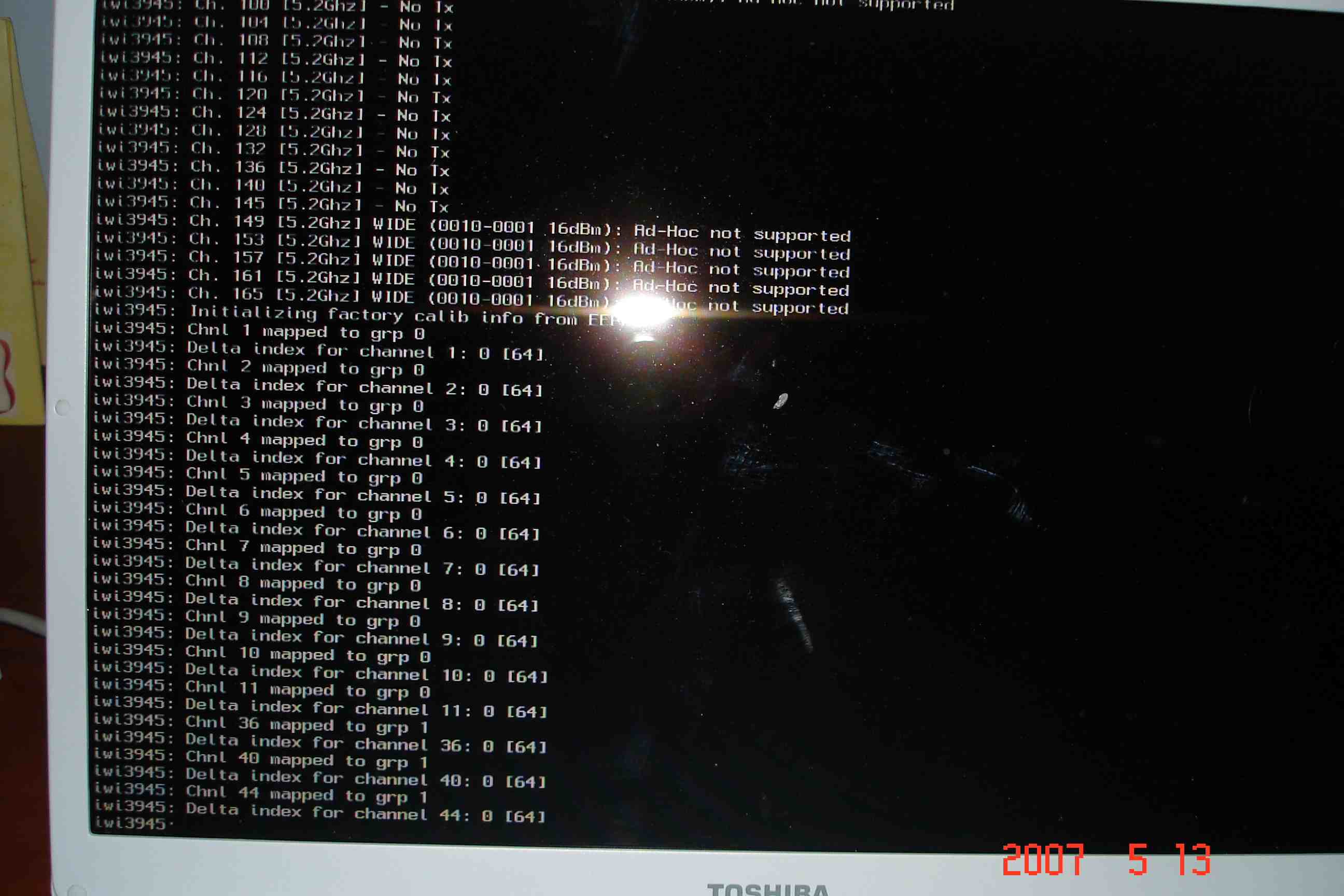

current logs of rev 407 ,iwi3945
boot with -s and call networkSelector, kernel panic after display the end of 3 line below:
Tunable channels: 11 80211bg, 13 80211a channels
ieee80211_register_hwmode
ieee80211_prepare_rates
dmesg.txt
ioreg.txt
system.txt

ttorok,
Yes, picture attached:
PS: a stupid question: how do you mean "call" networkSelector? When I try to run it I got the message: Could not get ID for kernel control. 2.
Thanks.

and about the kernel panic, it happned on the terminal app as well...
it is something in the driver itself, needs more research.

to ttorok, when you have "Could not get ID for kernel control" it means your iwi2100.kext is not loaded into memory yet. you can try to load iwi2100.kext before you run networkSelector. you can use "kextload /System/Library/Extensions/iwi2100.kext" or "sh /etc/rc" I think.
Ok, but when I try to load the kext I get kernel panic so there is no chance to run NS at all...
So at first kext has to be loadable to try NS option 1.
PS: wlan led on my notebook is ON so driver handles my hw but panic stops the process unfortunately.
thanks.

can someone post the picture of the kernel panic tested in a place where there's no networks around to scan/connect?
iwi3945 rev 409
hack in ieee80211_prepare_rates()
Airfly, you should check this
