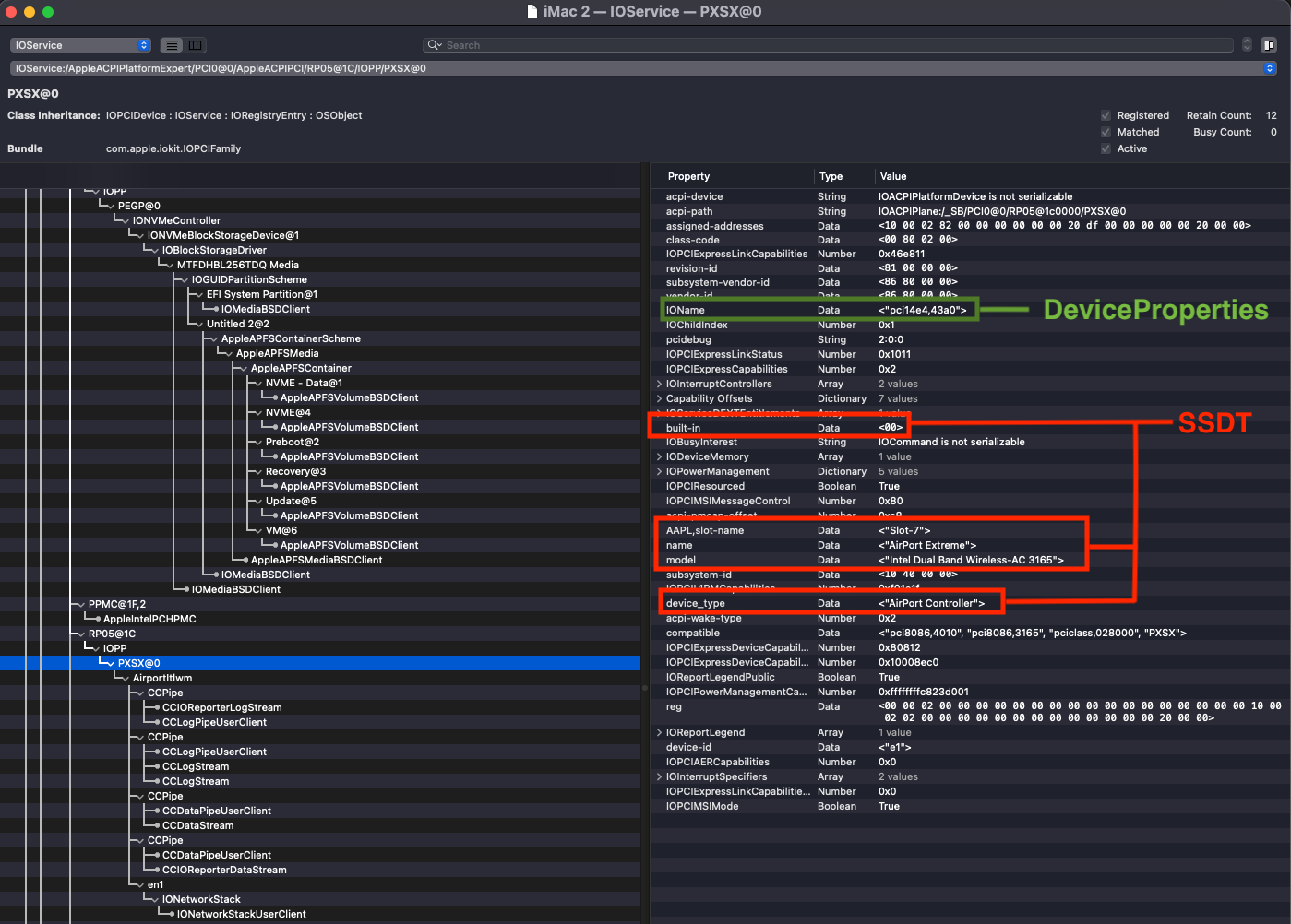

kgp Posted April 14 Share Posted April 14 (edited) 44 minutes ago, kaoskinkae said: Thanks for the clarification. That's why my profile shows the three computers: New, Old1, and Old2 with the Wireless 3165. Therefore, I now know it's impossible and I'll continue using Heliport, which works perfectly. I'm closing this thread and have learned from your explanation. I would not call it impossible. We have seen cases where an Intel 7260 can be brought up with Broadcom BCM94360 spoofing under OCLP. In such setups, what really matters is the correct Broadcom spoofing rather than the original Intel chipset itself. In addition, you need to use AirportItlwm.kext 2.3.0 for Ventura as part of the setup. You can give my guidelines a try and see how far you get. 😉 Take my Intel EFI folder distribution as a baseline and simply follow the respective guidelines. Once you have everything properly set up, feel free to share your EFI folder — I’ll be happy to review it. Further discussions should preferably take place in the Experimental Fork thread, not here in the 26.5 beta thread. Edited April 14 by kgp 4 Link to comment https://www.insanelymac.com/forum/topic/362589-pre-release-macos-tahoe-265/page/4/#findComment-2849131 Share on other sites More sharing options...
kaoskinkae Posted April 14 Share Posted April 14 (edited) 43 minutes ago, kgp said: I would not call it impossible. We have seen cases where an Intel 7260 can be brought up with Broadcom BCM94360 spoofing under OCLP. In such setups, what really matters is the correct Broadcom spoofing rather than the original Intel chipset itself. In addition, you need to use AirportItlwm.kext 2.3.0 for Ventura as part of the setup. You can give my guidelines a try and see how far you get. 😉 Take my Intel EFI folder distribution as a baseline and simply follow the respective guidelines. Once you have everything properly set up, feel free to share your EFI folder — I’ll be happy to review it. Further discussions should preferably take place in the Experimental Fork thread, not here in the 26.5 beta thread. If you can move the thread to its corresponding location, I'll send you the config.plist file for this OLD2 device. Thank you for your time. config.plist Edited April 14 by kaoskinkae 1 Link to comment https://www.insanelymac.com/forum/topic/362589-pre-release-macos-tahoe-265/page/4/#findComment-2849132 Share on other sites More sharing options...
kgp Posted April 14 Share Posted April 14 3 minutes ago, kaoskinkae said: If you can move the thread to its corresponding location, I'll send you the config.plist file for this OLD2 device. Thank you for your time. config.plist 31.56 kB · 0 downloads Your config.plist is not set up correctly. You have neither implemented proper Broadcom spoofing nor the required AML for your Intel Wi-Fi. If you like, we can continue this discussion via PM — I’ll be happy to help you get this sorted. 4 Link to comment https://www.insanelymac.com/forum/topic/362589-pre-release-macos-tahoe-265/page/4/#findComment-2849133 Share on other sites More sharing options...
kaoskinkae Posted April 14 Share Posted April 14 1 hour ago, kgp said: Your config.plist is not set up correctly. You have neither implemented proper Broadcom spoofing nor the required AML for your Intel Wi-Fi. If you like, we can continue this discussion via PM — I’ll be happy to help you get this sorted. Thanks for your guide. With patience and by following the guide to the letter, I managed to get it activated. 6 Link to comment https://www.insanelymac.com/forum/topic/362589-pre-release-macos-tahoe-265/page/4/#findComment-2849135 Share on other sites More sharing options...
kgp Posted April 14 Share Posted April 14 (edited) On 4/14/2026 at 2:37 PM, kaoskinkae said: Thanks for your guide. With patience and by following the guide to the letter, I managed to get it activated. Happy that it worked out. 👍 I’ve reviewed your EFI and made some adjustments (attached below). I also added all kexts for Intel Bluetooth. I also removed your SMBIOS credentials so the EFI can be safely shared publicly. Feel free to test it and let me know how it works on your system. 👍 For everybody with Intel W-Fi chipsets: Explanation of the SSDT and DeviceProperties setup In this setup, it is important to clearly distinguish between the roles of DeviceProperties and the SSDT. The actual “conversion” to a Broadcom-compatible device is performed via DeviceProperties (Broadcom spoofing). This is the key mechanism that allows macOS to properly attach and initialize the Wi-Fi stack. The SSDT serves a different purpose. It injects an ARPT device at the correct ACPI path of the Wi-Fi controller and provides macOS-specific properties via _DSM (such as built-in, AAPL,slot-name, device_type, model, and name). This ensures that the device is properly represented within ACPI and IORegistry. In summary: -> DeviceProperties → performs the Broadcom spoofing (functional requirement) -> SSDT → injects ARPT and ensures proper integration and representation (structural requirement) Both components are required for a clean and working setup. It is also important to note: -> The ACPI path is not universal and must be adapted to the individual system (IOREGExplorer) -> The PCI DeviceProperties path is also not universal and must match the actual hardware layout (Hackintool/PCI) If either path is incorrect, the setup will not work as expected. EFI-final.zip Edited April 15 by kgp Adding final EFI 5 Link to comment https://www.insanelymac.com/forum/topic/362589-pre-release-macos-tahoe-265/page/4/#findComment-2849137 Share on other sites More sharing options...

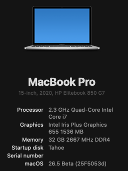

deeveedee Posted April 14 Share Posted April 14 Fast and easy incremental update from Tahoe 26.5 Beta 1 -> Beta 2. I'm using VoodooHDA.kext 3.3.4 with SIP csr-active-config = <01000000> for audio and itlwm/Heliport for Intel Wi-Fi, so no root patches and nothing to uninstall/re-install. 6 Link to comment https://www.insanelymac.com/forum/topic/362589-pre-release-macos-tahoe-265/page/4/#findComment-2849156 Share on other sites More sharing options...
deeveedee Posted April 14 Share Posted April 14 12 hours ago, hiphopboy said: the 26.5 beta 2 fixed grey screen and slow loading desktop on last build Time from login to desktop is MUCH faster on my HackBookPro16,2. Pleased to see that macOS Tahoe is still getting better for Intel platforms. 4 Link to comment https://www.insanelymac.com/forum/topic/362589-pre-release-macos-tahoe-265/page/4/#findComment-2849158 Share on other sites More sharing options...

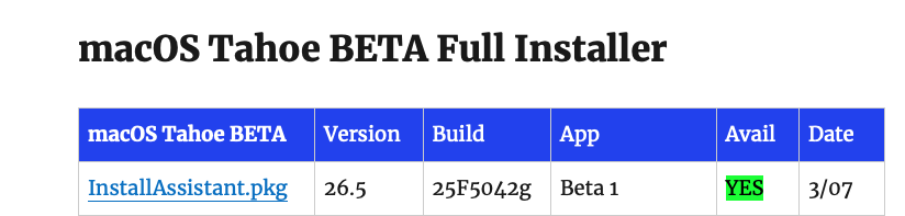

deeveedee Posted April 15 Share Posted April 15 (edited) @Max.1974 Isn't that 26.5 Beta 1? Edited April 15 by deeveedee 2 Link to comment https://www.insanelymac.com/forum/topic/362589-pre-release-macos-tahoe-265/page/4/#findComment-2849161 Share on other sites More sharing options...
Max.1974 Posted April 15 Share Posted April 15 (edited) 57 minutes ago, deeveedee said: @Max.1974 Isn't that 26.5 Beta 1? Yes, you’re right — sorry about that. I was referring to Beta 1, and the installer hasn’t been fully released yet. Now I will update beta 2 Sorry, my mistake Edited April 15 by Max.1974 4 Link to comment https://www.insanelymac.com/forum/topic/362589-pre-release-macos-tahoe-265/page/4/#findComment-2849165 Share on other sites More sharing options...

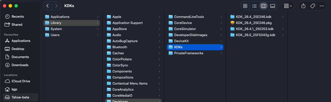

kgp Posted April 16 Share Posted April 16 (edited) Update: KDK behaviour on macOS 26.5 beta 2 After further testing, both OCLP 3.0.0 Nightly and OCLP-Mod 3.1.9 show identical behavior regarding KDK selection on macOS 26.5 beta 2 (build 25F5053d). Even with the following KDKs installed: Kernel Debug Kit 26.5.1 beta 1 (25F5042g) Kernel Debug Kit 26.4.1 (25E253) Kernel Debug Kit 26.4 (25E246) both patchers consistently fall back to: -> Kernel Debug Kit 26.4 (build 25E246) Removing 25E246 results in it being re-downloaded automatically, rather than switching to a newer available or installed KDK. Conclusion: This behaviour appears to be consistent across different OCLP implementations and suggests that 25E246 is currently the preferred or enforced fallback KDK for macOS 26.5 beta 2. Despite this, root patching works as expected with this KDK. Cheers, KGP Note: Feedback has been submitted to Apple regarding the KDK versioning inconsistency on macOS 26.5. Edited April 16 by kgp Adding Note 4 Link to comment https://www.insanelymac.com/forum/topic/362589-pre-release-macos-tahoe-265/page/4/#findComment-2849202 Share on other sites More sharing options...

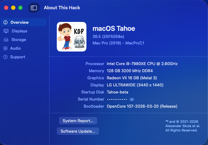

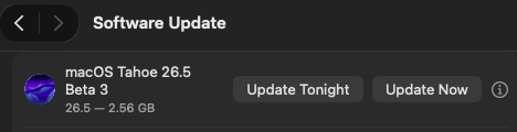

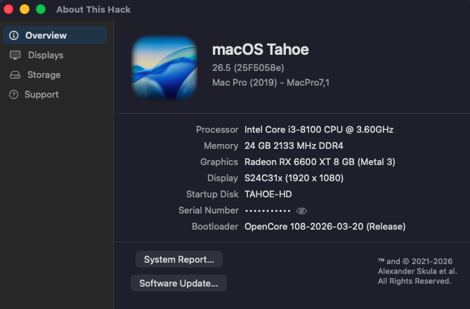

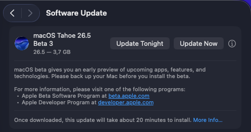

kgp Posted April 20 Share Posted April 20 (edited) Fast and painless sequential OTA update (3,7 GB) from macOS 26.5 beta 2 to macOS 26.5 beta 3 (25F5058e) There is no KDK for macOS 26.5 beta 3 (25F5058e) yet. Again, having manually installed on my system: KDK_26.4_25E246.kdk, KDK_26.4.1_25E253.kdk and KDK_26.5_25F5042g.kdk, OCLP chooses KDK_26.4_25E246.kdk as the closest match. AppleHDA, Wi-Fi and AWDL continue working flawlessly Edited April 20 by kgp 10 Link to comment https://www.insanelymac.com/forum/topic/362589-pre-release-macos-tahoe-265/page/4/#findComment-2849338 Share on other sites More sharing options...

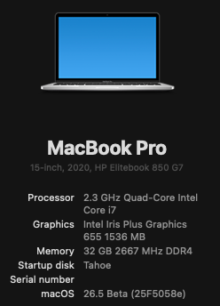

deeveedee Posted April 20 Share Posted April 20 (edited) Very easy update from Tahoe 26.5 Beta 2 -> Beta 3. Since I have BluetoolFixup.kext disabled, the unattended, incremental update was uneventful and fast. With VoodooHDA.kext 3.3.4 for audio and itlwm/Heliport for Intel Wi-Fi, there are no additional steps and everything appears to be working perfectly. Incremental Update Spoiler Edited April 20 by deeveedee 11 Link to comment https://www.insanelymac.com/forum/topic/362589-pre-release-macos-tahoe-265/page/4/#findComment-2849340 Share on other sites More sharing options...
