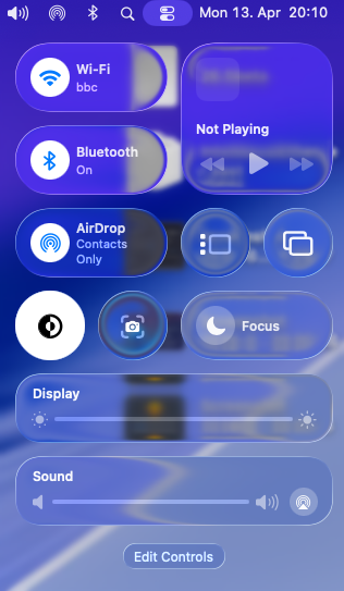

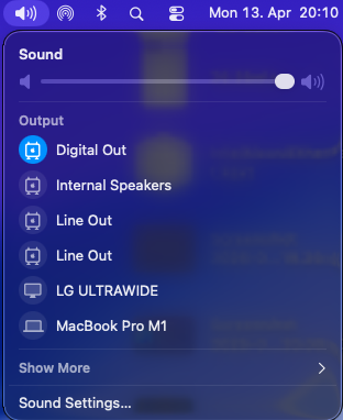

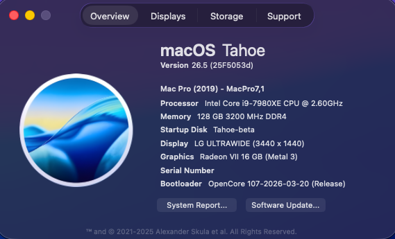

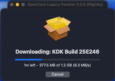

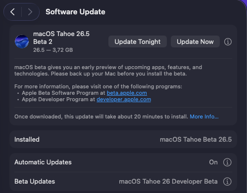

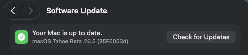

kgp Posted April 13 Share Posted April 13 (edited) Fast and painless sequential OTA update (3.72 GB) to macOS 26.5 Beta 2 (25F5053d) No KDK for macOS 26.5 beta 2 has been released by Apple yet. Surprisingly, OCLP 3.0.0 Nightly (amfipassbeta variant) selects KDK build 25E246 from macOS 26.4 as the closest match. Apparently, the KDK for macOS 26.4.1 is still missing in the Dortania KDKSupportPkg . The KDK for build 25F5042g (macOS 26.5 beta 1) is still available on Dortania. However, it is labeled as macOS 26.5.1, which follows Apple’s original naming and is not an issue introduced by Dortania. Due to this versioning, the patcher may not consider KDK 25F5042g a valid match for macOS 26.5 beta 2 (25F5053d), and instead falls back to macOS 26.4 (25E246) as the closest supported version. Even though KDK 25F5042g (macOS 26.5 beta 1) was already installed from the previous system state, OCLP does not consider it a valid match for macOS 26.5 beta 2 and instead falls back to KDK 26.4 (25E246). Nevertheless, modern audio and modern Wi-Fi, including AWDL, continue to work flawlessly. Edited April 15 by kgp 5 Link to comment https://www.insanelymac.com/forum/topic/362589-pre-release-macos-tahoe-265/page/3/#findComment-2849097 Share on other sites More sharing options...

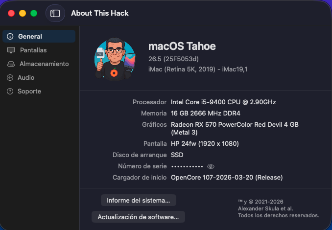

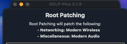

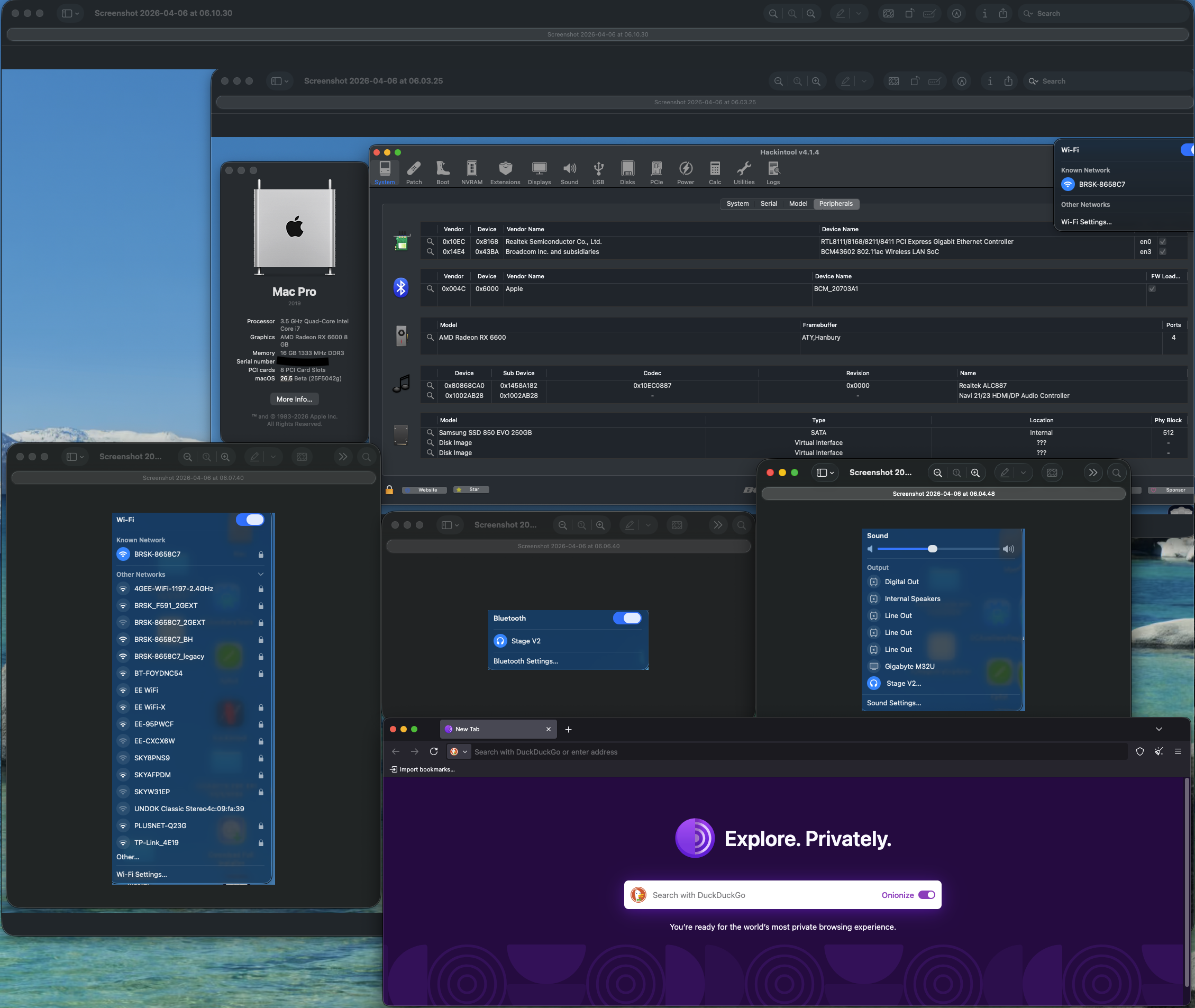

kaoskinkae Posted April 13 Share Posted April 13 perfect in NEW: 6 Link to comment https://www.insanelymac.com/forum/topic/362589-pre-release-macos-tahoe-265/page/3/#findComment-2849098 Share on other sites More sharing options...

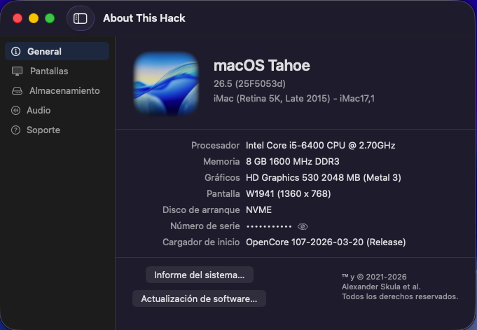

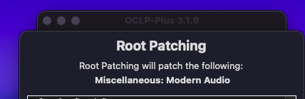

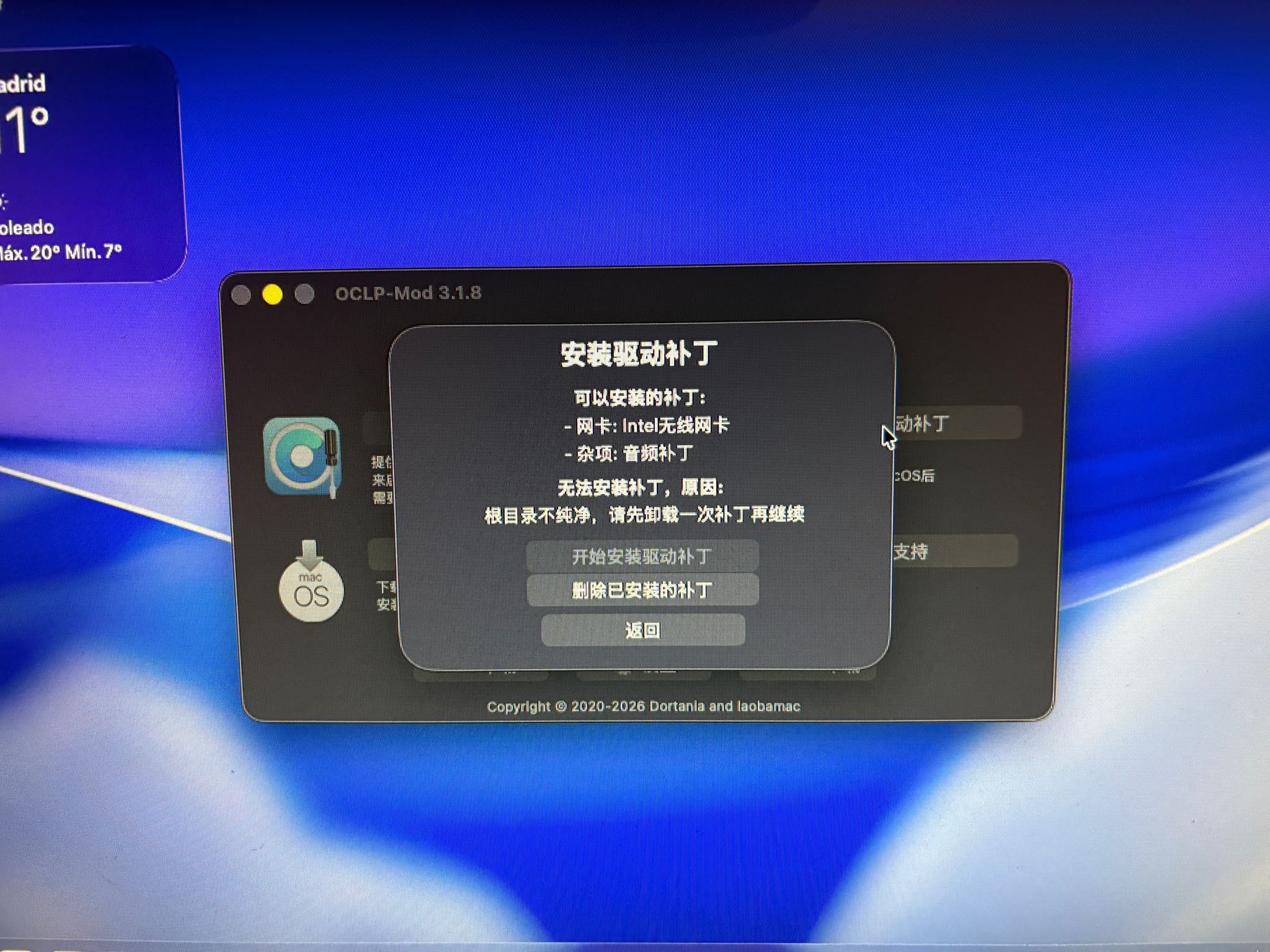

kaoskinkae Posted April 14 Share Posted April 14 Perfect in OLD2: with OCPL-Plus audio only; Intel Wi-Fi is impossible in Tahoe 1 Link to comment https://www.insanelymac.com/forum/topic/362589-pre-release-macos-tahoe-265/page/3/#findComment-2849124 Share on other sites More sharing options...
LockDown Posted April 14 Share Posted April 14 17 minutes ago, kaoskinkae said: Intel Wi-Fi is impossible in Tahoe Works here. I never tried '-Plus'. 2 Link to comment https://www.insanelymac.com/forum/topic/362589-pre-release-macos-tahoe-265/page/3/#findComment-2849126 Share on other sites More sharing options...
kaoskinkae Posted April 14 Share Posted April 14 (edited) 35 minutes ago, LockDown said: Aquí funciona. Nunca probé '-Plus'. https://github.com/5T33Z0/OCLP4Hackintosh/blob/main/Enable_Features/AirportItllwm_Sequoia.md https://github.com/laobamac/OCLP-Mod/releases https://github.com/YBronst/OCLP-Plus/releases In Tahoe, neither of the two guides on a desktop PC activates Wi-Fi to be patched. AirportItlwm_Sequoia.plist Edited April 14 by kaoskinkae 1 Link to comment https://www.insanelymac.com/forum/topic/362589-pre-release-macos-tahoe-265/page/3/#findComment-2849127 Share on other sites More sharing options...
kgp Posted April 14 Share Posted April 14 (edited) 40 minutes ago, kaoskinkae said: https://github.com/5T33Z0/OCLP4Hackintosh/blob/main/Enable_Features/AirportItllwm_Sequoia.md https://github.com/laobamac/OCLP-Mod/releases https://github.com/YBronst/OCLP-Plus/releases In Tahoe, neither of the two guides on a desktop PC activates Wi-Fi to be patched. AirportItlwm_Sequoia.plist 6.92 kB · 0 downloads As I already pointed out, please follow my Intel Wi-Fi guidelines: Also note that Broadcom spoofing is not universally applicable to all Intel Wi-Fi cards. This only works with newer Intel chipsets (e.g. AX200/AX210) that are compatible with the Modern Wi-Fi patch stack. Legacy Intel cards (such as 3165) are not supported and cannot be fixed via spoofing. So this strongly depends on the actual hardware in use on your system. Good luck, KGP Edited April 14 by kgp 3 Link to comment https://www.insanelymac.com/forum/topic/362589-pre-release-macos-tahoe-265/page/3/#findComment-2849129 Share on other sites More sharing options...
kaoskinkae Posted April 14 Share Posted April 14 3 minutes ago, kgp said: As I already pointed out, please follow my Intel Wi-Fi guidelines: Also note that Broadcom spoofing is not universally applicable to all Intel Wi-Fi cards. This only works with newer Intel chipsets (e.g. AX200/AX210) that are compatible with the Modern Wi-Fi patch stack. Legacy Intel cards (such as 3165/7265) are not supported and cannot be fixed via spoofing. So this strongly depends on the actual hardware in use on your system. Good luck, KGP Thanks for the clarification. That's why my profile shows the three computers: New, Old1, and Old2 with the Wireless 3165. Therefore, I now know it's impossible and I'll continue using Heliport, which works perfectly. I'm closing this thread and have learned from your explanation. 2 Link to comment https://www.insanelymac.com/forum/topic/362589-pre-release-macos-tahoe-265/page/3/#findComment-2849130 Share on other sites More sharing options...
