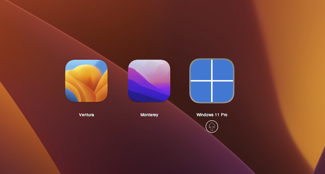

miliuco Posted November 6, 2022 Share Posted November 6, 2022 (edited) @stagtrader @loganMac I guess that, if you don't pick EFI partitions in ScanPolicy, Windows is not automatically detected. And EFI partitions of the non booting macOS disks always are shown even when EFI systems are not marked in ScanPolicy. There are instructions about how to boot Windows by a custom entry instead of automatically detected by OC, it's a medium complicated task. https://www.insanelymac.com/forum/topic/348097-how-to-custom-entry-in-opencore-to-boot-windows/ Edited December 21, 2022 by miliuco 1 Link to comment https://www.insanelymac.com/forum/topic/354633-help-with-ventura/page/2/#findComment-2796777 Share on other sites More sharing options...
loganMac Posted December 21, 2022 Author Share Posted December 21, 2022 (edited) Now OC boot menu show 3 SSD ScanPolicy = 2687747 Then follow this guide to get Windows EFI Path <key>Entries</key> <array> <dict> <key>Arguments</key> <string></string> <key>Auxiliary</key> <false/> <key>Comment</key> <string>Windows 11 Pro</string> <key>Enabled</key> <true/> <key>Flavour</key> <string>Windows11 Pro:Windows</string> <key>Name</key> <string>Windows 11 Pro</string> <key>Path</key> <string>Your Windows EFI path/\EFI\BOOT\BOOTX64.EFI </string> <key>TextMode</key> <false/> </dict> </array> Edited December 21, 2022 by loganMac 2 Link to comment https://www.insanelymac.com/forum/topic/354633-help-with-ventura/page/2/#findComment-2799087 Share on other sites More sharing options...

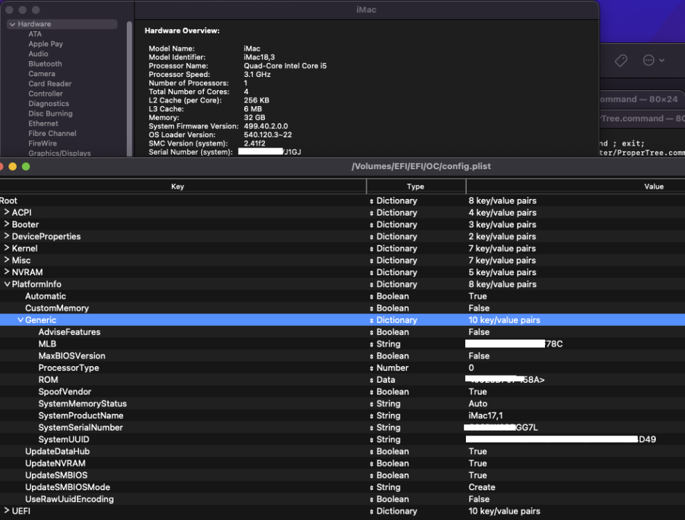

loganMac Posted December 23, 2022 Author Share Posted December 23, 2022 (edited) @miliuco Would you know why About This Mac info is different from my config.plist? I have it to iMac17,1 in config but About This Mac show as 18,3. Seem like it picking up from my other SSD for MacOS 13.1 which I have as 18,3? edit: I meant to say this SSD is only dedicated for 12.6.2. Use iMac 17,1 so it won’t show update for MacOS13 Edited December 23, 2022 by loganMac Link to comment https://www.insanelymac.com/forum/topic/354633-help-with-ventura/page/2/#findComment-2799177 Share on other sites More sharing options...
Slice Posted December 23, 2022 Share Posted December 23, 2022 4 hours ago, loganMac said: @miliuco Would you know why About This Mac info is different from my config.plist? I have it to iMac17,1 in config but About This Mac show as 18,3. Seem like it picking up from my other SSD for MacOS 13.1 which I have as 18,3? iMac17,1 is not compatible with MacOS 13.1 Link to comment https://www.insanelymac.com/forum/topic/354633-help-with-ventura/page/2/#findComment-2799185 Share on other sites More sharing options...
loganMac Posted December 23, 2022 Author Share Posted December 23, 2022 (edited) @Slice I meant to say this SSD is only dedicated for 12.6.2. I Use iMac 17,1 so it won’t show update for MacOS13. However, my config plist show different from About This Mac as you see in previous post. it is because it confused with my 2nd SSD? My 2nd SSD is setup for iMac18,3. hope I made it clear to understand my issue. my config is set to 17,1 but About This Mac show 18,3. Edited December 23, 2022 by loganMac Link to comment https://www.insanelymac.com/forum/topic/354633-help-with-ventura/page/2/#findComment-2799200 Share on other sites More sharing options...
miliuco Posted December 23, 2022 Share Posted December 23, 2022 @loganMac It's strange. It can happen if you inadvertently boot from the EFI of the disk that has 18.3 SMBIOS instead of booting from the EFI with 17.1. As @Slice says, 17.1 is not supported by Ventura so it can't boot from that EFI. Maybe it detects the EFI with 18.3 as the only valid EFI for Ventura and boots from there. Link to comment https://www.insanelymac.com/forum/topic/354633-help-with-ventura/page/2/#findComment-2799203 Share on other sites More sharing options...
loganMac Posted December 23, 2022 Author Share Posted December 23, 2022 “Maybe it detects the EFI with 18.3 as the only valid EFI for Ventura and boots from there.” I guess you’re right because if I boot from Monterey, and on OC boot menu, if I select Ventura it will cause panic. I had to boot from Ventura, at this point, I can select any OS. 1 Link to comment https://www.insanelymac.com/forum/topic/354633-help-with-ventura/page/2/#findComment-2799205 Share on other sites More sharing options...
