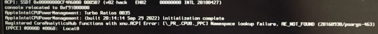

Failed boot (verbose output interrupted when printing "AppleACPICPU: Process Id=6 LocalApic Id=5 Disabled" and instead prints "AppleACPICPU: Process Id=6 Loconsole relocated to 0xf91000000"
Is this "Failed boot" appeared after OCLP root patch? If yes, I had same issue yesterday on my core2 quad rig. I changed boot arg, in windows, from amfi=0x80 to amfi_get_out_of_my_way=1 and it booted without problems. Funny is that, after I updated OC, LegacyBoot and LogoutHook and deleted NVRAM folder from EFI, I reverted to amfi=0x80 and I had no problems booting.
Also, at the beginning I had a lot of problems making core2 rigs booting. Until I found the boot quirks working for me. Maybe you should give a try. Take a look at kernel patches too (MaxKernel).
At the second thought, I suspect NVRAM (emulated NVRAM) variables conflict between different OS's boots. Just my two cents!

@Stefanalmare Thank you.  I will review your suggestions and experiment with different boot args.  Note that I do reset NVRAM when switching between OS versions.  I'm not certain, but I think the Monterey boot failure is more likely to happen after I first reset NVRAM.  It seems to me that the boot problem happens less frequently if I'm booting Monterey after emulated NVRAM is already populated by LogoutHook (from a previous boot of Monterey).
The best solution for me right now is to run Big Sur, because it boots flawlessly.

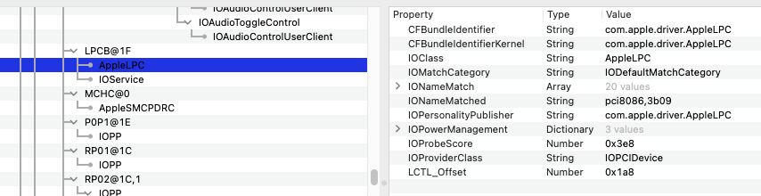

Today, I have been using this Dell Latitude E6410 (booting Big Sur) to perform tasks that included Safari, Xcode, Microsoft Word, VNC Viewer and Microsoft Remote Desktop.  I have been running for 3 hours on battery and have 17% remaining.  I'm pleasantly surprised by the battery life of this old laptop.  Notice that my Big Sur EFI does not include any additional power management kexts and is still utilizing native macOS power management.  The only power management patch that I have implemented (same that I have implemented since first creating this solution for Mojave here) is to spoof an Apple compatible LPCB for the MacBookPro6,2 (see my SSDT-LPCB).  Note that I'm not spoofing a newer macOS model.  The fan on this laptop rarely runs and when it does, it runs low.

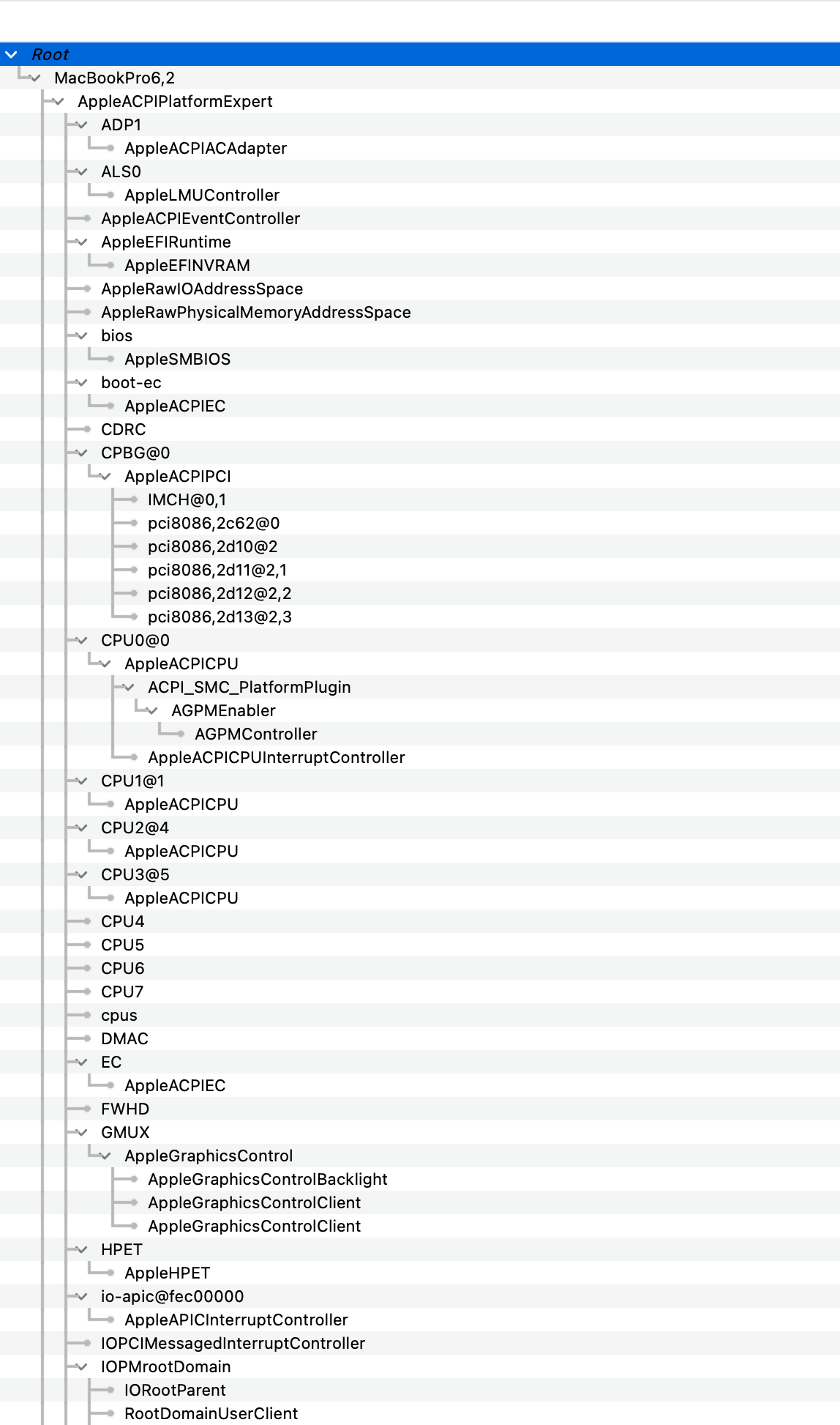

LPCB IORegistry
Spoiler
Edited by deeveedee

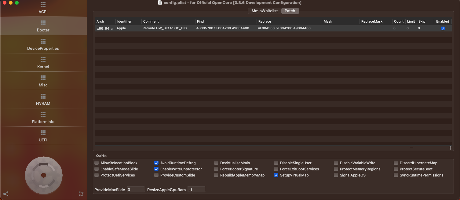

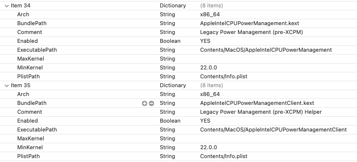

I upgraded to the current Beta version of OC0.8.6 (and the kexts that are scheduled to be released with OC0.8.6).  Big Sur continues to boot without issues and the intermittent Monterey boot issue remains (no change in boot behavior).  One interesting change that I can't explain is that I was unable to run Hackintool 3.8.7 in Monterey (never had any problems with Hackintool on other platforms).  Hackintool ran fine in Big Sur but not Monterey on this HackBookPro6,2.  After upgrading to OC0.8.6 (which included a reinstall of the LogoutHook), Hackintool launches and runs without issues in both Monterey and Big Sur.
When I upgraded to OC0.8.6 Beta, I uninstalled LogoutHook before installing the OC0.8.6 version with the following commands:
// Unload and remove old LogoutHook
sudo launchctl unload /Library/LaunchDaemons/org.acidanthera.nvramhook.daemon.plist
sudo rm /Library/LaunchDaemons/org.acidanthera.nvramhook.daemon.plist
// Load new LogoutHook
Utilities/LogoutHook/Launchd.command install
Edited by deeveedee

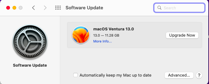

This is awesome.  I'm being prompted to upgrade to Ventura on my HackBookPro6,2.  I won't be upgrading until OCLP officially supports Ventura on the MacBookPro6,2, but it is incredible.
Upgrade to Ventura
Spoiler
EDIT: If I've given the impression that this old HackBookPro doesn't have any limitations, it's close to perfect, but it does have limitations.  I have found that iMovie downloads and installs from the App Store, but iMovie crashes shortly after startup.  I don't think this should be a surprise.  iMovie runs well on this HackBookPro6,2 with High Sierra.
Edited by deeveedee

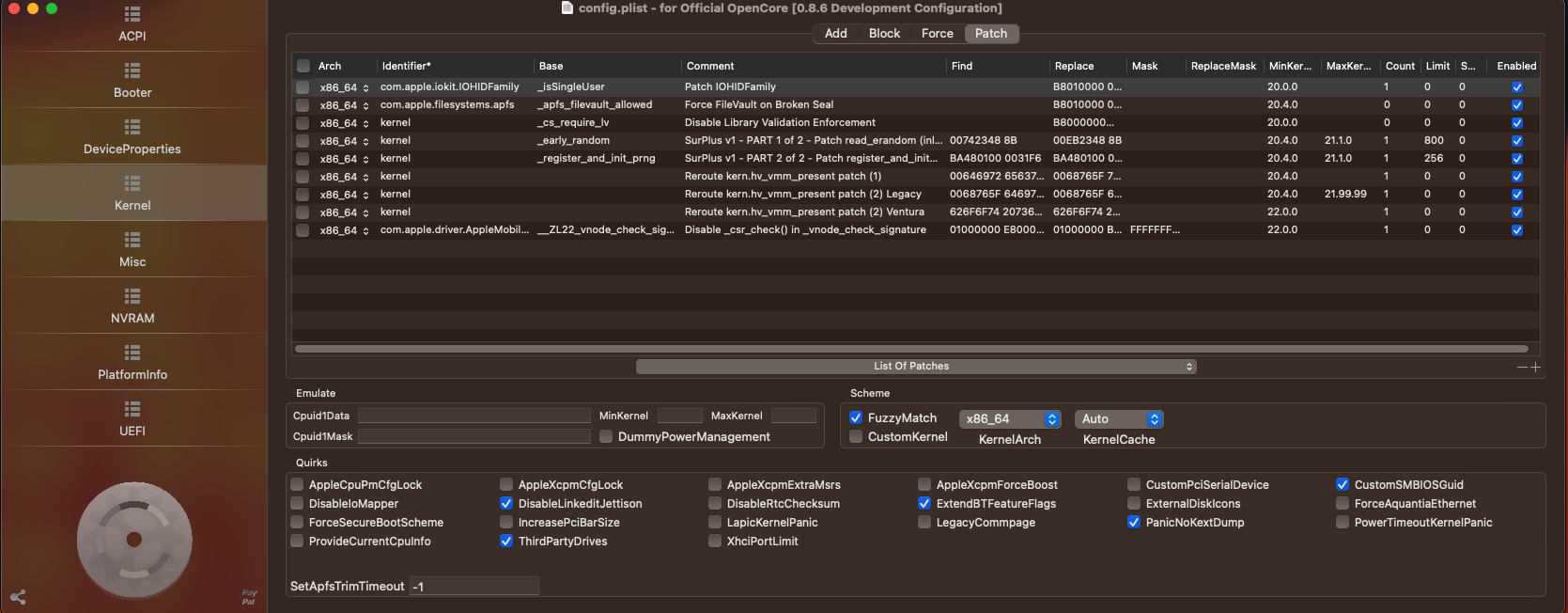

Thanks, everyone, for the suggestions for fixing Monterey boot.  I have tried your suggestions and other things that I can think of, but am still not able to resolve the intermittent Monterey boot failure.  Big Sur is booting flawlessly with the same EFI.  Below is a screenshot of a normal Monterey verbose boot log showing the "console relocated..." line which is the last printed line before Monterey boot fails (if it fails).  The next line in the verbose log (AppleIntelCPUPowerManagement: Turbo Ratios...) (which does not print when Monterey boot fails) is where the boot may fail and cause an automatic reboot.  It's been a while since I diagnosed boot issues on legacy hardware, but this feels like a problem similar to TSCSync.  I did try TSCSync.kext, but it didn't work and I may have incorrectly implemented the kext (CPU is 2 core / 4 thread).  I'm not sure why TSCSync (if that is the problem) would happen in Monterey but not Big Sur.
I'm still open to suggestions.  Once booted, Monterey works fine.  This problem (when it occurs) is only during Monterey boot.
Spoiler
Edited by deeveedee
The intermittent Monterey boot issue is solved by replacing VirtualSMC.kext with FakeSMC.kext or add boot-arg vsmcgen=1 for VirtualSMC.  Leaving the post below for historical purposes.

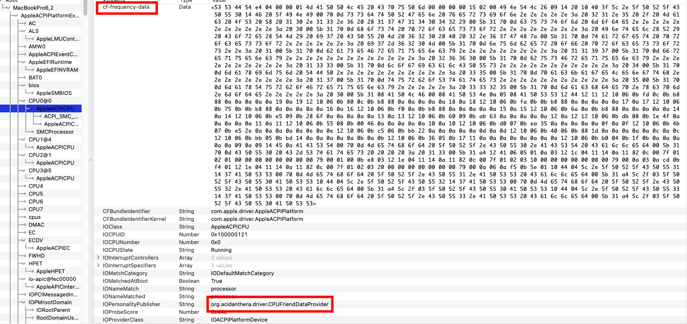

Since CPUFriend did not fix the Monterey boot issue, I wanted to make sure that CPUFriend.kext and CPUFriendDataProvider.kext are loading correctly. I confirmed in IORegistry:
Spoiler
1697723648_ScreenShot2022-11-05at8_51_01PM.thumb.png.10ab0be688149c7fc64bc65646ceeaaf.png
and I confirmed with AppleIntelInfo.kext
CPU Ratio Info:
Base Clock Frequency (BLCK)............. : 133 MHz
Maximum Efficiency Ratio/Frequency.......:  9 (1197 MHz)
Maximum non-Turbo Ratio/Frequency........: 20 (2660 MHz)
Maximum Turbo Ratio/Frequency............: 25 (3325 MHz)
P-State ratio * 133 = Frequency in MHz
Edited by deeveedee
CPUFriend.kext injects CPU frequencies.  The Nvidia dGPU on the I7-620M also has a turbo mode.  Is it possible that the Monterey boot problem is caused by the dGPU turbo mode and not the CPU turbo mode?  If so, is it possible to inject dGPU frequencies?
Do you use ASPP-Override.kext? Have you tried booting Clover?
After seeing your ioreg, I'm pretty sure CPUfriend is not a solution for you. It is working just if X86PlatformPlugin is on. So, the PowerManagement is different for Arrandale. See attach.

I have attached also genuine MacBookPro6,2 ioreg. Take a look.
For genuine PowerManagement I'll try ASPP-Override.kext with AppleIntelCPUPowerManagement.kext and AppleIntelCPUPowerManagementClient.kext.
If you'll have under CPU, ACPI_SMC_PlatformPlugin, AGPMEnabler, AGPMController and under NVDA, AGPM, gpu-control, you're done. It is max you can achieve for PowerManagement.

@Stefanalmare Thank you again for your continued assistance.  My config.plist currently includes the following two Kernel > Add entries (with minKernel = 22.0.0) (copied from the EFI generated by OCLP).  If I change minKernel to 21.0.0 (Monterey), attempting to boot Monterey results in a kernel panic.  In order to boot Monterey, I can't load these AppleIntelCPUPowerManagement kexts.
config.plist Kernel >Add AppleIntelCPUPowerManagement
Spoiler
When booting Monterey, my IORegistryExplorer shows the following for my CPU and Graphics PM (without any CPU Power Management kexts and without CPUFriend.kext).  I am injecting ASPP-Override.kext with minKernel = 21.4.0 (copied from the OCLP-generated EFI).
Spoiler
When I was originally creating the solution for the Dell Latitude E6410, I did reference the ACPI and IOReg from a real MacBookPro6,2.  You should notice some elements of my ACPI patching for this hack that were taken from a real MacBookPro6,2 (e.g., SLPB).
I am currently running with the attached ssdt (generated by ssdtPRGen as you had suggested earlier) and I think my laptop runs better with the CPU PM ssdt.  The ssdt-PM doesn't fix the Monterey boot problem, so it still remains that the only way I have found to fix the Monterey boot problem is to disable CPU TurboBoost in BIOS.  This Monterey boot problem seems similar to what I remember when trying to debug TscSync.  This comment in Acidanthera's CpuTscSync ReadMe is interesting: WARNING: CPUs without MSR_IA32_TSC_ADJUST (03Bh) are currently unsupported on macOS 12 and newer.
Thanks again for your help!
ssdt-MyCpuPm.aml
