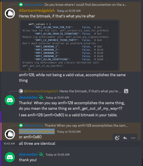

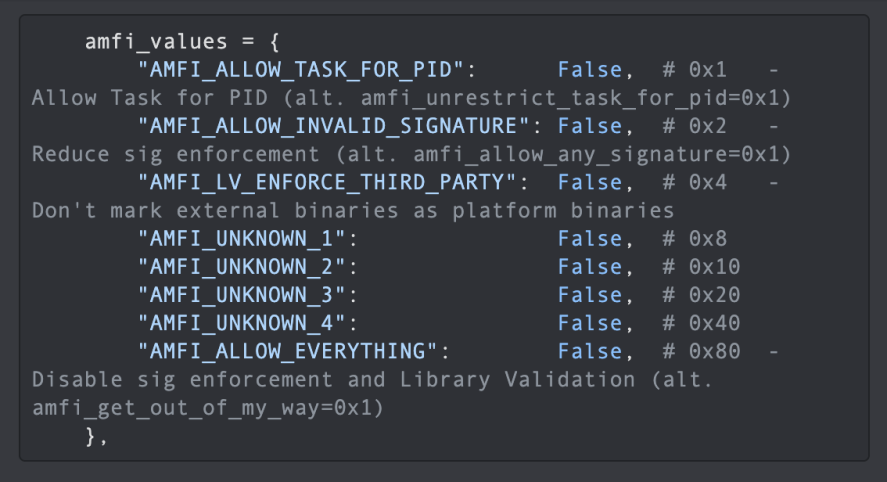

I spoke with ASentientHedgebleh on Discord Server.  amfi_get_out_of_my_way=1 and amfi=0x80 are identical.  They can be used interchangeably with no difference.  The amfi bit mask is below.  I'll leave my boot-arg as amfi=0x80, but we can also use amfi_get_out_of_my_way=1 without any changes in security.
amfi bit mask
Spoiler
Here's the full discussion
Spoiler
EDIT: Now realizing that I should have been able to find this myself.  I searched the OCLP 0.6.1 source and found the amfi definitions in data/amfi_data.py.

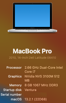

I still can't get over how incredible this is...  I'm using a 2010 Dell laptop that is perfectly running macOS Monterey and I'm being prompted to upgrade to Ventura.

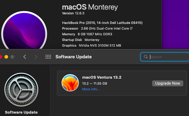

I upgraded this hack to OC0.8.9.  OC0.8.9 fixes the LegacyBoot bug that prevented OC0.8.8 LegacyBoot from loading HfsPlusLegacy.efi.  At the time of this post, my posted EFIs are still using OC0.8.8.  I will upgrade my posted EFIs to OC0.8.9 when OCLP 0.6.2 is released.
Also, in Monterey 12.6.3, I was prompted to install a Safari upgrade (Version 16.3 (17614.4.6.11.6, 17614)).  After applying the Safari upgrade in Monterey, I could not login to InsanelyMac.  After re-applying OCLP 0.6.1 post-install patches, I can login to InsanelyMac with the latest Safari.  Note that OCLP did not prompt me to apply the post-install patches after the Safari upgrade.
EDIT: The Ventura 13.2.1 upgrade proceeded without any issues - very smooth!  Currently booting macOS with OC0.8.9 and patching with OCLP 0.6.1.
EDIT2: After upgrading Safari in Big Sur 11.7.3, I did not have the website issues that I experienced in Monterey 12.6.3.  I did not need to re-apply OCLP 0.6.1 post-install patches in Big Sur after upgrading Safari.
About This Hack: Ventura 13.2.1

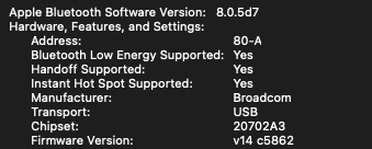

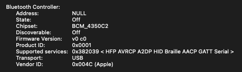

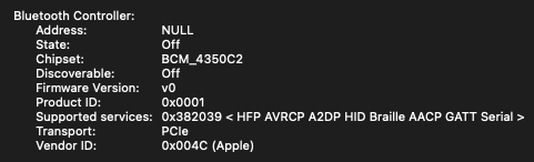

This Monterey/Ventura Bluetooth issue has been documented in other threads and issues (including here).  I'm capturing the issue here since it's relevant to this hack and is currently one of my unresolved issues for Monterey and Ventura.  Note that I do not want to change my hack's SMBIOS MacModel, even though that is a possible fix for this.
My BCM 94352HMB Wi-Fi/BlueTooth card works perfectly in Big Sur.  In Monterey and Ventura, Wi-Fi works without issues, but I am unable to turn-on BlueTooth.  Inspection of the System Report reveals that, in Big Sur, the BlueTooth device is detected on Transport USB.  In Monterey and Ventura, the BlueTooth device is detected on Transport PCIe.  My webcam works and is on a USB hub just like BlueTooth, so I'm fairly confident that my USB mapping is correct.
Big Sur BlueTooth Transport (BCM 94352HMB): USB
Spoiler
Monterey/Ventura BlueTooth Transport (BCM 94352HMB) : PCIe
Spoiler
I have unsuccessfully experimented with different combinations of enabling/disabling BluetoolFixup.kext, BluetoothSpoof.txt and BluetoothInjector.kext.  I have tried 'sudo killall -9 BlueTool bluetoothd' and 'sudo pkill bluetoothd'.  I have tried adding DeviceProperty pci-aspm-default = 0.
EDIT: On my HackBookPro15,2 with BCM94360NG, BlueTooth Transport is USB in Monterey and Ventura
Monterey/Ventura BlueTooth Transport (BCM94360NG):
Spoiler
Edited by deeveedee
