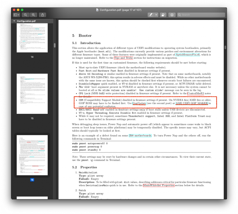

hardcorehenry Posted February 3, 2022 Share Posted February 3, 2022 (edited) 16 hours ago, Martin Dobson said: it doesn't like CSM being disabled Troubles booting when CSM disabled might indicate your AMD HD7xxx doesn’t have UEFI vbios. Check in Windows with GPU-Z. In case you don’t have UEFI vbios see OpenCore Configuration.pdf. There is section 5.Booter and two links that might help resole your issue. Spoiler Edited February 3, 2022 by hardcorehenry Link to comment Share on other sites More sharing options...
