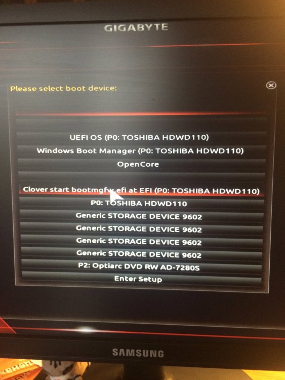

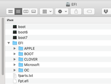

Slice Posted February 1, 2022 Share Posted February 1, 2022 2 hours ago, haegar33 said: When I merge Clover and OC inside the EFI folder as proposed by @Slice how do I select the bootloader? This way? There are five bootloaders: UEFI OS: - there is /EFI/BOOT/BOOTX64.EFI Windows Boot Manager: - /EFI/Microsoft/boot/bootmgfw.efi OpenCore: - /EFI/OC/OpenCore.efi Clover... : - /EFI/CLOVER/CloverX64.efi P0: Toshiba... : - this is legacy boot by MBR bootsector. In my case there will be legacy Clover. Link to comment https://www.insanelymac.com/forum/topic/350631-switching-from-clover-to-opencore-not-working-at-all/#findComment-2776068 Share on other sites More sharing options...
