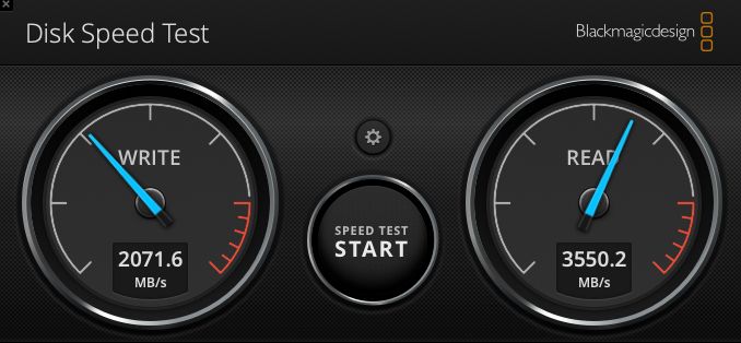

gotjoshua Posted January 10, 2021 Author Share Posted January 10, 2021 13 hours ago, miliuco said: The ADWITS Quad M.2 PCIe Adapter with ASM2824 chip is well recognized by macOS? Does it work well? So far so good. Only weird thing is that it doesn't show up after osx restart, so I always do a full shutdown and reboot. I will eventually get around to doing some more in depth performance profiling, but for now i attached the zfs raid 10 results 2 GB/s write and 3.5 GB/s read. It was a bit higher with Mac OSX software raid 0, and I still want to try the unrecommended zfs raid 0 and maybe also xfs raid 0 to compare. The Adwits only uses a 8x PCIe 3.0 connection (even though I have it plugged into a 16x slot)... so theoretical max bandwidth should be nearly 8 GB/s. 1 Quote Link to comment Share on other sites More sharing options...
